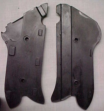

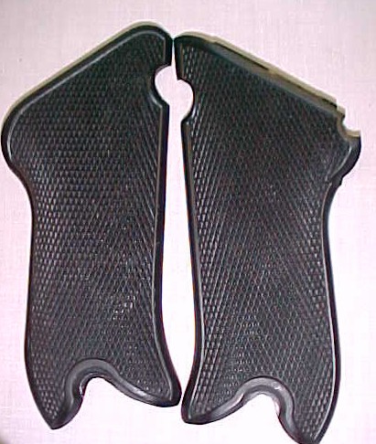

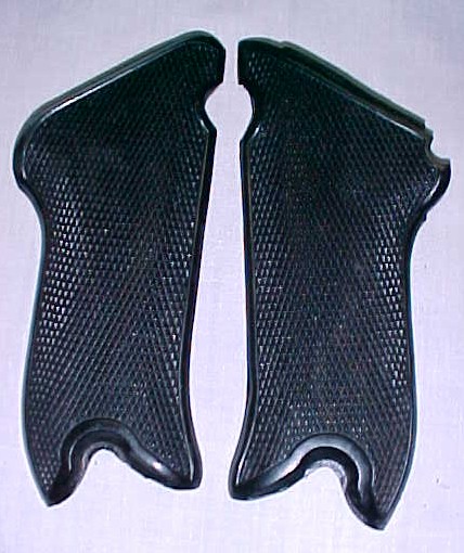

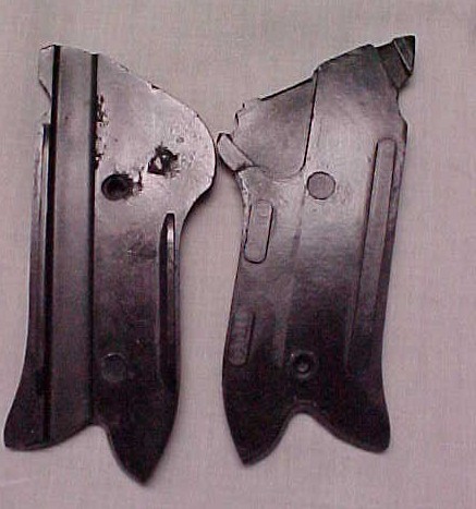

Greetings Guys,
I recently posted a picture of my newly-acquired "Black Widow" on another thread entitled "Is this a Black Widow". Super Moderator & Super Gentleman John Sabato wrote me stating that he had studied my picture very carefully and noticed the grips on my Luger did not look exactly right. He was somewhat fearful that they may be aftermarket grips. Well, I have the very unique opportunity to say that I know the person who, in this case did not actually capture this Luger, but was handed this Luger by the spouse of the German office who carried it. I am not at liberty to say much more, but from that, I know the grips are not US made or current production. So next thought. Could they be Kreighoff grips according to Mr. Sabato? That is my question to the forum. Could two happy krauts on a Saturday night, one infantryman and one flyboy have decided to swap their grips? Who knows? But if they are modern replacement grips, lay it on me, and there goes my friend's story about his meeting the German officers in the jungles of South America. Here is an afterthought: I am including two more pictures of what I believe to be legit "Black Widow" grips for comparison. If these are not the real thing either, please let me know. The real ones are the last two pictures.

My original ones are made with black charcoal material. New ones seems to be made of "softer" material.

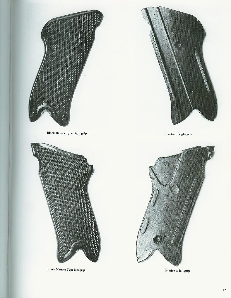

Hi Mike B.,
In R. Gibson's HK book on page 47, he has photo'd some black grips which he names "Black Mauser Type".
They appear very similar to your photos, but the top-most island on the inside, left side grip of your pair is not as long in shape as the pair Gibson has displayed.
Here is the photo scan from the Gibson book; in case you do not have the book :

Pete, these photos from Gibsons book identify the true BW type grips... that is what caused me to think that the grips on this particular byf 41 were wrong...
Notice how thick the border line is around the grips being questioned and how fine the border line is around the grips in the Gibson book. The difference in the size and placement, and shape of the positioning islands makes me believe that these are either KH grips, or modern reproductions on Mike's Luger. What we need is for someone to post the photos of both sides of the variations of KH grips to determine this...
