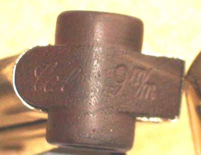

I think the magazine bottom photographs were added later and show "Cal 9mm" stampings, which combined with concentric circles, make the magazine from a commercial Navy luger, a rarity in its own right and certainly worth more than just a "common" Cal 9mm stamped plain bottom magazine!

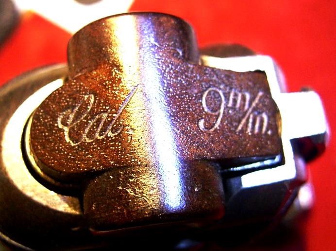

I would worry some about the magazine with this FB...it does not look quite right.
Here is that photo and two others from the Navy Cabal guys posted in the past :

I agree, Pete. There are many "repro" Cal 9mm magazines out there but This would be the first with concentric rgings that I have seen. Still an easy task to perform for WaffenfabrikUSA.

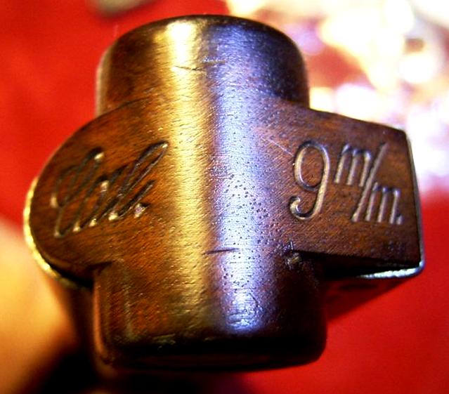

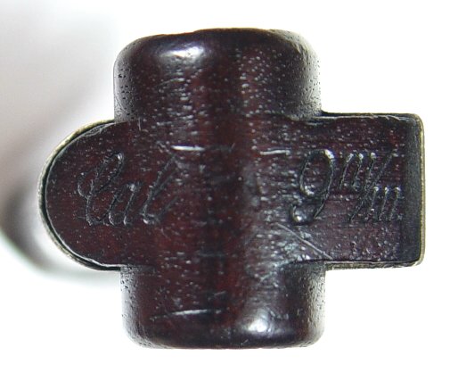

Here is another photo that shows a good magazine :

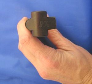

And the repro junk sold as original on e-Bay :
