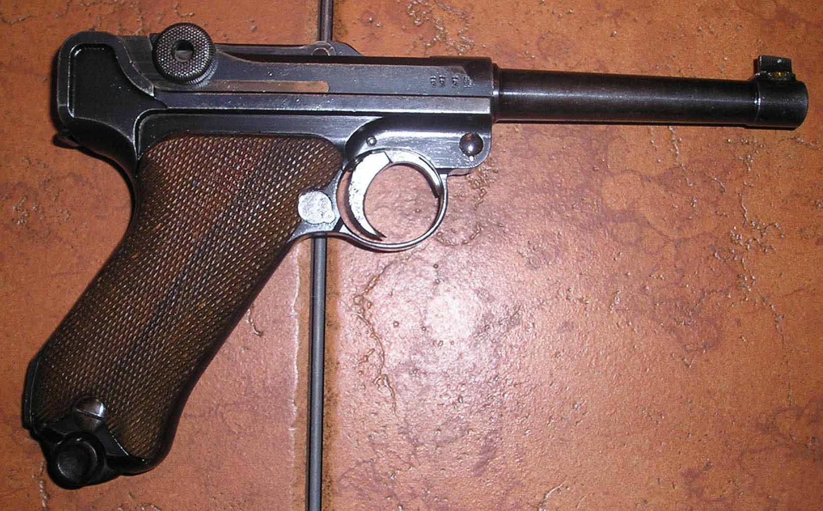

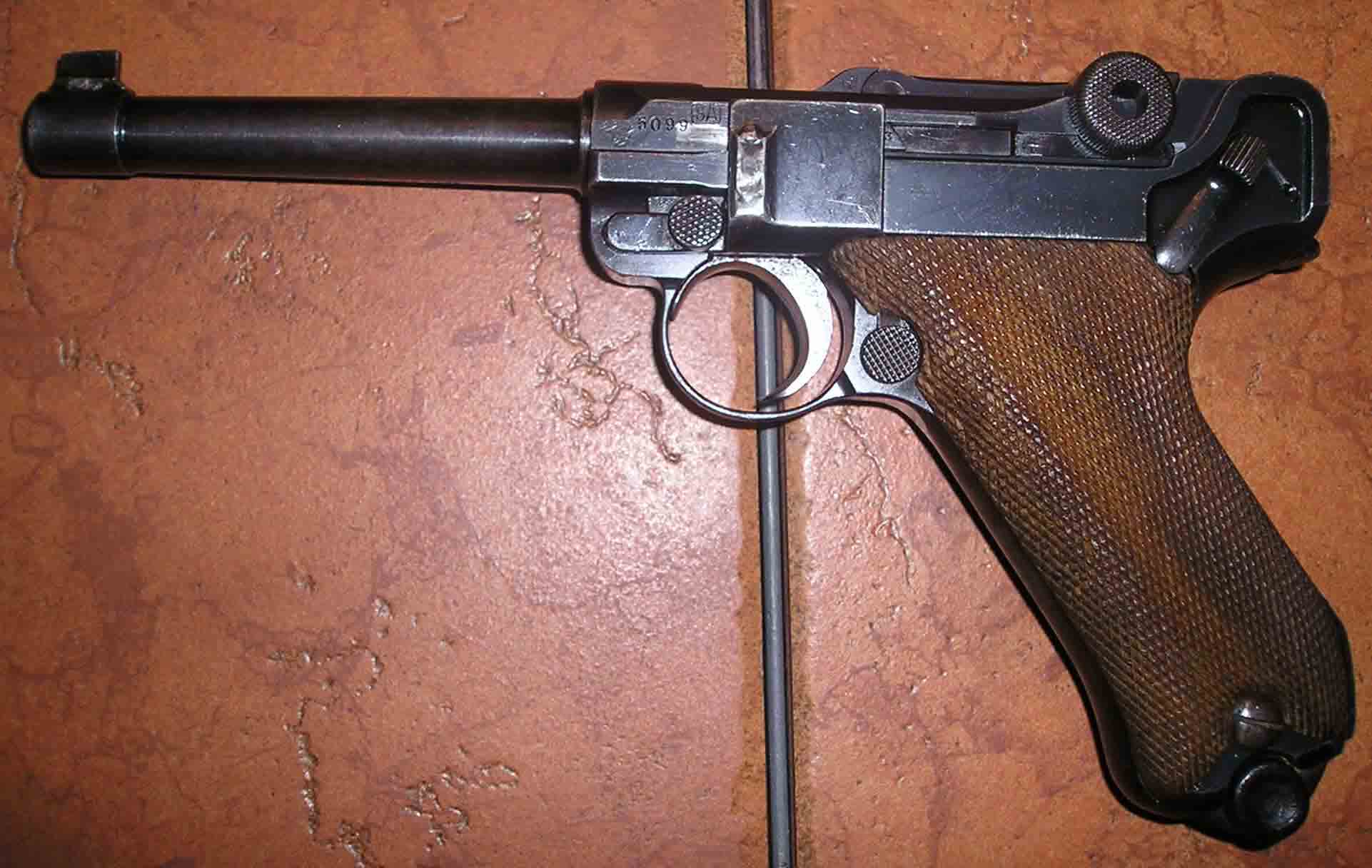

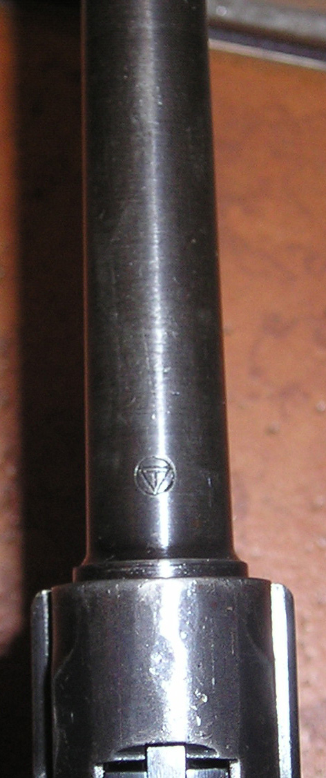

I recently purchased a DWM Model 1914 Luger that is SA-marked and has a replacement 120mm Tikkakoski barrel. I am curious to know how common or uncommon is this Finnish Luger "variant" compared to the recently imported Finnish m/23 and M.08 pistols? Also, can anyone point me in the direction of websites where I may learn more about the history of these particular Finnish Lugers?

After some digging and web-surfing I now am wondering whether this pistol might have been returned to Finland by "a Finnish volunteer that had travelled to Germany in 1915 - 1916 had received German military training and had been battle-hardened as "Prussian Jaeger Battalion 27" in battles of eastern front". If this is the case then I suspect these WWI Lugers pressed into service during the Winter and Continuation Wars are quite rare. It really is amazing to think of the number of wars this pistol has been used in and survived!!!

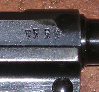

I had another question for you marking aficiodanos. I was curious why this DWM 1914 Luger sports three of the same stamps next to the Imperial Eagle . According to the markings listed for this model under Technical Information there should be one mark that looks like a "Crown over a C" and then two that look like a "Crown over a S".

Tim,
The Imperial right-reciever markings shown in the Technical Information drawing are examples only.
The c/letter stamps certify passage of various inspection benchmarks, and represent indivisual inspectors. The leftmost stamp certifies proper hardening of the reciever and application of the chamber date; the middle stamp certifies completion of the pistol; and the last stamp certifies shooting-in and final acceptance.
The stamps themselves are the hallmarks of individual Army Inspectors. Each inspector (there were many) was assigned a stamp comprised of an Imperial crown surmounting the first letter of their last name. The right-reciever stamps can thus be combinations of many different stamps, depending on which inspector happened to be assigned to the factory at any given time, and happened to inspect the particular gun.
