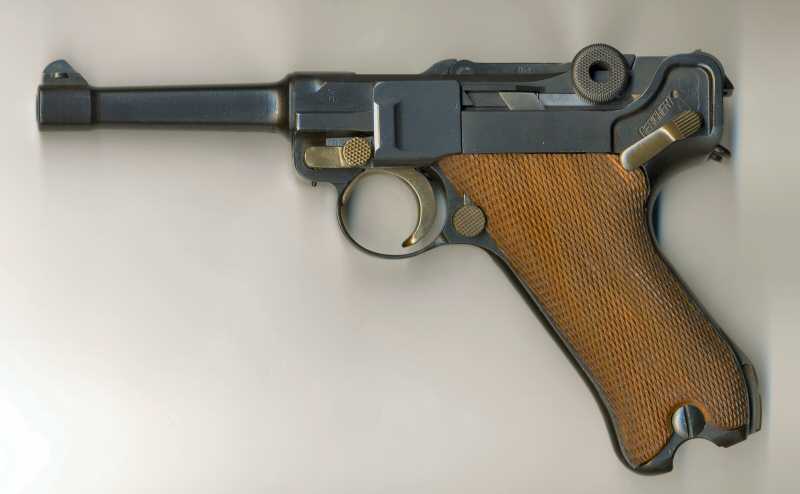

I've been learning various finish techniques - rust blueing, temper bluieing and strawing.
I had a 1923 DWM Commercial that had been previously hot blued sometime in it's past, and all parts were blued. So I decided to experiment with strawing.
Dug around the web for information, but probably the most concise instructions for the DIY'er came from PoliceLuger on this forum - much appreciated!
This attempt came out slightly darker than I wanted, almost golden brown. I may re-do it later. I found it is difficult to see just when to remove the heat. Just having instructions on paper isn't enough, it still takes skill and practice.
-- Dan

A pic

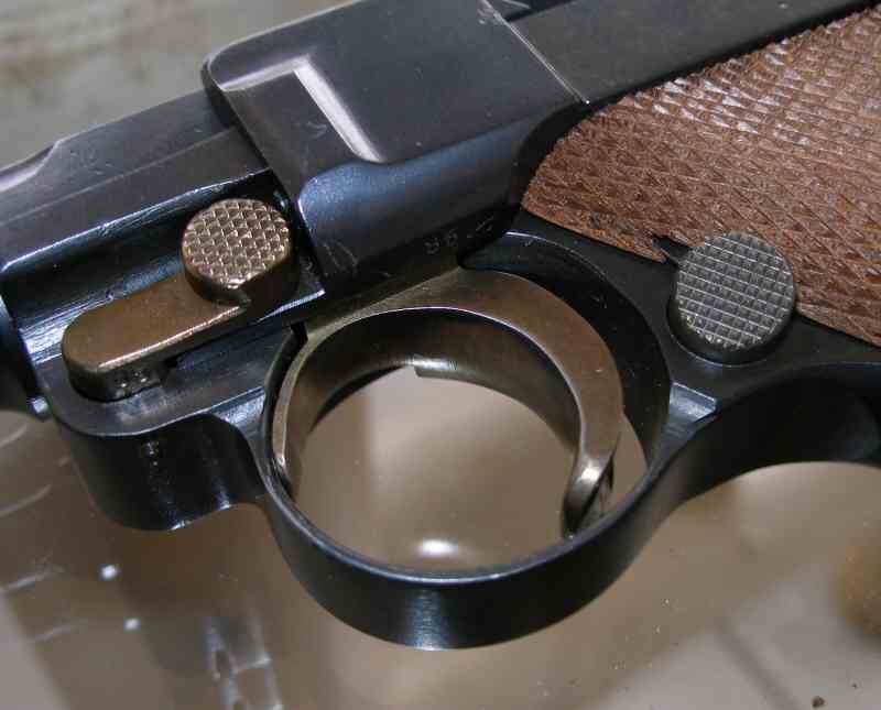

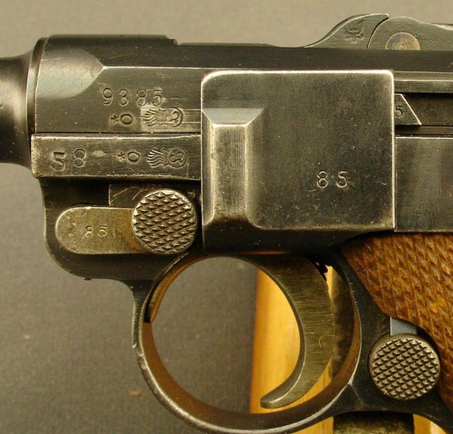

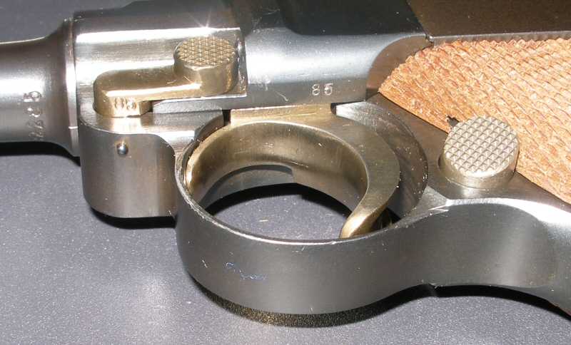

In looking at various photographs of Lugers, I think the darkness of the checkered areas is partly due to the strawing process and partly due to lighting.
When I look at original finish Lugers, the strawed parts usually appear completely strawed though the checkered areas appear darker, especially the mag release.
A lot of this is due to the lighting and photography. I offer three examples, the first from Joe Salter, the second is my Luger in natural light with a bright background, and the third is my Luger again on a dark background with a flash.
In the right lighting my mag release looks almost black. With the flash on a dark background it looks bright gold.

Unread 02-14-2006, 02:40 PM   #10
Revolvr
Revolvr's Avatar
Join Date: Jul 2004
Location: Phoenix AZ
Posts: 86
Now on a dark background close up with a flash.

Unread 02-14-2006, 02:41 PM   #11
Revolvr
Revolvr's Avatar
Join Date: Jul 2004
Posts: 86
Now, same weapon, natural lighting, brighter background.
