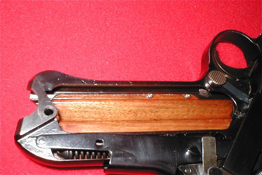

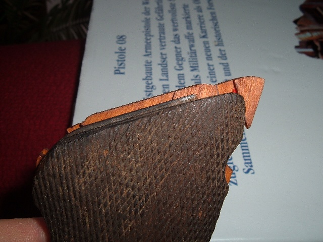

Hello to all,
We already discussed in some topics the differences between the Mauser Parabellum grips and the Imperial one. We highlighted that the Mauser Parabellum grips do not match with the standard model.
To better point out these differences, I have shot some photos. The Mauser Parabellum wood grip is compared with an Imperial model grip.
You can clearly see the differences.
In addition, hereafter an extract from the Allenâ??s article â??Postwar Parabellumâ? â?? American Riflemen, December 1979:
Concerning the 29/70 models â??â?¦One of the improvement incorporated by Mauser was the inclusion of two metal pins in each grip at the point where the raised interior wood rib meets the forward edge of the grip strap. This solved one of the Lugerâ??s chronic problems â?? that of loose grips resulting from worn or chipped wooden ribs. An unfortunate side effect of this change is that the grips were made somewhat wider and more squared than the normal Luger in order to be able to accept the pins. This decidedly and adversely affected the feel of the pistol. The grips on these early guns had the same smooth border associated with the Swiss 1929â? .
The grips were modified for the 06/73 model: â??In order to provide the desired feel to the pistol, the grip forward edges were more rounded. Since this resulted in making the grips thinner, it became impossible to seat the grip pins. To achieve the same desired effect, a raised pin was placed in the middle crossmember of the frame and a corresponding hole provided in the interior of the grips. Mauser had the last succeeded in making their Parabellum look and feel a Luger.â?
Ciao
Mauro

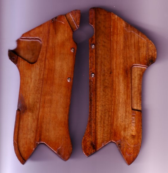

Unread 05-05-2005, 12:39 PM   #5
Hi Mauro,
I'll make some more when my camera's batteries have been recharged
In the mean time, I placed the grips under the scanner. This clearly shows the old style pins. Note that the previous owner varnished them.
Note the old style takedown lever, sideplate, safety lever.
Combine this with the old style grip fixtures, but a new style (front gripstrap) frame.

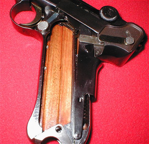

Unread 05-06-2005, 10:15 AM   #7
Hi Mauro,
That's what I thought and as many collector's have thought up interesting names I came up with the 1972-and-a-half variation
The pistol has a 1972 Ulm proof and has number 10.004187.
It seems that rather than production changing from one version to another, they just utilized parts on hand, substituting new parts only when old parts were used up.
I'vel added a frame shot without grip for comparison also.
I also noticed the rather crappy workmanship of the grip screws while removing the grips.

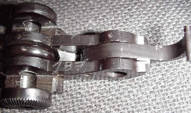

Unread 09-07-2005, 06:39 PM   #16
Hi Mauro,
I agree. We'd definately should plan something. I am visiting a Spa show on the 23rd this month.
Something else, I noticed something weird on the toggle of my Mauser Parabellum, I found the last 3 digits of the serial number, very crudely and very faintly etched on the side of the toggle, blued over. I know the toggle wasn't reblued during the barrel replacement and I'm wondering if this etched number is common on the Mauser Parabellum. Can you check whether any of yours has the same markings?

Unread 09-08-2005, 01:36 PM   #18
Steve,
thanks for checking. Could have been done as part of the repair, rebarrel, reblue and testfire scheme my pistol went through.
Mine came with a wire brush, others came with an old style cleaner.

Unread 09-10-2005, 03:10 PM   #20
Hi Mauro,
Here's the number. Very crudely engraved.
