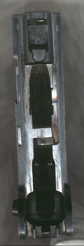

Well the problem is that there aren't that many other marks.
I've found some rather scattered marks. An X, a V and a C on the frame hidden behind the grip shells. Just above the trigger hidden behind the "takedown plate" is a 4 and a P. The number 4 is also stamped near the barrel on the "slide" along with an & and two I's.
Inside the frame is an encircled N. To the right in the picture you can see 75 which is a serial stamp (?). That is odd since the serial is actually 277. It seems strange that this part has been replaced but none other (except for the Tikka barrel)?

byf, I can't see the Tikka marking on your barrel in photo. Usually these replacements were 125mm (5") long vise the normal 100mm PO8 barrel. For an idea of present value see the current SOG FLYER or www.southernohiogun.com for several variations for sale. TH

Same Tikka mark. On the upper side of the barrel. No SA marks except on the magazine.
Now if this is a "normal" German pistol imported to Finland after the war then why doesn't it have any German stamps on it? That's what confuses me, it has none of the typical marks?

There's not much to say from the info thus far. The holdopen is mismatch to the frame. The letters and symbols you describe are called "workers' marks", they are probably line inspection or completion stamps; there is no known index or "key" to their meaning. An odd notation, the circle-N stamp appears in the lug well of my 1917 LP-08, my 1917 Navy, -and- my Mauser 1936 S/42.
The figure on the trigger suggests it might have originated with an Erfurt.
Are there no serial numbers on any of the small parts?
