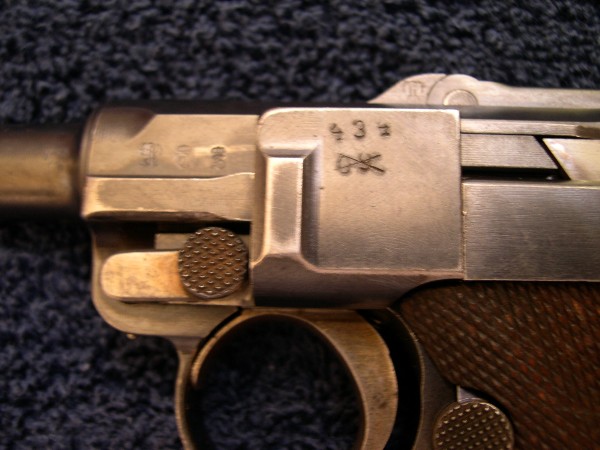

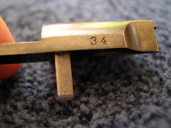

I just bought a very clean DWM that is marked in the commercial manner in regards to the serial numbers on parts.
The proof marks are on the left side of the receiver/barrel assembly in front of the side plate. Eagle, crown over a T and crown over a 3. There is no toggle hold open and no stock lug. The chamber is not dated.
The serial number is 434a and the entire gun is matching save for the magazine.

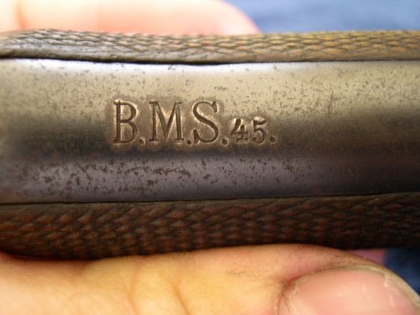

The gun is easily in the 95%-98% range the only things hurting it are that the side plate, while correctly marked 34 on the bottom, has been stamped 09 on the side, x'd out then stamped above that 434. The front strap, right above the bottom of the grip frame, is stamped B.M.S.45.
The gun is a vet bring-back and came with a WWI holster. The story is the widow's husband took it off a dead german in WWII and the gun was possibly used in police service prior to WWII. I will speak to her next week and get the whole story.
Can anyone help me with an approx. production year? I originally posted this in the commercial section but find it may be an early military gun. There is no crown over and N anywhere.

Unread 09-23-2005, 08:40 AM   #2
Jim, you have a P08 first model military, it probably left the DWM factory in 1909. The fact that it does not have a hold-open added is a good indication that it did not see police use after the first war. The property marking on the front grip strap indicates Bayerische Militaer-Schiess-Schule (Bavarian Military Gunnery School). A very good find and worth considering getting the side plate "fixed".

Unread 09-23-2005, 11:11 AM   #5
Jim, we would need to see photos before estimating value or what course to follow with restoration.

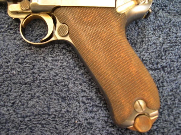

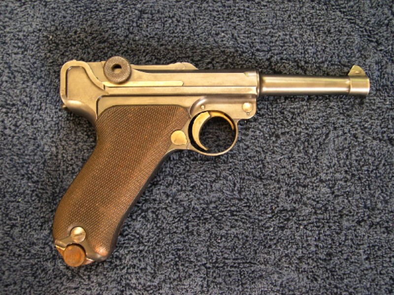

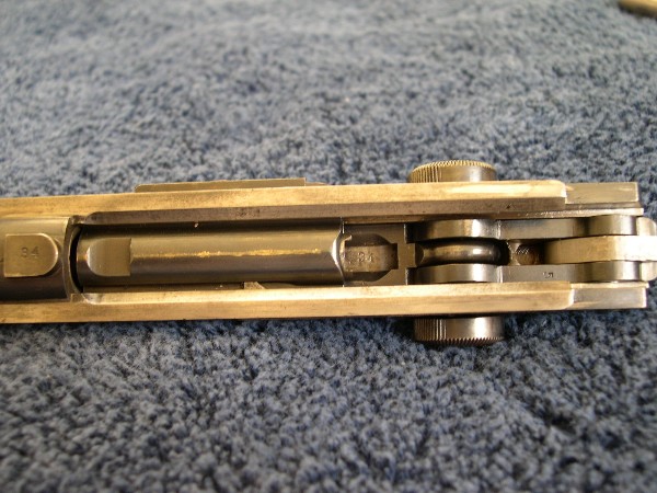

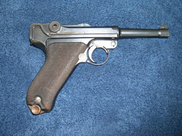

Unread 09-23-2005, 12:14 PM   #7
JimD
Location: South Carolina
Posts: 184
Thanked 3 Times in 2 Posts

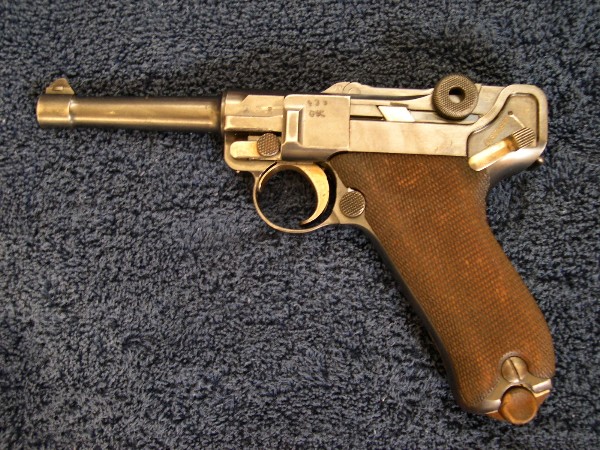

Here's photos:
"Dyin' aint much of a livin', boy".
JimD is offline   Reply With Quote
Unread 09-23-2005, 12:17 PM   #8
JimD
Posts: 184
The photos don't do this gun justice. It is very clean and is really at least 95%. Holster and handling wear to the edges and high points with some freckling on the grip frame but it hasn't removed the finish.

Unread 09-23-2005, 12:47 PM   #9
Thanks: 1,123
Great gun! That one is a keeper. Bavarian guns invariably do not have an added holdopen. Evidently the Bavarians had little regard for Prussian directives to add it.
Unread 09-23-2005, 01:03 PM   #10
Jim, Mr Wood is right, it's a keeper! I would recommend sending the side plate to Ted Green to be restored to its original condition. Ted should be able to do a pretty quick job for you if you just send him the side plate. If the plate had not been boogered, the pistol would bring about $2000 maybe more.

Unread 09-24-2005, 07:34 PM   #13
Thanks: 2,079
I think I would hold off on having the side-plate "fixed", its interesting now, having the 34 on the bottom, then the other numbers...

Unread 09-24-2005, 07:49 PM   #14
JimD
Posts: 184
That's good advice, Ed. My wife says the same thing. That's the way I was leaning. My gut feeling is that it's part of the history of the gun and was done for some reason. I'd hate to correct it then find out it was done for a specific purpose and then have lost it to history.
