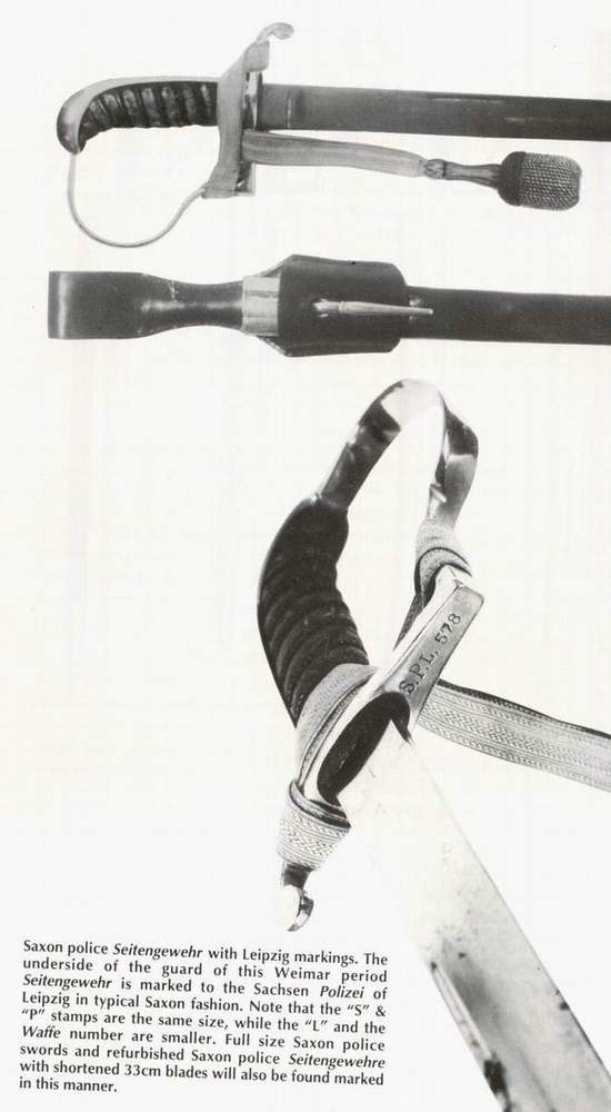

I agree with you that this may well be a marking for the Saxon Landespolizei. The standard Saxon Police marking is as you have described. Even though there are no known Saxon Pol marking instructions, surviving examples of Saxon Police weapons survive to show the manner in which they were marked. Here is a page from my book, "Seitengewehr: History of the German Bayonet 1919-1945" that shows the usual Saxon Police markings. This marking is for the Leipzig Polizei but shows the proper style. This particular Seitengewehr was only worn by the Saxon Polizei and cannot be confused with sidearms from other states, such as Prussia. The text explains the sizes of the various die stamps used. These exact same markings will be found on pistols.
I hope this is helpful.
George

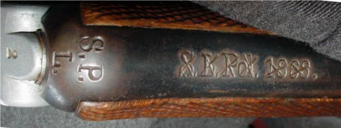

Now I'm confused. Is it "S.L." as in your original post or "S.P." as in the latest?
Here's an example of the Saxon Landespolizei marks (the one x'd out). Admittedly, the lower-case "l" looks a lot like a "1" but note that the serif at the top of the 1 is sloped and the one on the l is horizontal.
Don

Howard,
I stand by my earlier ID as S�¤chsische Landes Polizei (Saxon State Police). I can see the difference between the top of the "l" and the tops of the "1"s.
This will be a great addition to my database. I suspect that the reason that this mark was not x'd out and replaced with S.P.L. was that it was retired from service before that change was made. Thanks very much for providing this information.

I agree with Don that this is a Saxon Landespolizei marking. A very nice pistol and marking BTW. These markings are confusing because of the change in style and the fact that published Saxon Pol regulations are not available.
Don,
Unfortunately there is no way to date the markings on these Saxon Seitengewehre. They wore them from Imperial times through the time of the Weimar Republic and even into the early NS Zeit. The markings remained (just like the Prussian Pol markings) so it is not really possible to date them to a specific time frame. We can only be sure they are generally from the time of the Weimar Republic and that they were no longer in general use after 1937.
George

I misspoke when I said that the S.L.Pol. marks were replaced by those of four of the Saxon governmental districts. The S.L.Pol. marks in my database that were superceded were all replaced by S.P./L. marks. Apparently, all these weapons went to the Leipzig district.
