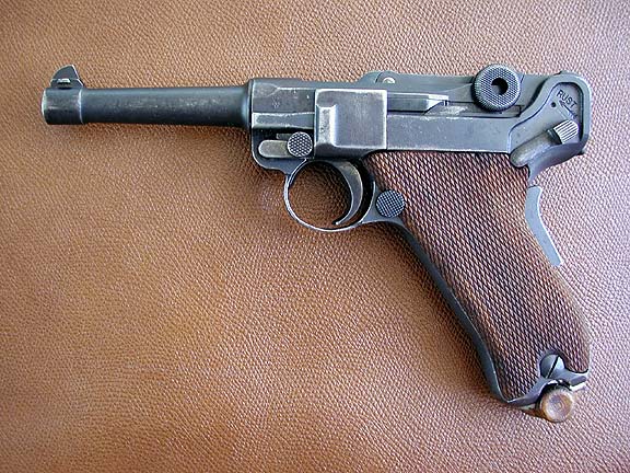

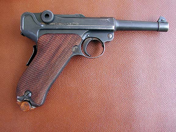

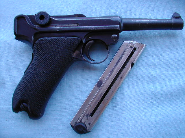

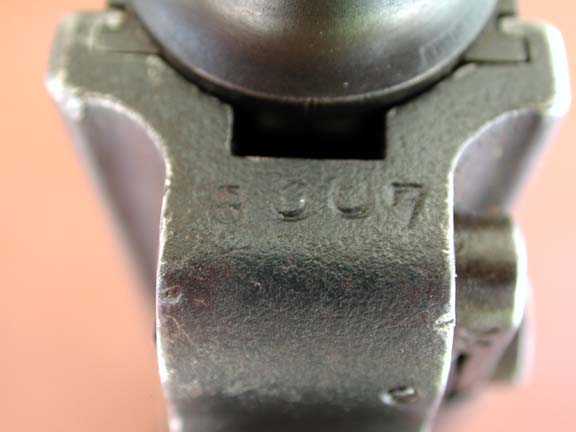

I thought I would post some picture of my newest acquisition, a Vickers Dutch East Indies Luger. As is common with these pieces it is in rather rough shape finish wise with some heavy pitting on the grip straps and the grips themselves are missing some pieces but they are the original ones serial numbered to the pistol. It has an original unnumbered Vickers magazine with the bottom piece release spring but it appears so rusted I'll probably not try to get it apart. The side plate is unnumbered but looking at the pictures in Martens and deVries 'The Dutch Luger' most of them are unnumbered also. Otherwise all the other numbers are matching. I have to assume that it has been partially arsenal refinished as the barrel has a different finish and is dated on the top '1931' According to the above reference the common practice at the time was to replace the barrels every 6 to 7 years due to the harsh climatic conditions of the area.
A little background on the East Indies Lugers. In December 1919 the Netherlands signed a contract for 6,000 M11 (the Dutch designation for the Luger) pistols to be produced by Vickers. These pistols were not ready for delivery until May of 1921. Most of them were delivered without the grip plates which were to be made at the Geweermakersschool in Batavia (Jakarta) probably to save a little money. These Javanese grips had much coarser checkering which detracted from the overall appearance. Exactly 6,000 Vickers Lugers were assembled for the Dutch East Indies Army for this contract. The serial numbers followed the pre-World War 1 deliveries by DWM so the Vickers pistols were numbered from 4182 to 10181 inclusive. These Lugers probably arrived in the Dutch East Indies in 1922. My Vickers is serial numbered 4461 making it one of these pistols.
Most Vickers Lugers have a brass plate affixed to the left frame panel indicating the unit of assignment. As this one has no plate, nor any evidence of ever having one, it was probably one purchased by an officer. In 1942 the Dutch East Indies Army capitulated to the attacking Japanese Army and this Luger was in all probability captured by the Japanese. Where it has been and what stories it could tell before coming into my possession would be of great interest. Here is a web site with some good info on the Dutch East Indies Campaign of 1941-1942,..

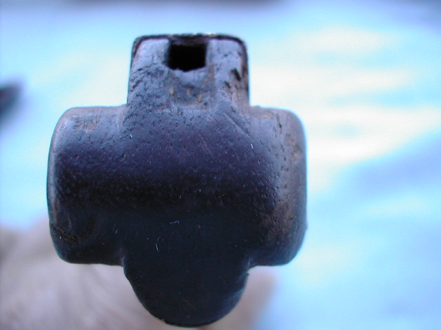

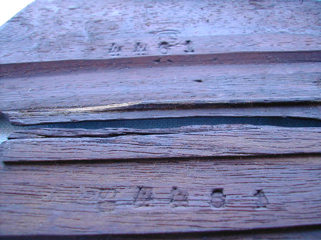

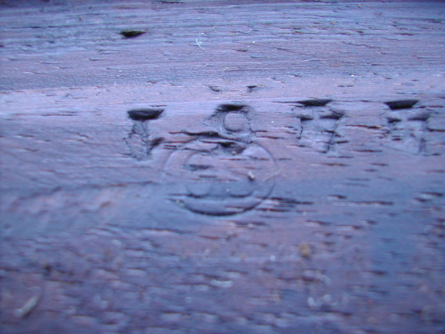

In photo #7 is visible the cirlce GS emblem of the Dutch Geweermakersschool

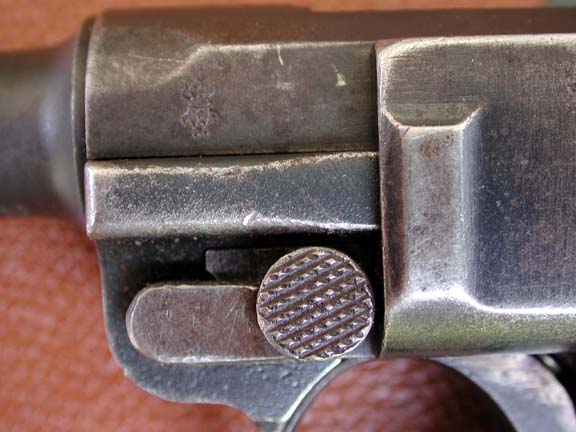

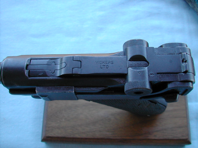

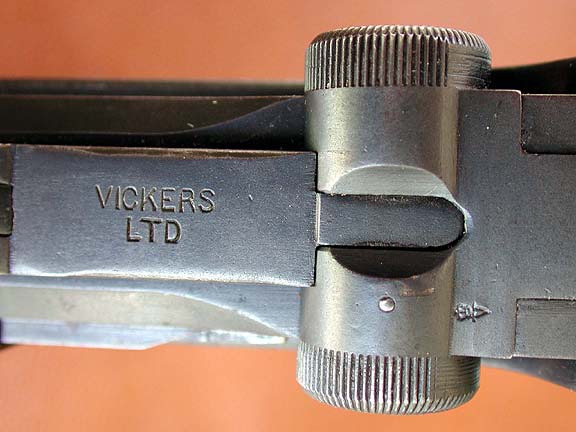

It is interesting to see that the center toggle piece doesn't have the c/V "view mark" (British inspection stamp).
Are you sure that the side plate isn't numbered on the bottom edge? Mine is.

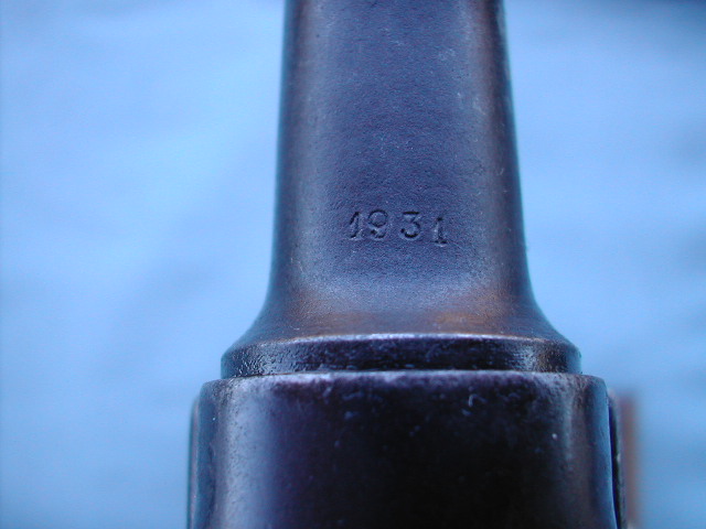

The barrel date is curious. It is true that the date commonly reflects the date of rebarre, but your gun has all the British proofs underneath the barrel where one expects to find them on the original barrels. I'd ve interested to see the witness mark on this piece.

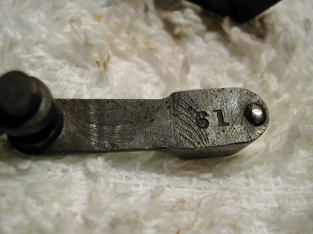

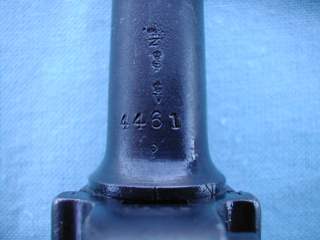

Dwight, you are correct, the bottom edge of the side plate does have a number #45, a mismatch. The center toggle has no proof but the bolt and the rear toggle do have the c/V stamp. I'll get a pic of the witness mark for you . I think Ron might have the answer, the 1933 date may have been a rework date for something else, the side plate maybe? as the barrel does still have it's original stampings even though it definitely has a different appearance and finish from the rest of the slide assembly.
http://forum.lugerforum.com/lfupload/witness_mark.jpg

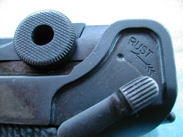

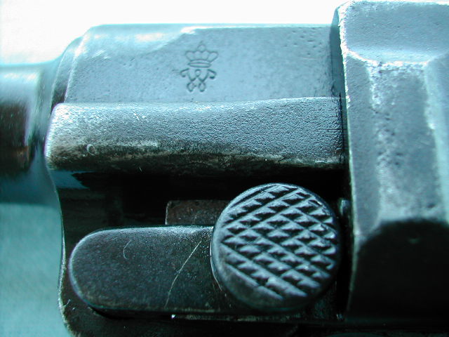

Just barely visible in this photo is the unusual location of serial # on the thumb safety lever, on the inside rather than on the edge.
Ok, I'm completely confused now. Having taken the time to do a little more research in Martens and de Vries I find the following: "Finally, a completely different set of proof marks is (sic) found on the Dutch Vickers Lugers. These pistols were proofed in England, and marked accordingly. At the underside of the barrel, they were struck with the letters "NP" (nitro-proof), the crowned, entwined letters "GP" (the definitive proof mark of the London proof house) and a crowned "V" was also struck on the most of the pistols' principal parts, such as the toggle assembly, breech block and frame.

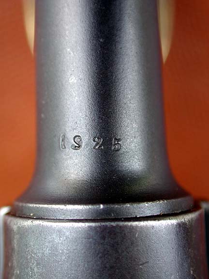

Underneath a photo on page 163 showing a barrel date of 1925 the caption reads "Most Dutch East Indies Lugers have a small date struck at the top of the barrel. As pistol barrels wore out quickly in the tropical climate, they were replaced every six or seven years. The date signified the year in which the barrel entered service. The earliest year observed is 1914, the latest 1941.
Since this Vickers has the original proof marks on the barrel as well as the date of 1933 on the top of the barrel it must indicate something other than a routine barrel replacement unless there happened to be a quantity of spare barrels that were originally proofed in England, and then serial numbered to the weapon following replacement. The barrels that were made in the Indies were stamped with the arsenel stamp, GS, however there is no mention of there being a supply of original Vickers barrels used for replacements.

Herb,
Curious indeed.
The witness mark doesn' t tell much, it is very mismatched. Mine is as well; the barrel is original British without date. It would be useful for other Vickers owners to weigh in with their barrel markings/originality and the characteristics of their witness marks.
"Something other than a routine barrel replacement" occurred to me, although Martens and DeVries are pretty positive about this. I'm not sure that simply swapping out the sideplate would have merited a date.
It is easy to speculate that some spare parts were included in the Vickers shipment (I believe I have read thhis, although cannot find the citation so this should not be considered authoritative). A barrel would have had to have been assembled into a receiver and proof fired in order to receive the nitro proof stamp, I'm not sure this is likely. Martens & DeVries note on p. 86 that the Dutch obtained spare parts from DWM until (possibly) WWI, making most (but not all) the parts required, including barrels, by the mid-30s.
Regarding the placement of the serial number on the thumb safety, remember, these guns were numbered in the Commercial style.

Dwight, I agree, it's not likely that there was a supply of spare Vickers barrels laying around. As to the number on the safety lever, it's on the inside, not visible in any manner when it is in it's proper location. Here's a better picture of it---
http://forum.lugerforum.com/lfupload...fety_lever.jpg

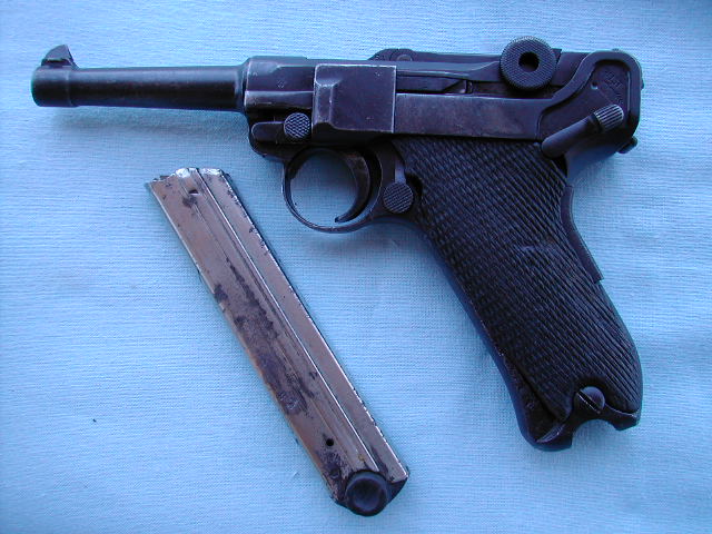

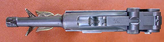

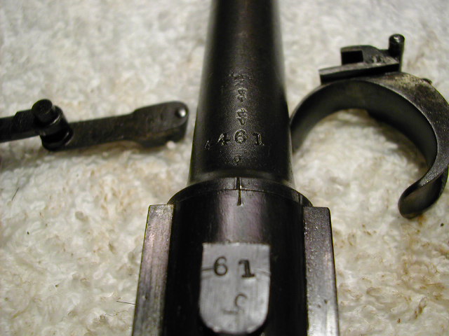

Here's some pics of my Vickers Luger. It is a mishmash of parts; The frame is #8007 and the trigger & breechblock are 07. The bbl is #4706, & the receiver, middle toggle, rear toggle, & toggle pin are #06. It appears that the first two numbers of the bbl SN have been over stamped, however the witness marks line up and the receiver is stamped 06 on the bottom. The take down lever & sideplate are #08. The grips are "Clark replacements". It comes with two original Dutch mags, one with a replaced wood bottom. It has 1925 rework stamp & doesn't look like a brass plate was ever soldered to the frame.

Hugh, even tho it's mismatched it's in decent shape, I like those mags, mine has the spring rusted away. I had just recieved it the day I took the pictures and have spent many hours cleaning the rust out of and off of it, it looks a little better now with a good coat of penetrating oil on it. From what I've read no Vickers will ever win a beauty contest, even when they were new. I don't really care, it looks pretty to me and fills a big hole in my collection. These babies are really hard to come by. Until I got mine I had only seen one other one, Ralph had it at one of the Reno shows. You can go out and on several days of the month you can find those red cross Lugers and them Kreigerhoffers, but finding a Vickers is another matter. Thanks for the pictures, a decent example.
