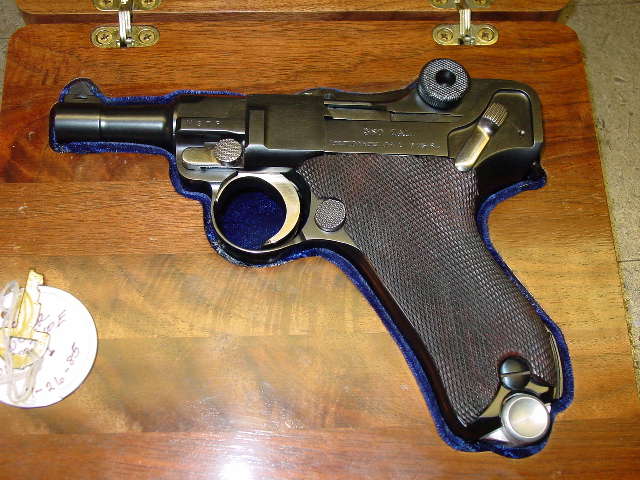

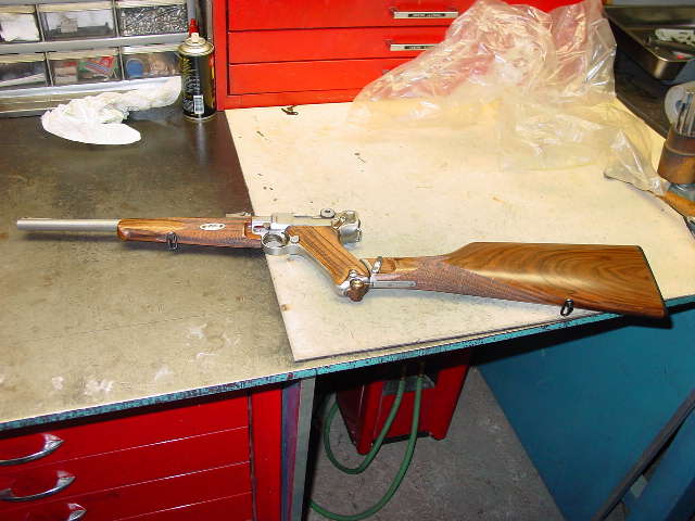

Maybe I can help as I spent some time with John last August. I believe that it will be his 81st birthday unless he is planning on staying 80 as he told us it was his 80th last year. What a fine gentleman.

John's Favorite:

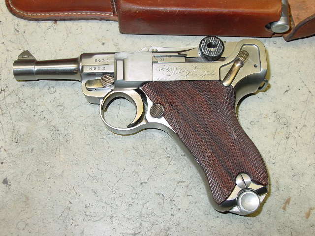

John's Wife's Baby :
Baby 380:
Baby P38:
