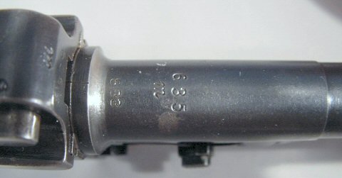

I have inherited a Luger pistol that belonged to my grandfather and is supposed to be from the WW1 era. My fiance is a gun enthusiast and we have been looking through all of his gun books to find info and value for this particular pistol and have reached a dead end. Here is what I know:
-It is a Luger artillery model (I believe it's a LP-08,) with an 8" barrel and 800 meter adjustable sight, 9mm caliber.
-Has DWM logo
-Serial number 635, matches all pieces including the magazine, the only thing we didn't check was the grips.
Now here's what's throwing us a curve ball - there is no date stamped on the barrel. We've found information about Lugers that have a 3-digit serial number with a date, or a 4-digit serial number with no date, but nothing for 3-digit serial with no date.
I know there are lots of forgeries out there, but since all of the serial numbers match, this doesn't seem likely (or else someone paid lots of attention to detail.)
I am able to post photos if necessary - I have a digital camera so I can photograph easily. I've searched this forum and done lots of Google searches tonight but have come up empty. Any help anyone here could provide regarding the age of and/or any info regarding the gun would be very much appreciated.

There is not a correlation between the number of digits in the serial number and the presence or absence of a chamber date stamp. All Imperial military Lugers of any description, made between 1910 and 1918, have chamber dates; LP-08 production began in 1914.
It will be diagnostic for you to photograph or describe any markings on the left or right sides of the receiver, and also on the barrel. After WWI the germans manufactured many guns for the commercial market, including Commercial Artilleries. These are found marked differently from military guns, often with combinations of no chamber date and commercial proofs (crown-over-N) or no proofs at all.

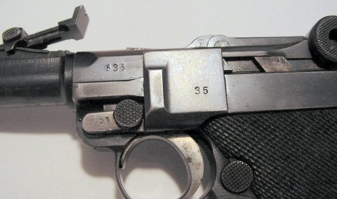

the above gentlemen are correct in assuming that the gun may be a commercial artillery Luger. What would help, until you get some good pictures, would be to look on the right hand side of the receiver to see if you have any military proof marks on it. The first break-down of a luger is into two pieces. The receiver is the top half of the gun and the frame is the bottom half. If the gun is a military and not a commecial LP-08 then there will be anywhere from two to six marks on the right hand side of the receiver with most of them looking like maybe one-eighth high eagles. If the gun is a commercial LP-08, then there will be nothing there and it will look like there never was anything there.

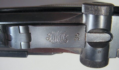

An excellent selection of pictures which, unfortunately, shed no light on the absence of a date stamp. In every other respect this gun appears to be a perfectlyin Ordnung example of a DWM LP-08. The m letter suffix suggests that it was manufactured in 1917, as that is the only year in which Artillery Lugers are reported in this letter suffix range. If you can't find a small GERMANY stamped somewhere--anywhere--on this Luger, it is a puzzle beyond my ken.

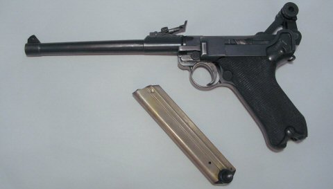

From your photograph it appears that the magazine is a legitimate match. Authentic matching Luger magazines are uncommon, and yours adds both value and cachet to this gun If you are interested, an Artillery shoulder stock can be had for $400--$800, depending on circumstances.

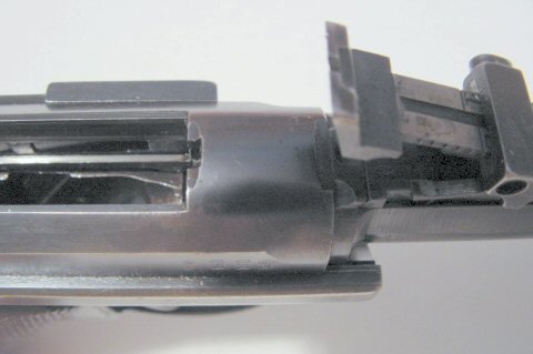

Laura, This LP08 is without a doubt a military. It was born with a date and has been ground off. You will notice the different coloration and finish where the date was and should be.
The military proofs all over the pistol attest to this.

The elevation of the extractor indicates a round in the chamber....exercise
caution, could be a live round.
Regards Ken D

Ken - not to worry, we had a 9mm dummy round in there. No live ammo anywhere nearby.

Laura, was going to check something on the serial number, as "m" suffixes were only made certain years, but my Imperial Lugers book is in storage.
My gut feeling is that this started as a 1916, 1917 or 1918. The proofs on the right look correct for that time period...

The lady's pistol is a post WWI commercial. As noted, the date has been ground off. The absence of the usual "GERMANY" marking may indicate that it was refabricated for the continental market.
I have one just like it serial numbered 4486a with no fine tunes. Like the one above, mine is not marked "GERMANY".
It started life as a military issue. It's a nice pistol and a relatively scarce piece.

I agree with the consensus that this is a former military LP-08. Why the date was ground off is a mystery.
