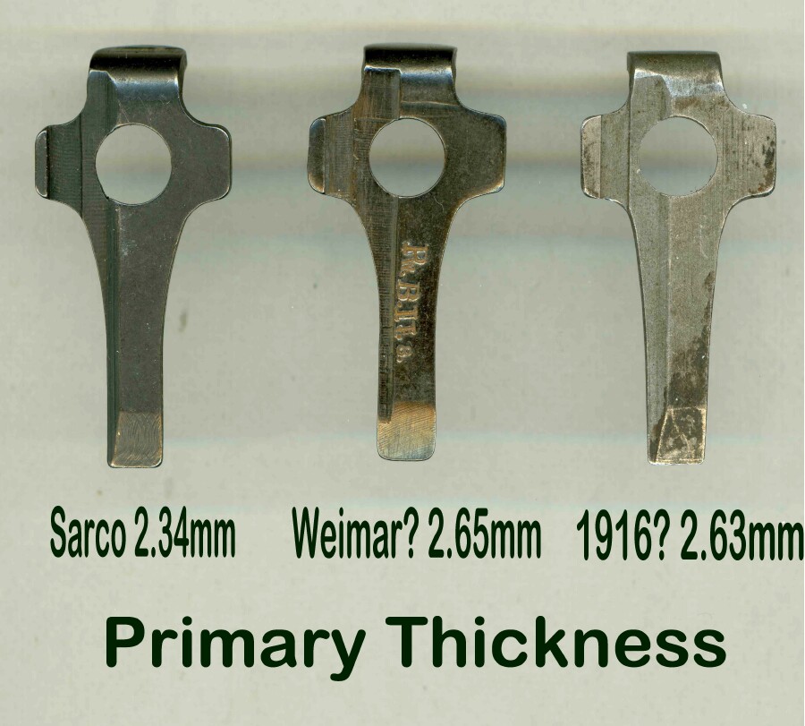

I have also been looking for a couple of Imperial loading tools, but I am very much afraid of those offered on eBay. Some of them look exactly like the repros I bought from Sarco . . . . excellent tools, but not authentic Imperial era.
If you have a flatbed scanner you can create very good digital images of loading tools. Scan at 800 - 1200dpi and size to suit after you have the image stored.
The image below was created on my Epson scanner at 1200dpi and sized for the forum afterwards. The titles were added by using Adobe Photoshop.

I measured by 2 loading tools one likely authentic, one I had no idea. The authentic is from a 1916 rig I bought; Erfurt proofed measured 2.59 mm. The questionable one measured 2.28mm. Both have the same characteristics of yours visually and dimensionally. Can we assume that repros are thinner than authentics?

I wish I could answer your question. Unfortunately, except for the dimensional specifications provided in the Luger blueprints which John Sabato is offering, I have not seen any other quantitative criteria for determining authenticity.
The blueprint from John Sabato indicates that the thickness was specified as 2.5mm with no tolerance provided.
