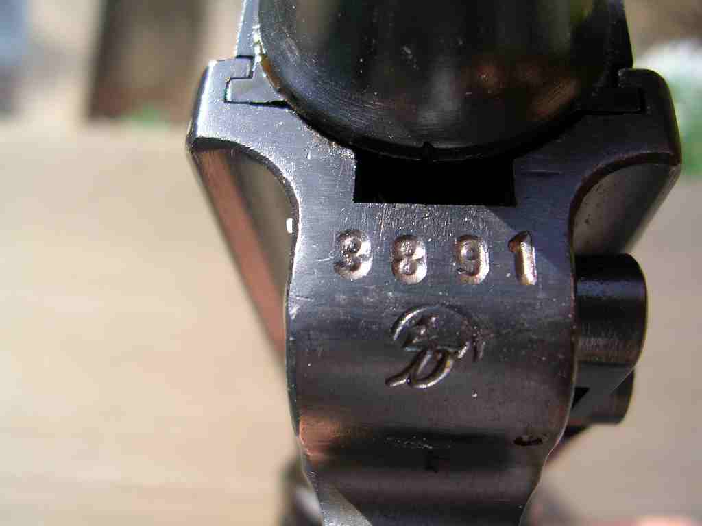

Default Marks&Serial
one more pic

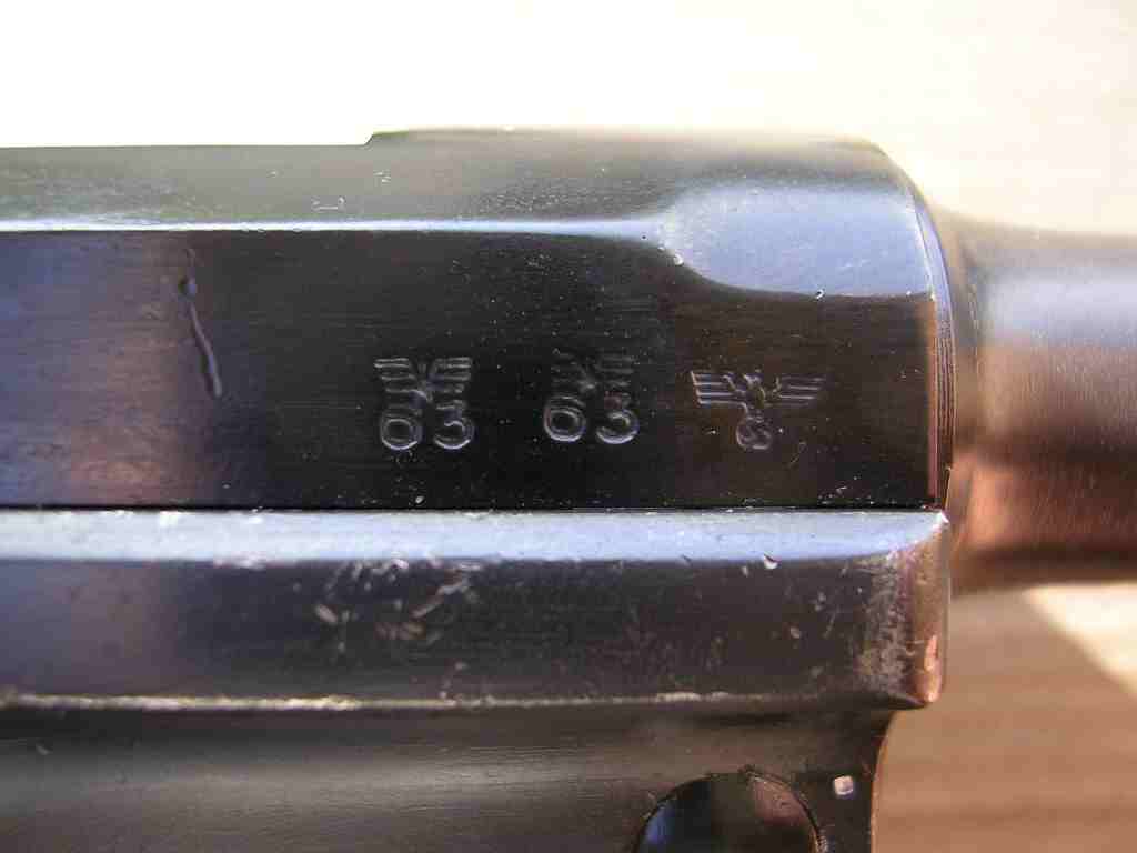

does this means that the 42 mark on Breechlock group and the 1939 date on the frame are comming from different guns? or however it's a "vopo" the initial gun was a Mauser 42?

"42" was a code used by Mauser to identify pistols and piece parts they manufactured.

VOPO, is the term used for an East German reworked Luger. What you have is a 1939 / 42, Mauser made Luger. It was made in 1939 by Mauser under contract to the German Army. The 42, as Tom pointed out, is the code assigned to Mauser from 1939 -1942. From 1936- 1939 the code was S/42. Approx. 85,000 Lugers were produced in 1939 ( Jan Still's Third Reich Lugers, pages 65 - 66.)
If all of the 2 digit numbers stamped on all of the parts. Match the last 2 digits of the 4 digit serial number. Then you have a matching gun. If not, then it's a mis-match.

Fredo, I just noticed in the photo of the serial number, the partial stamp over lapping the O suffix. I thinks it's the top half of the East german Sunburst proof mark.

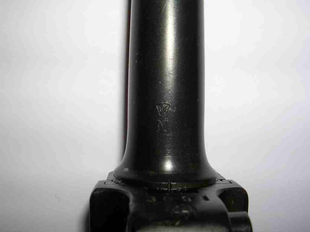

The barrel is a textbook example of a VoPo replacement. Note the rough texture of the barrel crown area. They're struck on the bottom with a single crown/N, no pistol serial number or diameter, etc... Depending on who imported them the caliber may be struck somewhere on the barrel.

(Ron: I think the overstamp is an 'X' in a circle. Probably done to remove the serialnumber letter from the registered serialnumber).

Thx for the very precise comments. I had a closer look at the barell and found then N+crown, but no caliber mark. Mine is wihout a doubt a 9 mm Para whcich shoots very well with Swiss9mm ordonance ammo.
