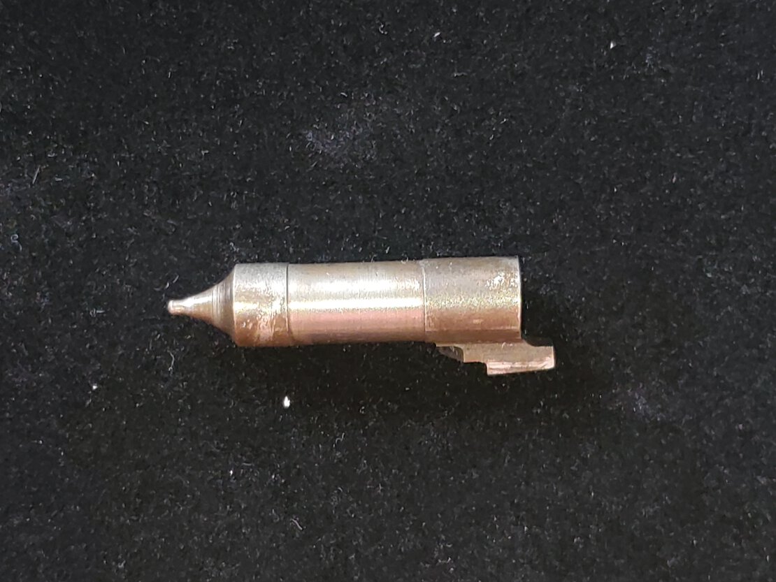

The firing pin was certainly dirty when I pulled it out. I have attached photos showing the sear surfaces on the firing pin and trigger bar. Doesn't appear to be polished, but again, I don't have anything to compare to.

Emil,
need a side view of the sear bar to see how the sear catch looks in height.
