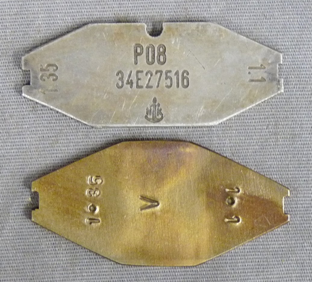

Here is what the gage looks like.
An original Kreighoff accepted gage, and one of my home made ones.
The min and max are in mm.
Thus the end of the striker(firing pin) should extend at least 1.1mm past the breech block face, and no more than 1.35mm.
