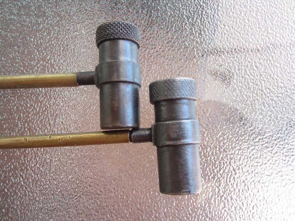

With oiler! How does one use the oiler without making a mess?

The "dipstick" was meant to be used as a crude brush. Dip it in the oil well and then apply drops to all the typical areas needing lubricant on the pistol.
This is an era where lubrication and cleaning were viewed seperately.

the pattern on the lid normally has dicing patterns in 2 directions that cross each other. looks like a repro item. no original.
Unread 06-25-2013, 12:50 PM   #12
I'm wondering whether it's a Portuguese rod with a replacement shaft?
Regards, Norm
"Knurling"...I just received a nice knurling tool for my German thread protectors, and a couple sets of rollers...getting only one direction cross hatch is pretty hard to do...
Unread 06-25-2013, 12:56 PM   #14
Ben is correct..this is NOT an original rod IMO. You will also notice the brass rod is jointed. It is screwed into the stub projecting from the grease barrel.
I have mentioned this many times before but since it's come up..I will do so again. The Germans cannot have manufactured ANY rod with a screwed in shaft. Any shaft manufactured this way will unscrew itself and simply slide right out the end of the cleaning rod sleeve and be lost.

Default For You Jerry!!
A nice close-up!

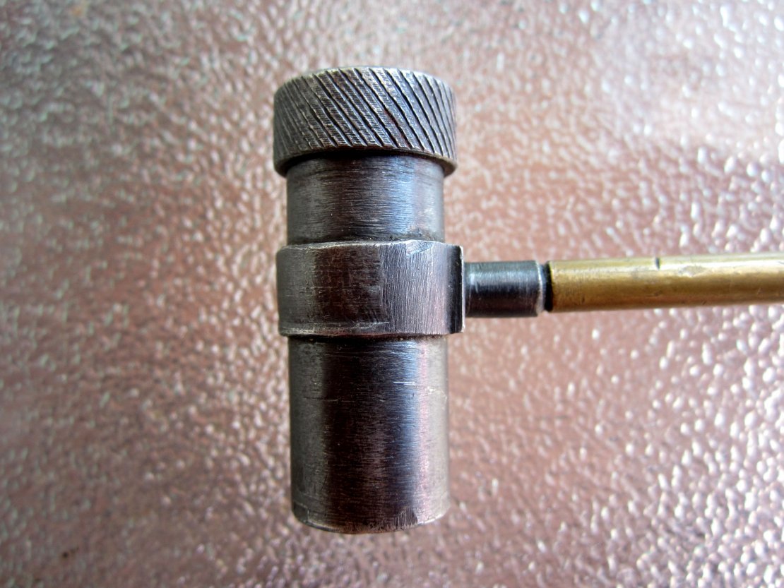

When you look at that close-up, it is apparent that the work is pretty crude. Even I can do better than that.
I think even Eric can do better than this...I lightened it to show the file marks, emery cloth scratches, gouges, uneven width of clamp...Sorry Eric...
I'm thinking now, from the crude look of the work, that the single knurl cut is from a misaligned knurling tool - only one roller cutting...(Well, displacing the metal actually)...I'm basing that on some of my own mistakes...But I learn, eventually...
By the time I'm 120, I'll have this work down pat...

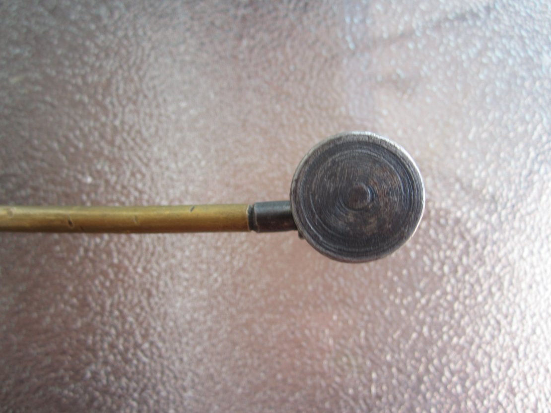

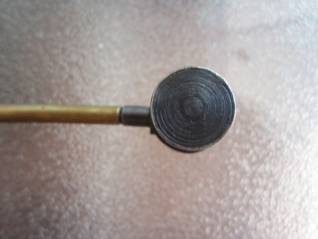

Default My other!
A little different. They both look real to me!!
