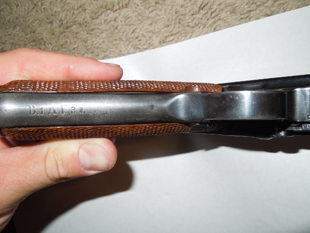

On the front of the frame where your finger ride is the following:
B.1.AF.3.2.

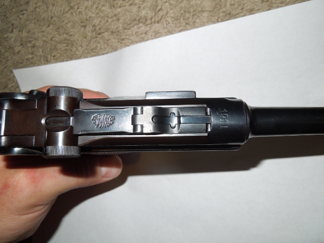

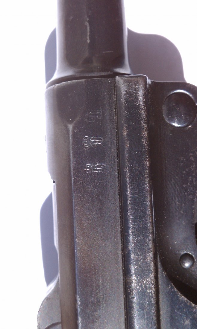

It sounds like an imperial era military unit marked to the Bavarian 1st fuss artilery, 3rd battery, weapon 2. Good detailed pics are a must. John

DWM manufacturer
year made 1911

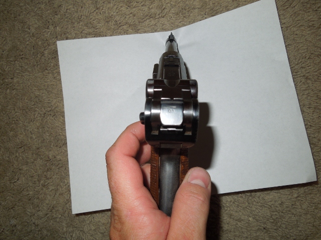

Default Picture

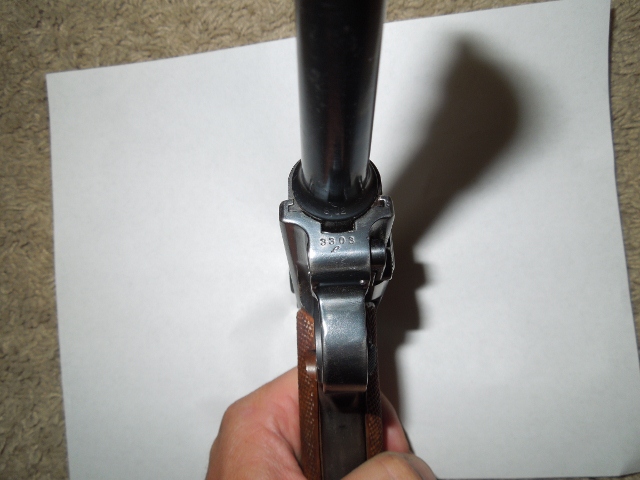

Here are the stamps.

Unread 07-20-2012, 09:45 PM   #5
Originally Posted by JTD View Post
It sounds like an imperial era military unit marked to the Bafarian 1st fuss artilery...
...Uh...The what???...

Default The rest

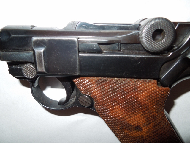

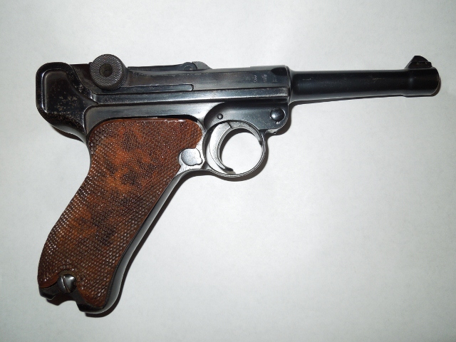

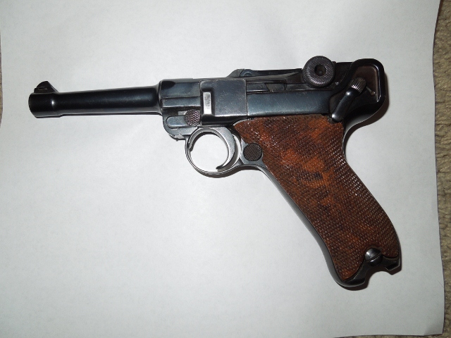

I do know the grips are aftermarket and shotty at best.

Gun looks refinished, knocking it down to about shooter quality. Otherwise a nice early luger. Postino,fixed spelling error, sorry.
Fuss (foot) artillery were the heavy guns, big and bad..........

I agree with JTD. It appears that your pistol has been refinished - the trigger, mag release, ejector, safety and takedown lever should be straw colored. It's a shame that someone did this, because in it's original condition it would have been collectible - even in mediocre condition, assuming all the parts match and because of the unit mark - B.1.A.F.3.2 (I think this indicates 1st Bavarian Foot Artillery Regiment, Battery 3, Weapon No. 2).

Yep, the gun was refinished. In this process the lanyard ring at the rear of the frame was also removed. But it would works as a nice shooter.

Terry, your pistol's serial number is probably 3303e. I have 3268e and 3690e both marked to the Bavarian Artillery zu Fuss 1.

I blew up the pic. It is 3303e.
