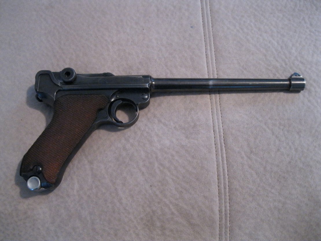

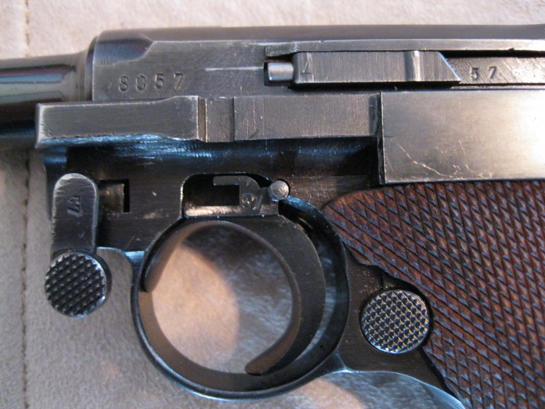

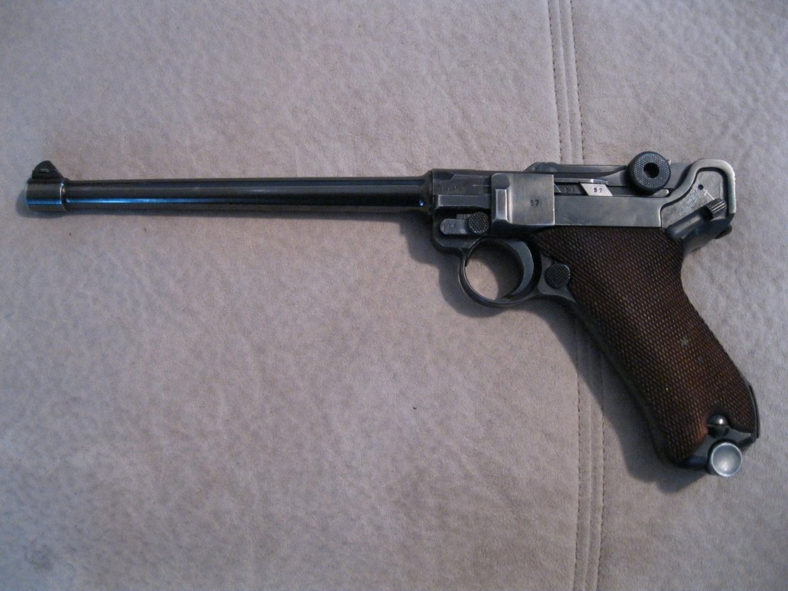

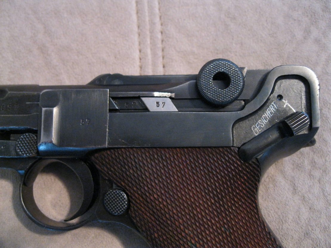

Threw in some picutres now. I disassembled the Luger and everything seems clean. Springs look good and the plunger moves freely. Tried it again and it did the same thing. First round fires and ejects, next is chambered and then 'click'. I pulled the toggle back and the round stayed in the chamber. I had to pull the round out-it does come out easily. I ordered replacement springs to try that. The lady I purchased it from said it haden't been fired in 25+ years. Thanks for your help!

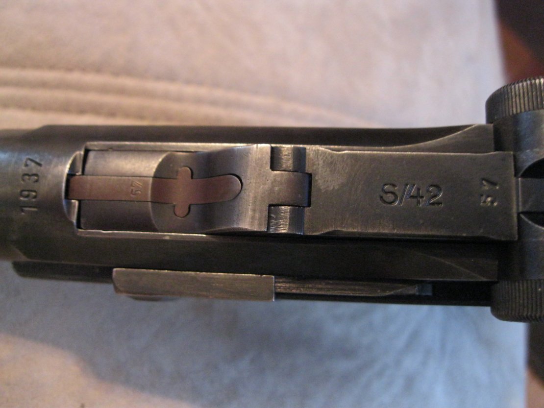

The scratch on the left side of the receiver just in front of the sideplate indicates the trigger lever adjustment may be off and it is not moving back enough inside the sideplate to allow the plunger to go forward and reset for the next shot. First thing I would do is clean out the inside of the side plate good to make sure the trigger lever is moving very easy back and forth. If it is and the plunger spring is strong then a couple of options present themselves. Swap out with another trigger lever to see if that helps, metal removal from the face of the trigger lever where it meets the sear plunger. Adjustment of the sear spring to a lighter push sometimes will fix this too. Sending the gun to LUGERDOC to get it up and running is what you might consider. He will fix it to function correctly, that is his specialty. Bending the trigger lever is NOT recommended as it is a harden part and will simply break if you try to bend it. One other thing, the barrel is an after market replacement. As issued it would have had a 4" (100mm) 9mm Caliber barrel.

You never mentioned that your gun had a big, honkin' aftermarket barrel in your original post. This would reenforce the possibility of headspace issues, (as would your assertion that rounds will not extract).
The previous owner's mention that it had not been fired in 25 years may be for a reason; Someone had a shade tree gunsmith install an aftermarket barrel on the gun and when it would not function reliably, gave up on it and put it away. I would send the gun to Luger Doc and have him get it running for you.
