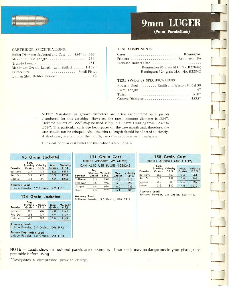

Default Lyman 45th Edition Reloading Tables
The newer editions don't list the 7.65mm/30 Cal Luger loads, so I got an older (1970) edition just for S&G...
Here's a couple scans of the 7.65 Luger/7.63 Mauser/9mm Luger loads from back then...
Please remember that these loads were for powders available back then...The specific powder formulas may have changed even if the name didn't...Use these values with caution...
