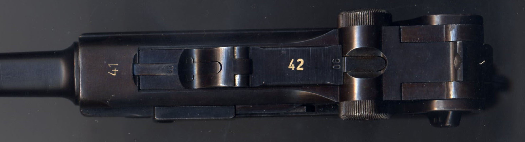

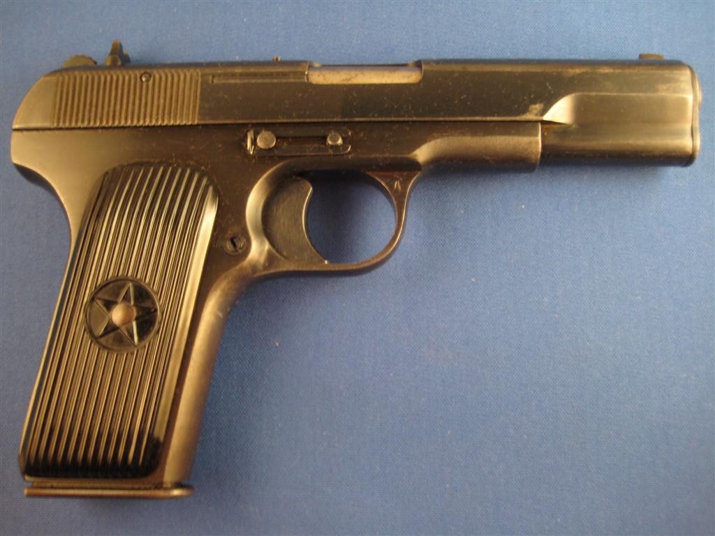

Not only the size of the picture is important, the background and lighting makes big difference as well. I have two sample pictures here for the same gun (sorry, not Parabellums).... same big 1024x768 size, both are sharp, but reveal different level of details.
Which one should I post on an online auction site when I sell it..... maybe both.
http://forum.lugerforum.com/lfupload/type542.jpg
http://forum.lugerforum.com/lfupload...ight_copy1.jpg

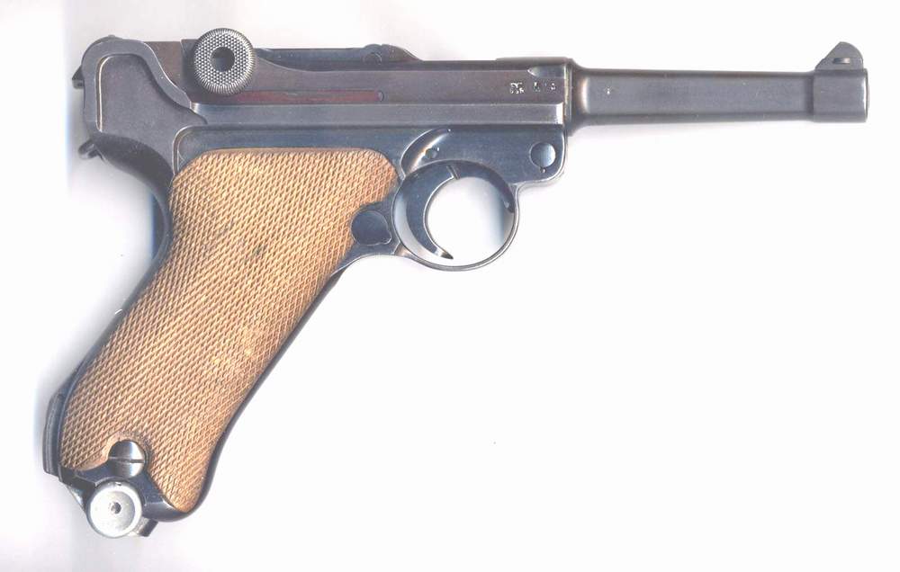

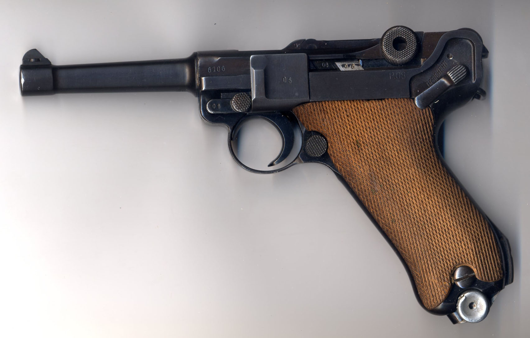

Sorry, I screwed up the photos. Here are some larger image files.
Alvin, I posted a photo of the back of the bolt for that 1920s commercial, that
you had asked about previously. It's under the commercial site. barr
http://forum.lugerforum.com/lfupload/right_1_copy1.jpg
http://forum.lugerforum.com/lfupload/right_1_copy2.jpg

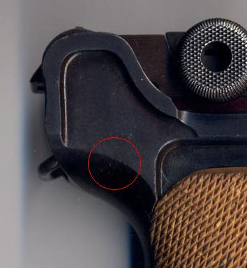

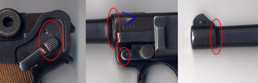

barr, all three pictures are same. Have you checked the encircled area under a loupe?

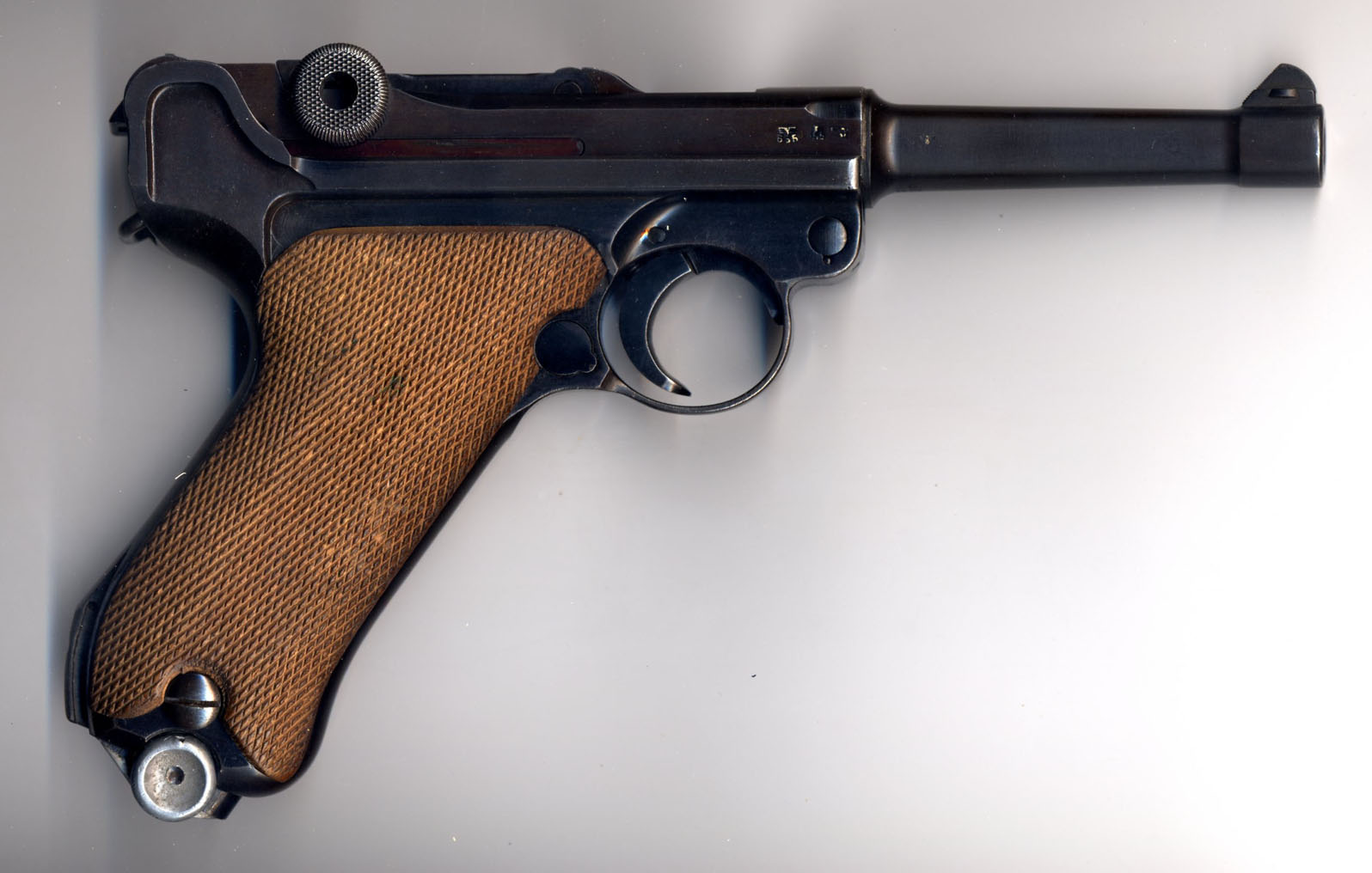

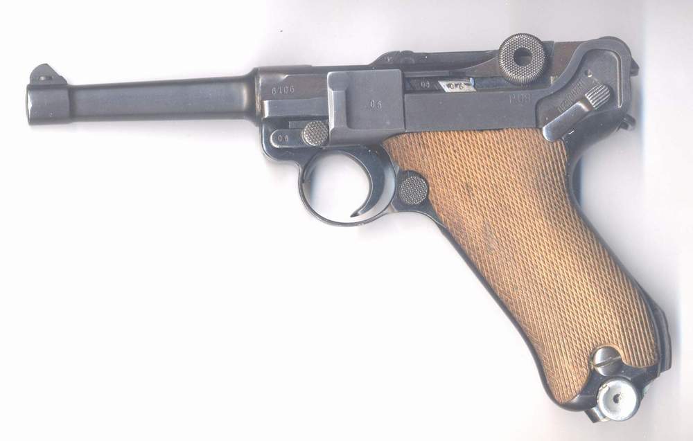

I must have messed up again! Here is another try.
No, I have looked at this area under magnification, I'll check it.
Hope these work out better, thanks barr.

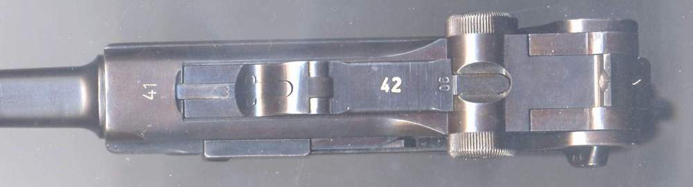

http://forum.lugerforum.com/lfupload/left_1_copy1.jpg
http://forum.lugerforum.com/lfupload/right_1_copy3.jpg
http://forum.lugerforum.com/lfupload/top_copy15.jpg

Looks good to me but I am still a newbie. I lighten up your photos.
Jerry

more

Thanked 34 Times in 17 Posts
again

I believe Alvin and Tac are correct. I believe it has been reconditioned, unfortunately. I hadn't noticed that area under the back of the upper frame, you have good eyes Alvin. I had noticed a little bit of pitting on the right side of the frame just above the trigger, that's why I had questioned the bluing. It was probably done several years ago, because it looks to have some age to it.
Well, like you say, it is still a nice looking piece, just a high dollar shooter, I suppose.
Thanks guys, I'll just have to pay more attention and use a light and some magnification on the next on. After looking at it more closely using a light and some magnification. I can see a lot to indicate that it has been re-blued.
barr

There are a few areas that I feel suspectible. But I have not owned a Mauser Luger yet (if not counting repro of repro, a.k.a. Interarms , it's in general:
1) The serrate head of the thumb safety looks worn, but the supposed "arc" under the safety is faint... almost does not exist.
2) The joint area of barrel and receiver is suspectible. The triangle shaped edge on receiver does not look sharp enough.
3) The muzzle band edge does not look sharp.
