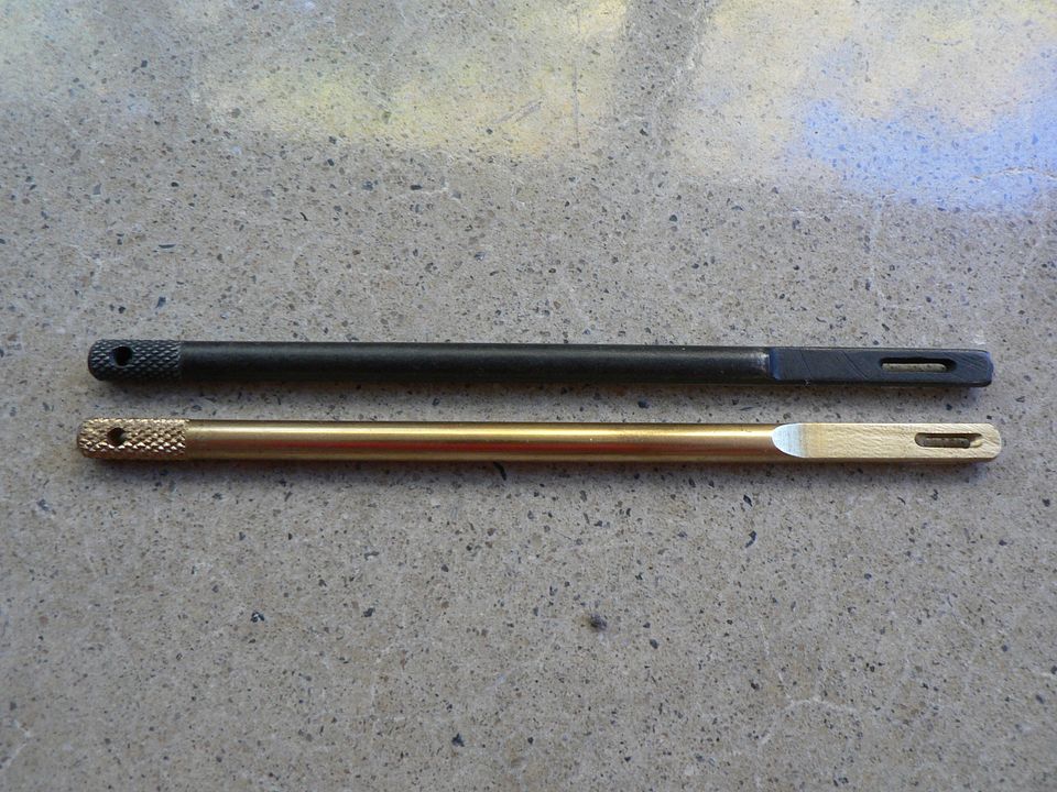

First up are the rods:
The lower one is the first model and it's made of brass. In the provisional manual dated December of 1939 (which strangely doesn't seem to have actually been printed until 1947) they only refer to a brass rod. There is no mention of a steel one. It's not until the March of 1951 First Edition manual that a steel rod is included in the text on page 37 "A cleaning rod, 15cm long, in parkerized soft steel or in brass....".
Here is a detail of the slotted end for the patch:

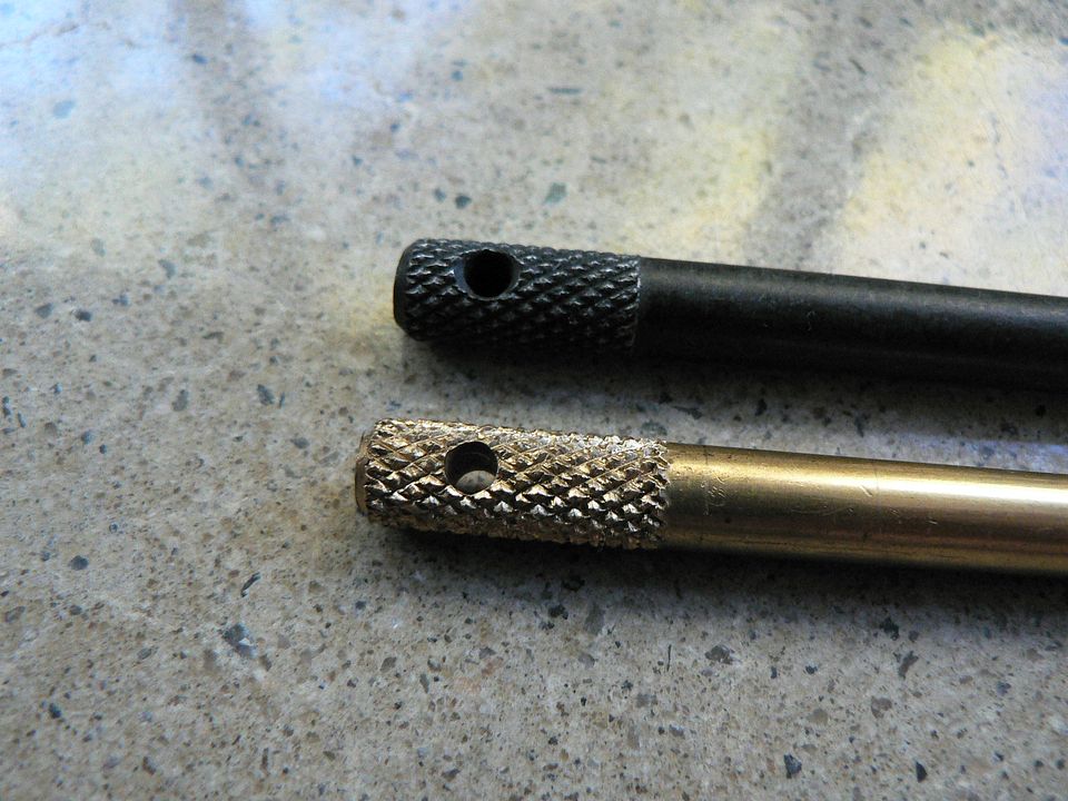

And the handle end which is knurled:
The manual states that the hole is for a string. Why you would attach one is not explained. In my research I've seen slight variation in knurling and slot sizes. I've also seen steel rods that are not drilled for a string and some with a pin punch at the knurled end. Some say that these are also rod variants that were made for the PA 35 ("PA 35" is an French generic term referring to both models of the pistol). That may be but I have found no official documentation of this.

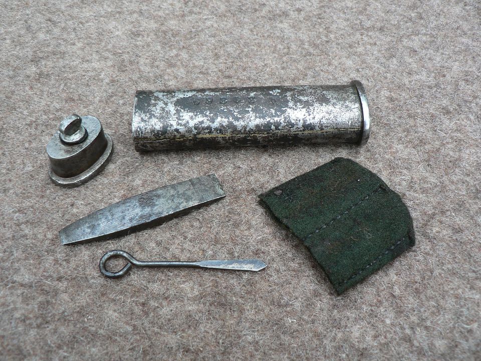

Next are what collectors usually call the "cleaning kit". We're going to be looking at five of them, both marked "PA 1935" and unmarked:
In the 1939 provisional manual text, the kit is simply called the "Complete disassembly and maintenance kit" and is numbered as "2X" to reference it on the fold out illustrations at the end of the manual:
On the nomenclature part of the fold outs, it's not listed at all, only its contents, each with their own number:
2X1 Case
2X2 Double blade screwdriver
2X3 Pin punch
2X4 Articulated brush
On the illustration, it reads, "MAINTENANCE KIT-2X":

First, the illustration shows the bottom of the case as correctly being marked "P.A. 1935". However the writer has incorrectly type "F.A. 1935" in the text.
Second, as noted above, the text reads, "The bottom of the case is marked : F.A. 1935." However, two of the five kits I have are not marked as PA 1935. I have read where one collector states that these unmarked kits were used between the war generically for both rifles and pistols but he provided no documentation of this. Additionally, the articulated brush is kind of short for use in a rifle barrel and there is no provision for attaching it to the Model 1922 pull through issued with each rifle at that time. In fact, the Model 1874 maintenance kit was issued for use with rifles. The 1874 case is the same, but the contents are different as illustrated below:
So, until I find source documents to the contrary, I'm going with the hypothesis that some "Model 2X Maintenance Kits" simply didn't get marked "PA 1935". All of the evidence points to multiple companies producing these kits and variation is not only to be expected but, as we will see in a bit, it was the norm.
