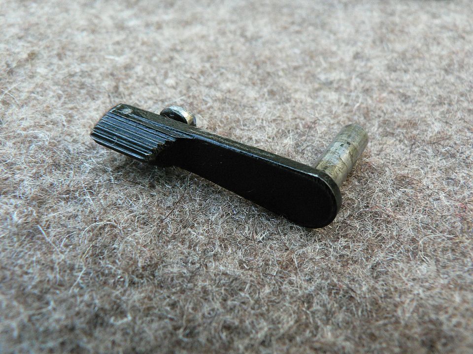

Next up is the slide stop. The one on this example appears to be unmarked. It is painted in the same black paint found on MAS rifles up until just after the war:
Note that the axle is polished for smooth function.
