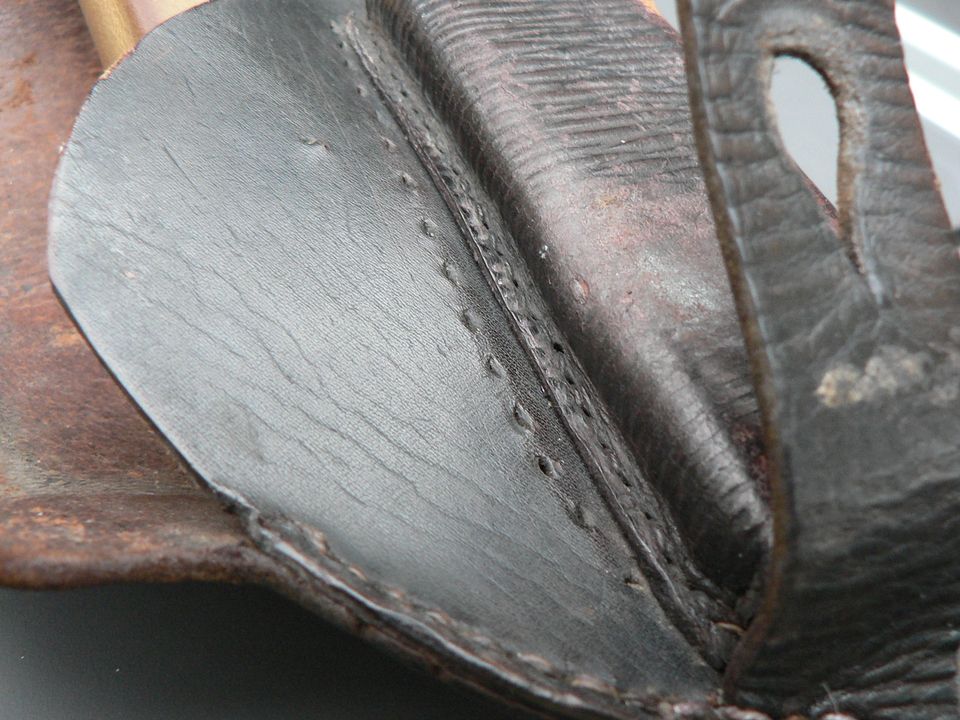

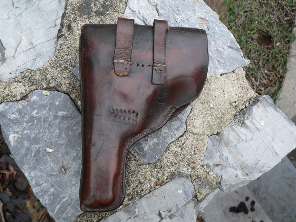

It came in a holster that I cannot identify:
The correct holster would have been a Model 1937. We'll take a look at that and the pictured cleaning kit later:
As you can see by looking at the rear, it's been modified from its original form:
Notice that time has molded the holster to the pistol. You can even see the protruding barrel.
The closure stud is a mystery to me. It is marked on both the front and rear:
The spare magazine pouch was restitched too to perfectly fit a 1935 magazine:
When the pistol is in the holster and the flap is secured, there is a fair amount of space between the rear of the pistol and the flap, leading me to believe that it was originally intended to hold a slightly larger sidearm.

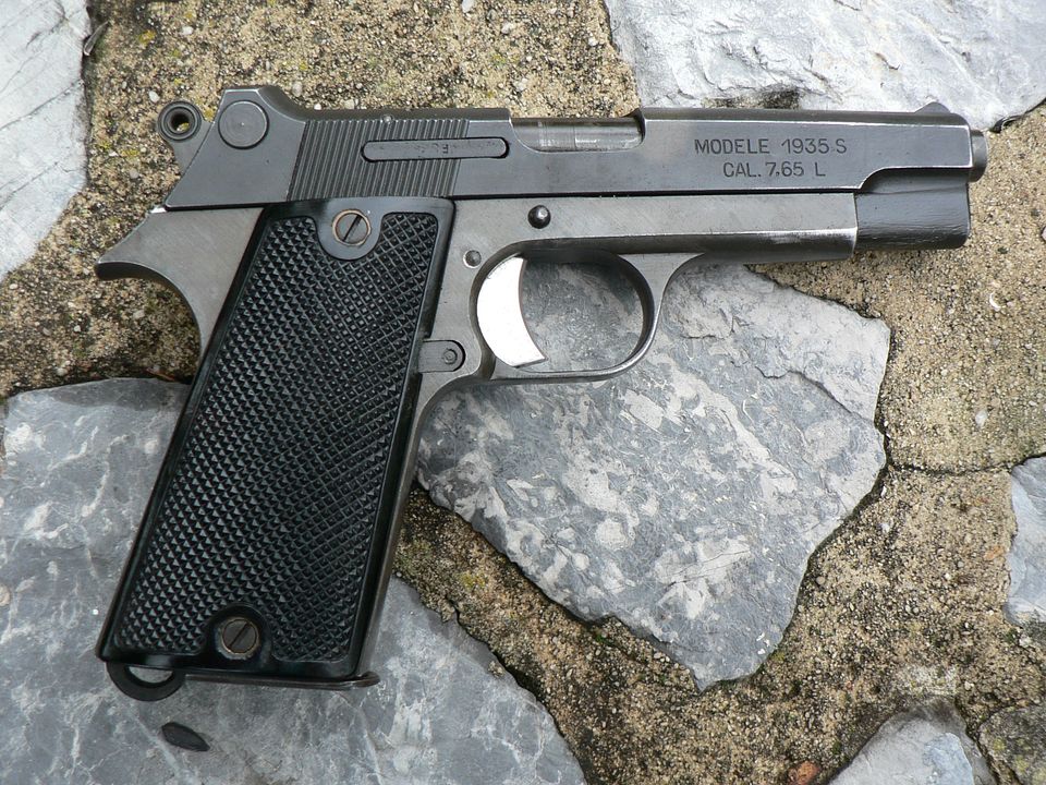

We start with general left and right hand views:
Other than the absent "M1" after the "S", the markings are standard.
Normally, there is a serial number on the frame below the slide markings. Here, it is absent. It is almost a certainty that this mystery will never be solved.

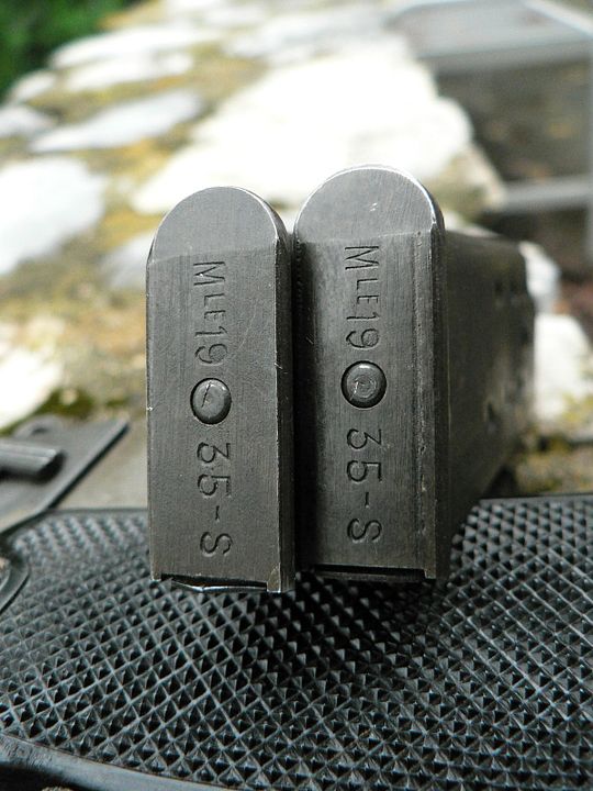

Both magazines are the proper early style with milled floorplates:
The follower and stop plate are different than the later style magazines too. We'll look at them later when we disassemble a magazine.
