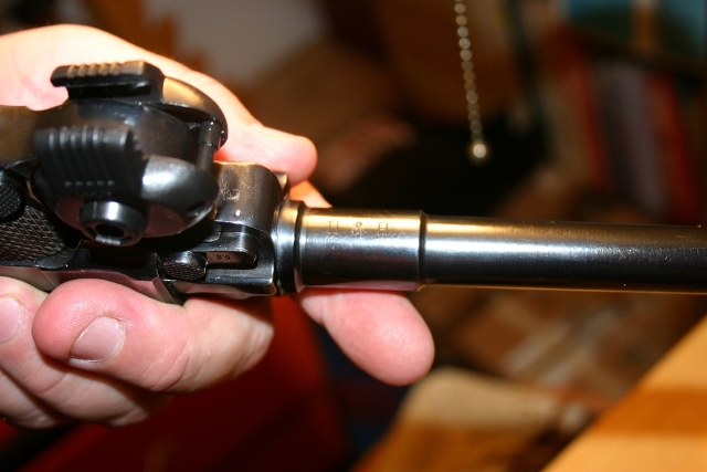

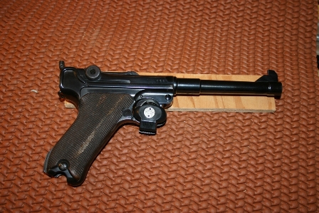

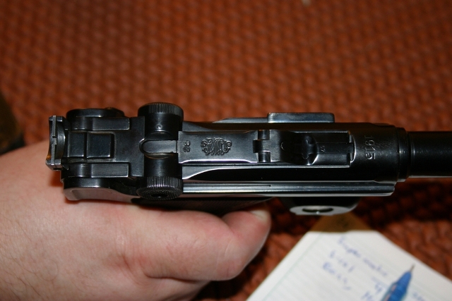

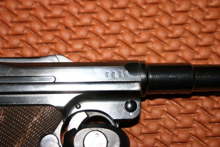

Hello Everyone!
I've been lurking here for awhile trying to learn about Lugers. Well needless to say I now know less than what i thought I knew before i joined. Before I joined i knew nothing about Lugers, now I'm just confused! I've been into milsurps for close to 25 years however i have never gotten "into" Lugers before. It seems to me the most confusing area of collecting that I have been sucked into.
Sparky was finally able to get his hands on the H&H Luger. I am uploading (I hope if all goes well!!) some pictures on his behalf. Any more information or confirmation of the above info would be greatly appreciated.
I will also shortly post the Artillery Luger rig I picked up when Sparky got this one. As etiquette, should i jus tpost in the Artillery Luger forum? It's pretty complete: Arty Luger, leather holster, wooden stock, drum magazine c/w cover. Yes I am happy!
Thanks in advance for the help guys.
Alamar
http://forum.lugerforum.com/lfupload/sparky205.jpg
http://forum.lugerforum.com/lfupload/sparky206.jpg
http://forum.lugerforum.com/lfupload/sparky207.jpg
http://forum.lugerforum.com/lfupload/sparky208.jpg:confused: :confused:
Ron Smith 12-06-2005 10:52 PM
Yo Sparky,
That's a pretty heavy duty looking Luger. It is a custom job all the way through. Someone has coverted it to a pure target pistol. Is it a .30 or a 9MM?
Sorry to say that it has little collector value, but is very interesting. I'll bet it shoots pretty good. The barrel looks like a section out of a Mauser stepped rifle barrel.
