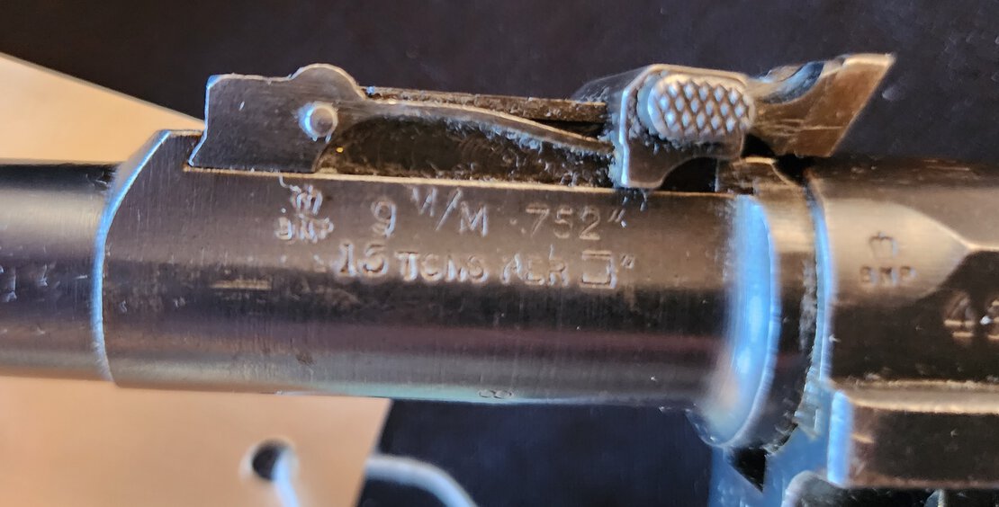

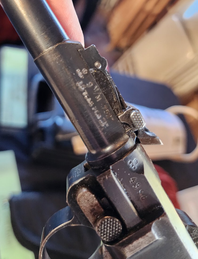

What is this stamp on the barrel? Im guessing its a British capture stamp. If it is, does such a stamp enhance the value? Your comments are appreciated.
Deputywood 11-23-2023 10:08 AM
Not a capture stamp. It's a British proof stamp required of every firearm in England. There should be several more and the frame. A search of British proof marks can give you more info. As enhancing value, I'll leave that to others with more experience.
Woody
G41M 11-23-2023 10:43 AM
Birmingham Nitro Proof. Not a capture stamp. As I understand, pistols sold (after 1955) thru the UK needed this proof to be sold or exported. My observation has been it does not raise the value of the gun, but it does seem to slow the sale. My opinion is diehard collectors would pass, waiting for a clean example.

Woody, what G41M said! Good shooter at the right price. In my worthless opinion, the only Luger that's desirable that has British proofs is the VICKERS LTD.

What Jack and GM41 said, absolutely agree.

Apples and oranges as to P08 vs 1911 with British proofs. U.S. Lend lease 1911 with British proofs has its place in a couple ways for collectability. P08 with Bristish proofs not Lend lease and applied later in time because it went to that country. This makes it unappealing for collecting to me. Nice 1911 by the way. Tally Ho!
P.S. I like the LP08 also, just the British proof, not so much.

The largest number of LP08's were produced in 1917 and they are quite common. As stated above, the British proofs would have led me away from it, but, to each their own. Decent 1917's can be had for around that or less without the proofs. To me the redeeming factor here would have been to see it in hand.
