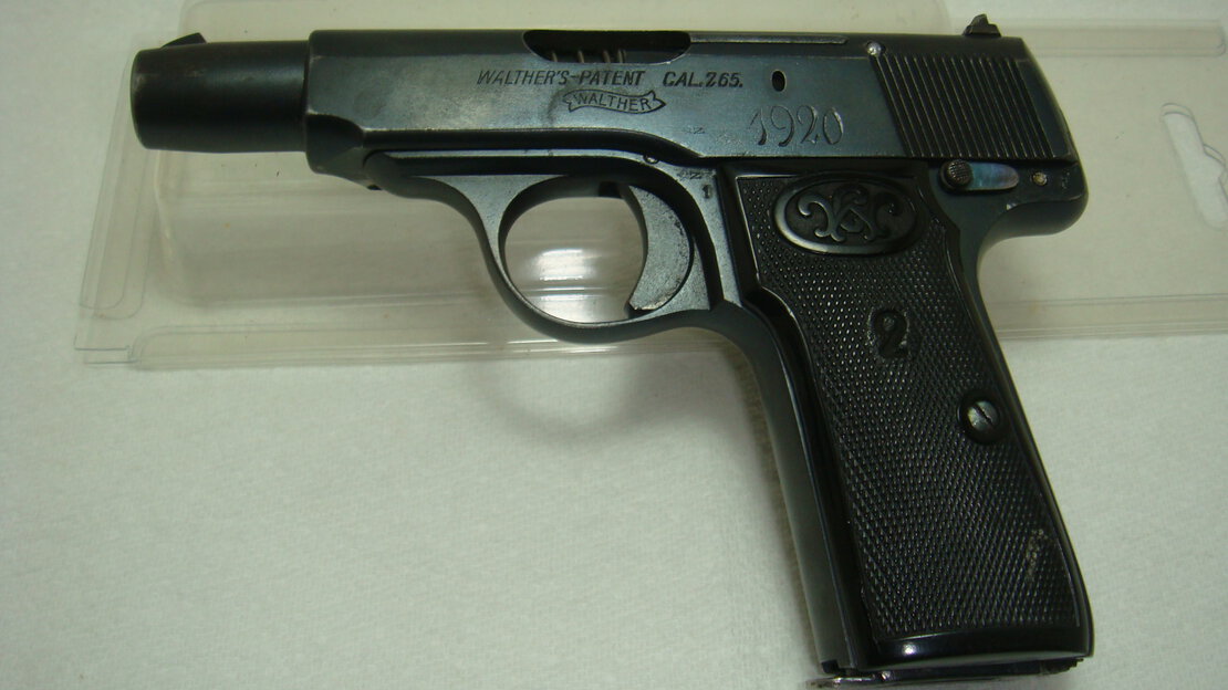

aldo35 02-02-2022 08:45 PM
!920 Stampings
1 Attachment(s)
I had a Walther Model 4 veteran bring back with the 1920 stamping and a # 2 burnt into the left grip. The vet's unit took Zella Mehlis and collected weapons. The comment at the time was everyone in town had a pistol and there were four firearms factories.Attachment 84723
Lugerdoc 02-03-2022 12:54 PM
The "1920" marking on your M4 Walther indicates that it was in the inventory of the German Army in 1920. I believe that you also have an Imperial Crown over a letter, just above the 1920, which indicates Army acceptance in the WW1 era. TH
