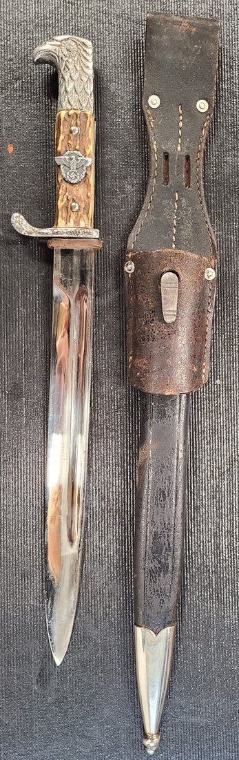

I know very little about Nazi era bayonets and would appreciate the forum's help in indentifying this bayonet. From my best guess it appears to be a Nazi era police dress bayonet. Is it? The more important question is it genuine or a repo? Any help will be appreciated. :typing:Attachment 81748

Dang junk that shows up here! You better send it to me...I need an example of a fake police dagger...But then this may not be fake. Looks awful real to me. I suppose you got it free in some gun trade?
gunnertwo 01-16-2021 09:38 PM
I can't recall ever seeing any fake police bayonets. Yours is the short version and I didn't see any police unit markings. Judging by the condition I would say it's closer to war time production, not pre war. Pre war were normally longer and had ID markings for the city or district. Puma is a known maker.

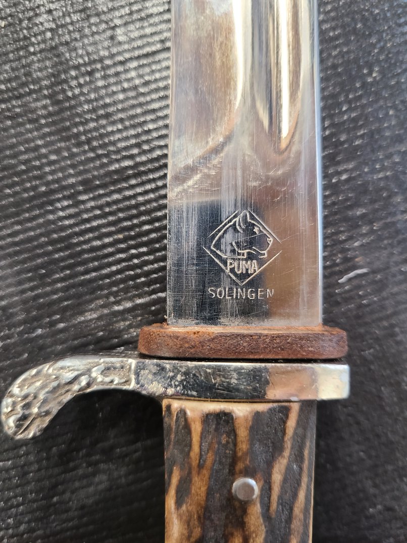

I would have to say repo IMO ... the PUMA logo is off.
https://i.imgur.com/r1cvlCQ.jpg

I can't recall ever seeing any fake police bayonets.I have seen plenty..look and you will find. This one isn't fake though. The fakes are really cheap looking. Plastic stag grips and too shiny chrome..Light too. There isn't to much made from that era that wasn't very high quality. Anything made after 1945 is junk and it shows.
Late war they made these with wooden grips that LOOKED like stag!
Greg, your Puma mark isn't on a late war Police bayo...

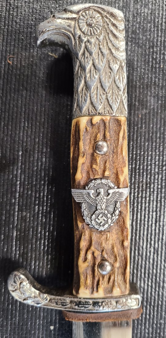

Take a close look at the rivets holding on the handle. Classic German. Look closely at the Police medallion..detail.
The medallion is set into the stag flat & rock solid. beautiful craftsmanship.
Of course one would like to hold it in hand but logo's change over time. Not always a good indicator but quality of build is. Then there is the late war metal finish. Almost gone on the topside. It was a fairly cheap silver wash that didn't age well on zink. Hard to fake that kind of patina!

Greg, I admit there are small inconsistencies in the Police blade logo. Those don't make the dagger fake. Or the logo. It's just different.
spangy 01-16-2021 11:39 PM
Well after an exhaustive search I have found an almost exact bayonet to Eugene's ... thank god.
Down to the logo even ... and by that i mean a puma within an uncompleted square.
https://stewartsmilitaryantiques.com...92.archive.htm
I think your bayonet is real Don. :order:;)

Jerry, I found it at a small gun show about five or six years ago. The vendor at the table claimed it was authentic. I wanted it but thought it was a repo since it was marked “Puma” and I had some Puma tennis shorts or shoes in the 70’s. Duh?! I reasoned that they couldn’t have made bayonets or daggers. Also, it had no slot for a lug and was very light weight, so I just thought it was made in Taiwan or something. G2, As you noted there are no unit or other markings on the frog or bayonet. Is my ignorance showing yet? Well, that worked for me at the time as I got it at much lower price than he was asking.
When I got home I immediately began doing some online research and could not find a Puma bayonet maker or any similar bayonet that had the same eagle eyes, beak or feather design. Now I thought I nothing more than overpriced repo. Ugh. My notion was reinforced when during the next four or five years that I attended the SOS in Louisville and could not find a single Nazi era bayonet that was made by Puma. Zero! I brought photos of my bayonet with me and I never found a Puma or an eagle head that looked identical. Even the police bayonets that I did see seemed to be a much high quality of manufacture. Perhaps they were prewar or early war made.

Spangy, thanks so much for that link that actually showed an identical one and the sold price. I no longer think I have a fake. You made my day, buddy!
