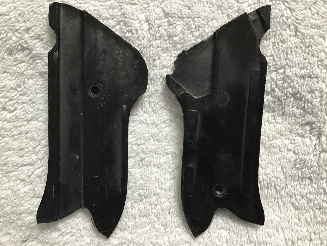

These are off of my sons byf 41 Luger shown on another thread. NOT a” Black Widow”, as I’ve learned. Sorry for my ignorant remark. Just trying to determine if they’re original. Without tearing the weapon down, all numbers that I can see match, “2703”, with “03” appearing everywhere I can see.
Attachment 75960
mrerick 03-02-2019 04:58 PM
Are the holes threaded. Threaded is good.
Take a paperclip, and heat the end of it. See if it will melt the inside surface of the grip. Melting is bad.
If they are threaded, and it doesn't melt they are likely original.
The grip types are pictured at this thread on Jan Still's forum:
http://luger.gunboards.com/showthrea...bakelite+grips
Yours resemble type 5 or 6 grips.
45acp230 03-02-2019 07:24 PM
Mrerick, thanks! Holes are threaded. Meant to put that in, but my little ole pea brain... I’ Try the heated pin. Thank you,sir. Hank.
