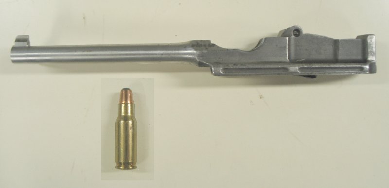

I already did such a project, based on a Mauser C96. I used a shortened RCBS .223 Remington die set to form .223 Remington brass to ~1.000 (C96 30 cal length). I used a Clymer 256 Win Mag chambering reamer with a .25 cal barrel blank threaded to fit a cut-back C96 barrel extension. I posted a pic of the resulting mongrel some time back. It originally had a quite long barrel, but I shortened it to ~C96 length eventually. I still have the complete barrel/extension here somewhere (pic below).
It worked out very well, but I could not interest any of my then-buddies in it. They all wanted big bore magnums. :(
I still have my reloading notes, along with a couple hundred leftover bullets. I called it a 256 Cal Mauser. :evilgrin:
Couldn't find the pic of the assembled 256 long-barrel C96...Just the barreled extension...And a pic of the shortened 256 Mauser barreled extension, with a pic (shown enlarged) of the '256 Mauser' cartridge...
http://forum.lugerforum.com/attachme...1&d=1235250288

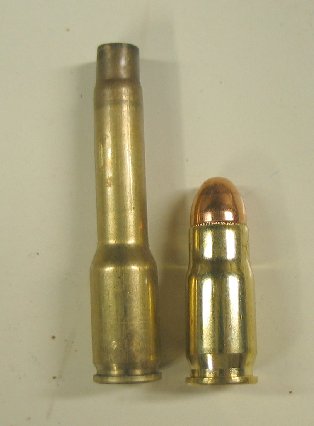

2 Attachment(s)
I still have some of the test cases I used for a similar project...The loaded cartridge on the far right is a Fiocchi 30 Luger cartridge for comparison...
These were 5.56 cases, I didn't care if they were trashed...But they extruded quite well to the smaller diameter neck... :)
The one closest to a 30 Luger case would be acceptable... :D

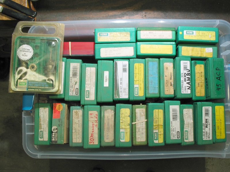

sheepherder 03-02-2019 09:48 PM
1 Attachment(s)
I checked my box of die sets and lo & behold I have a spare set of .223 Remington dies! :eek:
They're in a soft plastic rack container, and that is something I would never buy. Either I got it with an AR-15 long ago, or someone gave it to me... :confused:
I much prefer the green hard case boxes. :)
Now to find a Luger barrel extension... :rolleyes:

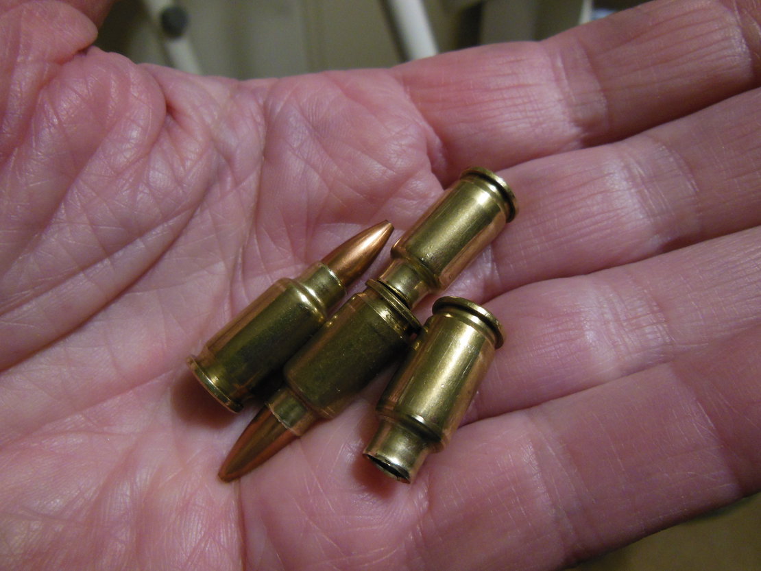

I tried a piece of Privi 223 brass tonight cut off with a tubing cutter to about 0.9" figuring I would lose some length going down to 22. I have used this brass in 22 hornet for a 22 squirrel Smith Wesson revolver, sure worked nice; so tried the brand again for this.
I used the old Lee bushing die again, but with more common sense. I could mimic the original angle of the 30 Luger more closely if I paid attention for once. I used the basic Lee bushing die without bushing first to knock the front down just a little. Then went to 308, 276, 255. The reworked 223 Privi brass did ok, looked more it shoulda. Always have to relearn something..........
As expected in going down to 22 caliber, the neck walls are super thick. After the 255 bushing, I tried seating a 224 bullet, and stopped before I killed it. So I ran a 224 inside expander on it, and the case with a loaded bullet ballooned to 266.
So one could always inside neck ream, but that puts variables on the brand/lot of brass. One could consider inside expanding and then neck turn, which of course, would be consistent without the brass thickness variables.
The 266 is pretty big for a 22, but guess custom reamer is a custom reamer, no extra cost for a unique neck size bore. neck/lead reamers are out there too, but probably be custom? not knowem right now.
I don't have any practical experience with a cut off 222 die set, especially that much cut off. The 222 has some angle to its sides, so the tighter it gets as you cut off. Of course, you know all of this stuff, just thinking out loud here. The super or Largo brass is thnner fwiw.
The 223 brass for a 22/30 Luger wildcat will work, but the resultant neck walls are there to be handled somehow, one way or another.
My trial case with 223 looks much nicer with the better technique tonight, feeds in a Luger magazine ok. So tis a start.

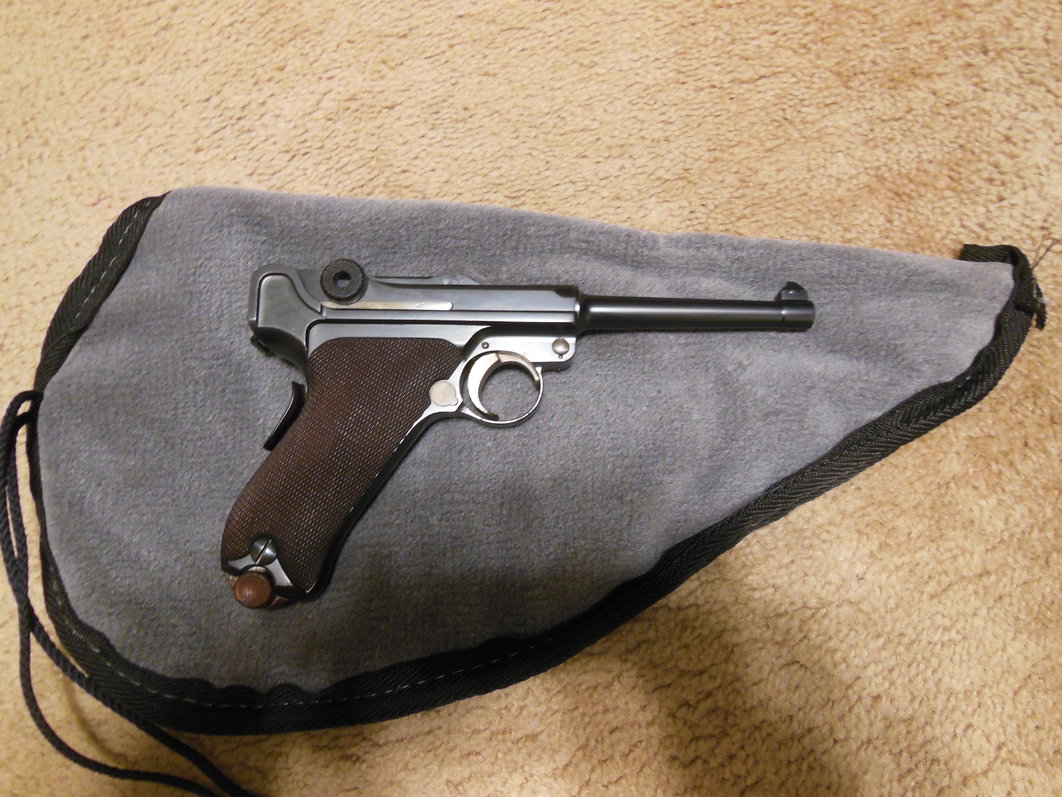

Rick W. 03-04-2019 09:17 PM
1 Attachment(s)
The 22/30 Luger or thereabouts has always been one of the fires in the distance here. It gets tended to, then forgotten, etc etc. I like a Luger that shoots flat and is...............different, catered to me, the dreamer. Even considered 6mm and 25cal off the 30 Luger or a close clone.
To experience something I read about as a kid growing up in the gun rags, tis always on the mind; only way for me to do it........is to do it myself.
I am still crawdaddying around between a 223 A.I. reamer and cut off dies(A.I. has less body taper to effect the cut off sizing, versus the 40 degree shoulder; or just bite the bullet and buy the custom ground reamer from PTG and make my own dies. I have a little fear of the body taper of the cutoff used old dies routine. I may chamber up some scrap to 222 or 223 and see how the taper plays sometime. Not been able to do much lately, so it lingers on the mind.
The 22 Luger, Lowenstein, 22/30Luger just necks to 22 cal, and keeps the angle the same, hence the slightly shorter neck. I would like to keep the longer neck of the parent, but changes have to occur in the basics.
I have a nightie that the lighter the barrel, the better chance for function without going abbynormal in pressures/bullet weight. Hence my talk about certain tapers.
I have the barrel takeoff's here in the corner, but one has to have a plan I have been told. I have blasted off on pure conjecture and the result was most times about that, so gotta get the plan together. The chambering is the key item to me right now, how to.......
I have a lot of barrels with the more slender taper, all homebrew, made on my old Atlas lathe. I have two tailstocks, one for nice/nice and one for offset tapering, and the bed is long enough for both to reside during tapering.
I am hesitant to show this old mule some, but here it is. This is a Luger that I shoot regularly, a 7.65x19 wildcat(30/9mmx19 or 7.65x19 as ESKO called it). Shoots well and the various parts/additions like the stainless toggle in the 18 receiver and scope mount plays. Iron sight on front is simplistic, to me only for a bit of look, I always use the scope or red dot with this one.
Barrel is now..........10" or so..........650 to 450 nominally. Was a 14" or so earlier in life, but change comes and goes here.
Some things are never done. Some barrels remain lathe turned without any polishing for years, I always think I will change out. You will notice the thicker shoulder on this one, gives me room to rechamber/reuse. I can make a 55 gal drum failly nervous at 10 yards with it..........
