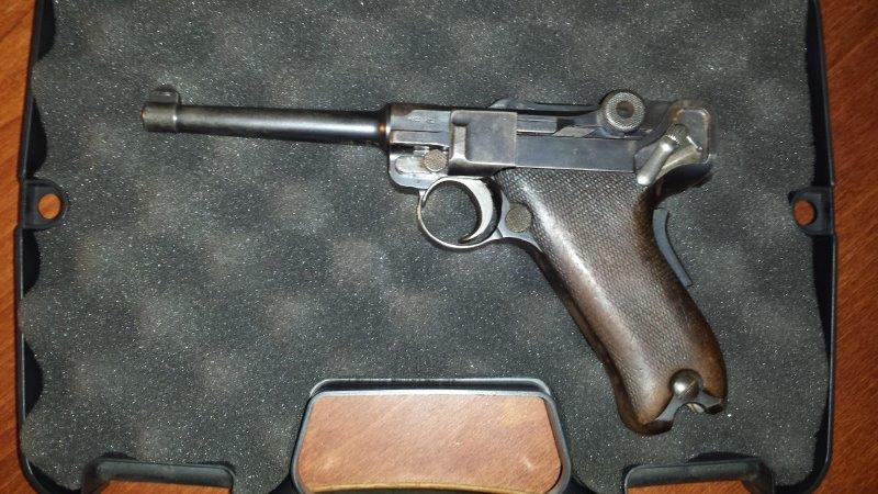

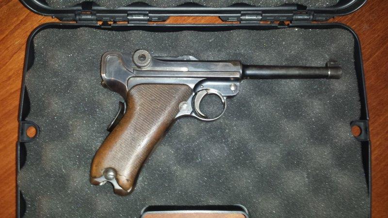

Hello, newbie here! :bigbye: Was on another forum posting about my luger and they advised I post with you guys for better, more accurate, and more in-depth responses. Your guy's site is amazing! I've already answered a few questions just from this sites archive. A few still remain, was hoping to get your thoughts on it. Thank you in advance!
Original post on calguns.net click the following title to see full post and responses. Luger Pics: How to Identify, Restore, Date, Shoot.
Here's the posting for your review/discussion/enjoyment

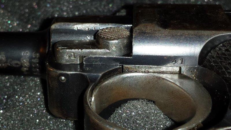

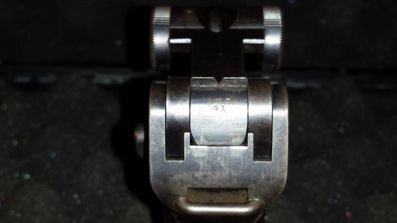

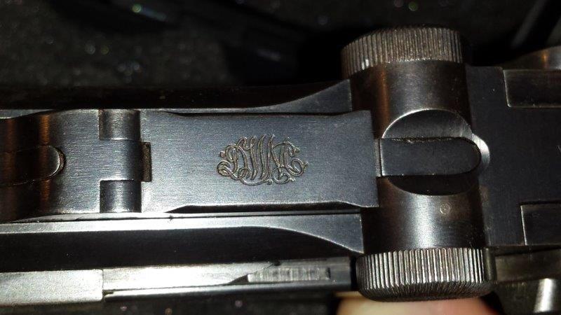

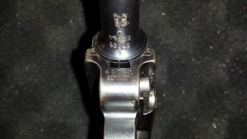

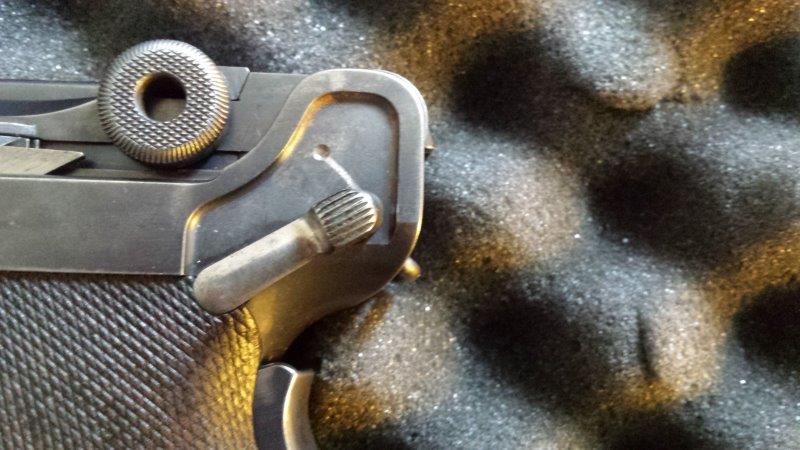

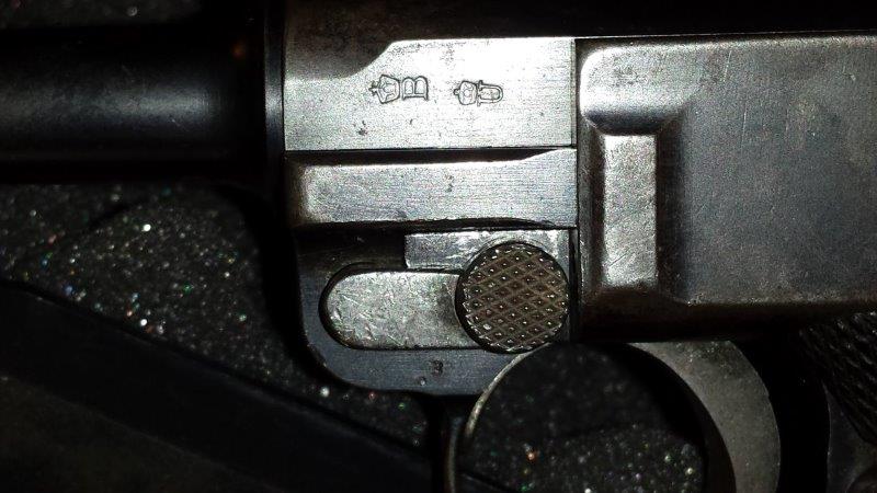

Hi there peoples! I have a luger that I'd like to get all your thoughts on. I've been researching it for awhile and it's starting to make my head spin. Far as I've gathered I believe this is a pre 1912 Commercial DWM Luger. But still can't figure out a few mysteries about it. So I wanted to post a bunch of pictures for enjoyment and possible discussion.
Is it possible to get a more accurate date? Believe 1906

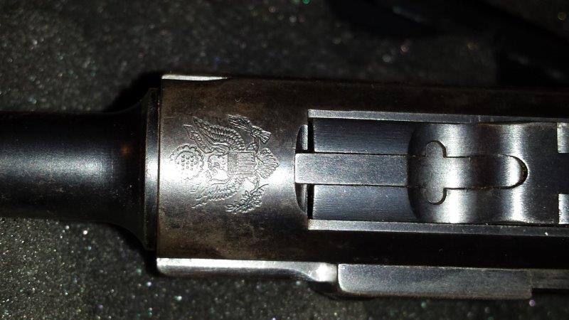

What does the Eagle mean for the gun on the top? American/England import?
What does the 17228 stand for on the barrel? 7.65 mm
What does the B with the circle around it on the barrel stand for? Brazilian mark I think
What does the "3" directly in front of the trigger stand for?????
What would I use and how would I safely clean/restore this piece of history? Will be doing as little as possible.
Is there a way to find out or test if this is safe to shoot without harming myself or the gun? Will not be shooting this.
I would love to have this cleaned up and restored as much as possible so I can display it in my office and maybe one day give it to my kids. Here are some pics and a link to the full blown pics for review. Will probably only wipe it down with oil and put it away.
Full Sized Zoomable Luger Pics
Attachment 61087
Attachment 61088
Attachment 61089
Attachment 61090
Attachment 61091
Nubbynub 08-28-2016 03:06 PM
7 Attachment(s)
More Pics
Attachment 61092
Attachment 61093
Attachment 61094
Attachment 61095
Attachment 61096
Attachment 61097
Attachment 61098

Edward Tinker 08-28-2016 06:26 PM
as Don said above, but I read your posting on calguns (not a member) and apologize for your difficulty on coming on-board.
anyway, let me throw out some info
Original lugers were in the 1900 (dished toggles) design, then went to the 1906 design (military did not want the grip safety, so it went away, along with changing them to 9mm)
* it is a 1906 'model' - I think the sn was 40K? - will go look, probably 1910, 1911 - Dwight has a better idea :)
*Your is a 7.65mm (30 Luger) - magazines will work for the guns in either caliber
*The American eagle (AE) was a marketing ploy for the USA, although the importer (Tauscher in New York) imported them for Canada and for Mexico also, but without the AE -Same, simply the eagle, otherwise no change from a non-eagle
*the bore-to-bore marking is like you said; 171xxx and actually isn't bore to bore, for the 30 lugr it was how many to a pound, like a black powder (I will have to look that one up in the FAQ)
* B WAS for Brazil, it was an over-run of barrels and they simply used them - no other reason than using extra parts from another contract
*numbers covered up by parts are referred to as 'worker marks' and mean nothing except to show who was working on it or had worked on it
*Normal cleaning such as oil and 0000 steel or bronze wool work great, never ever over clean. Less is best, so a rag and oil
*this is a commercial version, and the last two of the serial number are on the bottoms or not on parts. Military versions the sn are in the open, we call that commercial or hidden serial numbers.
*see the BUG proof markings - that is simply the inspector markings - each acceptance - proof (totally different things) - so someone assigned the letter B accepted it as good to part at that stage - then U - although maybe not in that order, the final FIRING proof is the PROOF EAGLE and showwed it passed the test firing of an over-proof load and was good to go.
* NOTE the GERMANY stamping -this is technically an EXPORT stamping and not what many folks call an import stamp, it was required that items be stamped as country of origin.
--do not dismantle more than a basic cleaning IMHO
hope that helped, that is from the top of my head...

mrerick 08-28-2016 10:14 PM
Hello, and welcome to the forum.
As the others have said, anything you do beyond simple cleaning to "improve" your new Luger will destroy it's collector value and financial value as well.
In answer to your specific questions:
AS Ed and Don mentioned, this is a 1906 pattern Luger. I don't know of available production records from DWM that would nail down exactly when it was made. By 1918 they had reached serial numbers in the 82000 range.
As mentioned, this model is an "American Eagle" model that was made for export to the USA.
As mentioned, it represents the barrel caliber. You are correct.
I also go with Ed's explanation on this as a barrel for the Brazilian Lugers that went into American Eagle production instead. I was also thinking Boehler steel, but those are marked "Bo."...
It does look like a worker mark, but it would be very unusual for them to be placed in a visible location. I don't have a better explanation.
Well oiled "0000" steel wool on an oiled blued steel surface to remove active surface rust. Basically clean it with Hoppes No. 8, oil it properly and that's it.
I personally would not shoot a historic and collectible firearm. The way to find out is to have it gone over by someone familiar with Lugers, and then load it and fire it. Be prepared for parts that might break, ending it's history as an all matching gun. Of course, there are those that must shoot everything they own. To each their own.

Dwight Gruber 08-29-2016 03:31 AM
"Is it possible to get a more accurate date?"
This Luger is properly designated New Model Parabellum, of the standard commercial Parabellum category; this model began production in 1906. It is the American Eagle variation.
The Pistole 1908 (P08) commercial model began production in 1909, serial number approximately sn 39063. Production of the commercial P08 is intermixed with the New Model Parabellum, which ceased production in 1913. The DWM commercial proof mark changed from the crown/B,U,G suite of markings to the lazy crown/N marking in 1912,as early as sn 51000. This dates your Luger between 1909 and 1912, there is not a way to pin it down further.
"What does the B with the circle around it on the barrel stand for?"
Conventional Wisdom ascribes the encircled-B on the barrel as leftover or overrun barrels accepted for the Brazilian Luger military contract. Brazilian Lugers do not actually have this stamping on their barrels which leaves this as unconfirmed speculation, subject to future factual discovery.
"What does the "3" directly in front of the trigger stand for?????"
This is not a known standard marking on this (or any) model Luger pistol. Any attempt at explanation would be sheer guesswork.
Lugerdoc 08-29-2016 09:02 AM
I agree with most of the above, except the crown over B, U & G are PROOF markings, not inspector markings. The B in a circle on the barrel, could very well be an inspector's mark, as DWM often recycled dies previous used on contract pistols, to be later used by inspectors. 'Waste not, want not". TH
