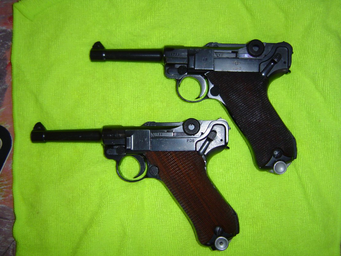

kurusu 04-27-2016 04:04 AM
1 Attachment(s)
Originally Posted by DonVoigt (Post 287684)
Kurusu,
remind everyone how many rounds you do shoot!:eek:
(Way more than most of us, I would think.):D
Around a 1000 to 2000 a year. :o
And my only problem, so far, was the broken breech block mentioned above (and that was my fault).
It's also true that I generally remove the holdopen when shooting.
But it's also true that with bad luck you can get something broken on the very first shot. Remember they have been around for a while.
Just to illustrate bad luck and not Luger related. When I bought a brand new .32 kit for my hammerli 280 I had a leg of the breech block broken after a total of 150 shots fired using only factory ammo. Hammerli sent a replacement in a few days at no cost.
Attachment 58470

kurusu 05-01-2016 07:46 PM
1 Attachment(s)
My shooters:
On top a 1938 S/42 on the bottom a 41 BYF.
Attachment 58609
