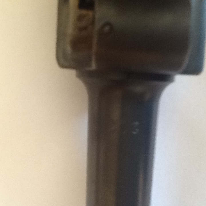

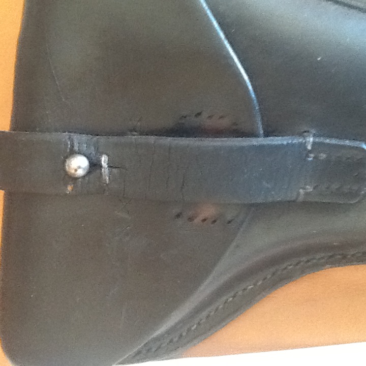

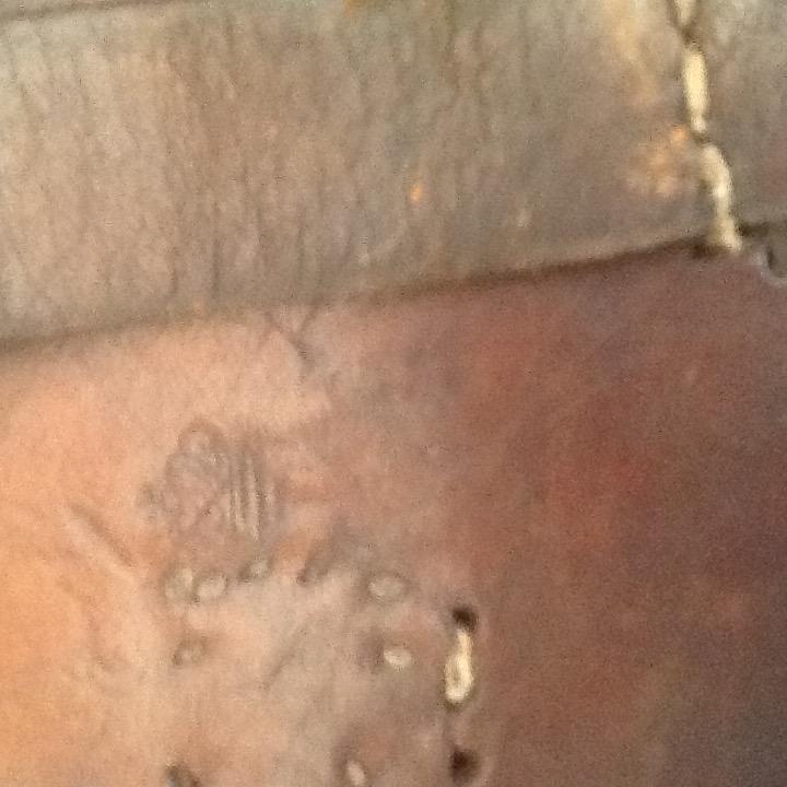

As Requested here are some not so great pics, but coupled with the description given might work. The letter under the matching serial number on the bbl seems to be a stylized a.
Thanks for any help[ATTACH][ATTACH][ATTACH][ATTACH][ATTACH]Attachment 58393

Bruce, I'm afraid these photos don't help much. I'm guessing that the serial number on the front of the frame (not necessarily the barrel) is 213 with possibly a lower-case script "a" suffix beneath it. The front of the frame is the only location certain to have the full serial number with suffix. If 213 is correct, the holster is matched to the gun.

Thanks, and yes the pics were not great quality. The answer re the holster is perfect and I thank you. The entire rig is serial numbered correctly and yes the serial number on the gun is 213 and a small (what appears to be) a stylized.

It is a bit difficult to tell for sure but I think the holster may be a converted LP08 holster. There appears to be evidence that a stock attachment block was removed from between the belt loops. Is there a double row of stitching holes down the front of the holster where a cleaning rod sheath was removed? If it is indeed a converted arty holster, probably the closure strap is original and only the stud needed to be added. Also, the marking on the back is not a Crown Anchor but rather a Crown/I (First Bavarian Corp).

I agree with Ron. Also, there is no evidence on the front that there ever was a diagonal closure strap and buckle attached.

Thanks. Yes there is a double row of stitching on the front flap. The holster was made by Hans Romer Neu-Ulm and is dated 1918 Definitively not a reproduction. The marking on the back is as you say probably a Crown I. The back of the holster is serialized 213 (the same as the gun).
