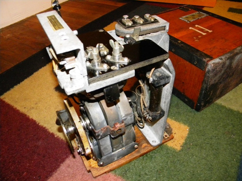

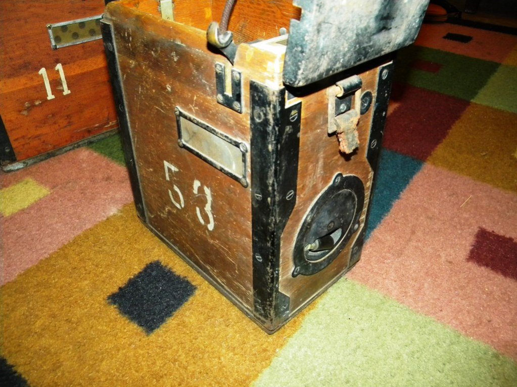

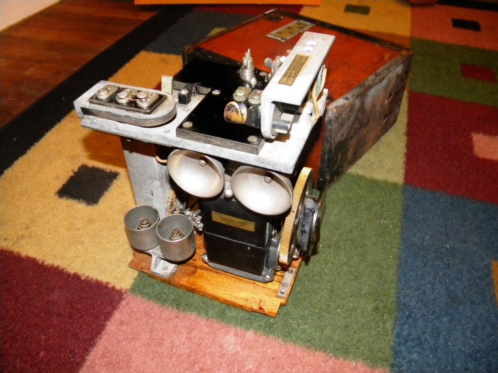

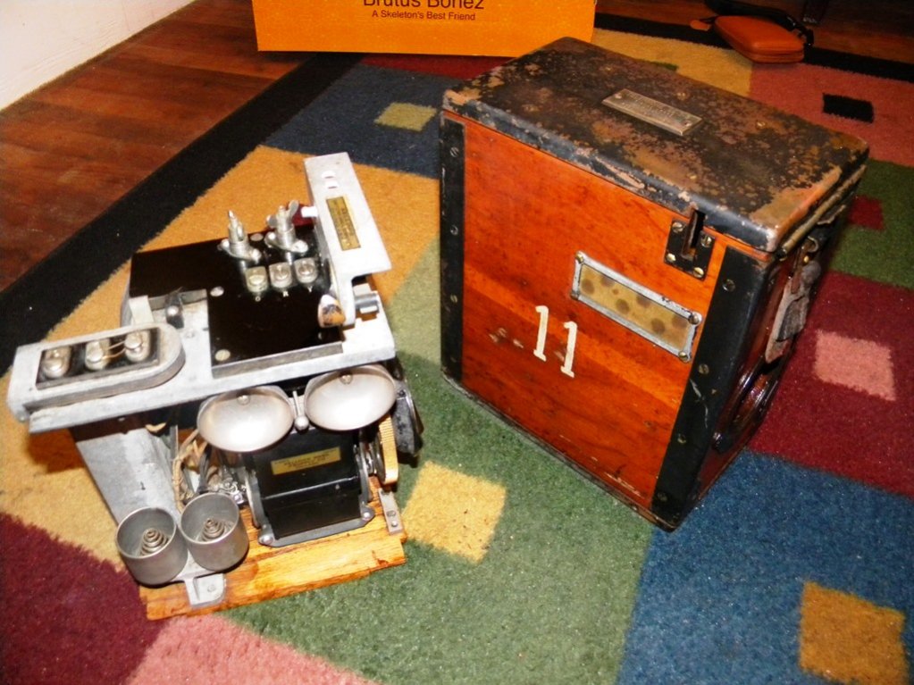

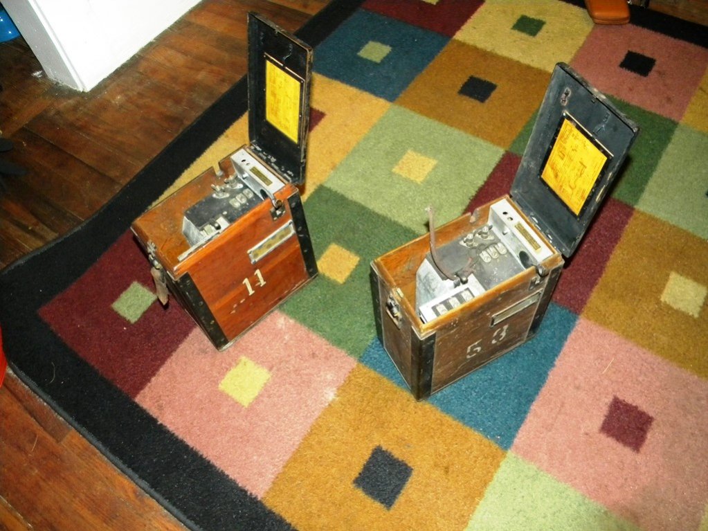

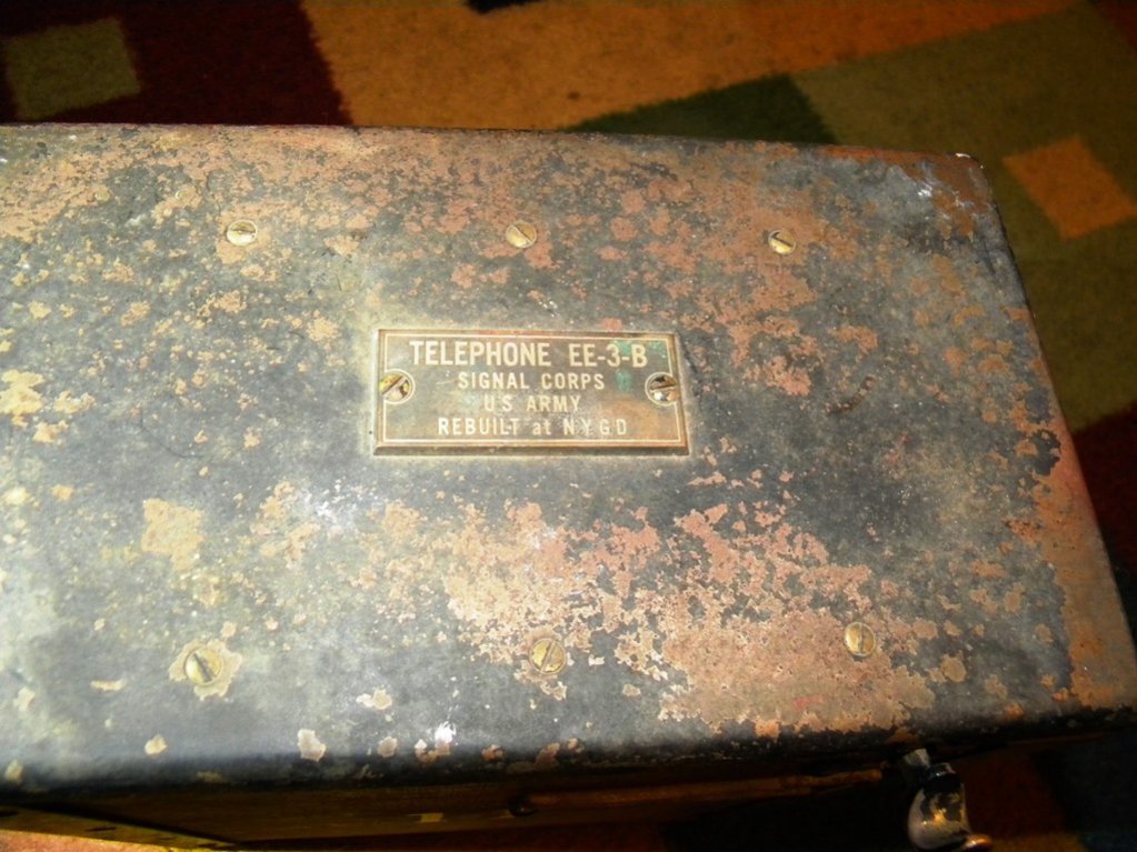

I recently ran across (2) old U.S. Army field, crank style telephone. I have been online trying to find out more information on these phones. But very little information on this version "EE-3-B". I can find plenty on the EE-8-B phone that was used during WWII.
From what I have ran across with this version is that it dates back closer to WWI. They have the wooden casing around the main parts on the inside, unlike the EE-8-B which has a leather style casing from what I can see.
The cranks on them both spin perfectly. I pulled one of them out of the casing and cleaned it up a little and added a little 3:1 oil on the crank bearings which made it spin very smoothly.
I just wanted to share the photos and see if anyone on the forum can give me any more information on these phones.
I live in Augusta, GA, where Fort Gordon is located. This fort has a big signal corp that is part of the base. The person that I ran across that had these did have no desire to have anything to do with them. They were his grandfathers who passed away recently. His grandfather was a Lt. Col. in the army and initially enlisted in 1950. I also got a stack of old paperwork that appeared to be from his training back in the 50's. In the paper work was a bunch of maps that looked like re-prints from WWII in Germany and France which I thought were pretty interesting as well.
Who love to see what else he had that was his grandfathers and wanted to part with, before it just gets lost, sold or ends up in a pawn shop. Which is sad to say. I got a steal on the phones and paper work. Ebay has (2) of these kind of phones for $325. But they did have the phone receiver which I do not have.
So any information on the phones that anyone can provide would be greatly appreciated.

mrerick 11-01-2015 10:28 AM
Those are WW-I vintage! Here's a photo of a complete one:
http://radionerds.com/index.php/EE-3
http://radionerds.com/images/d/dd/EE...51771009_l.jpg
Also, photos and links at:
http://www.myinsulators.com/commokid...taryphones.htm
Article:
http://www.usmilitariaforum.com/foru...-field-phones/
Use care... those Kellogg magnetos can really bite!

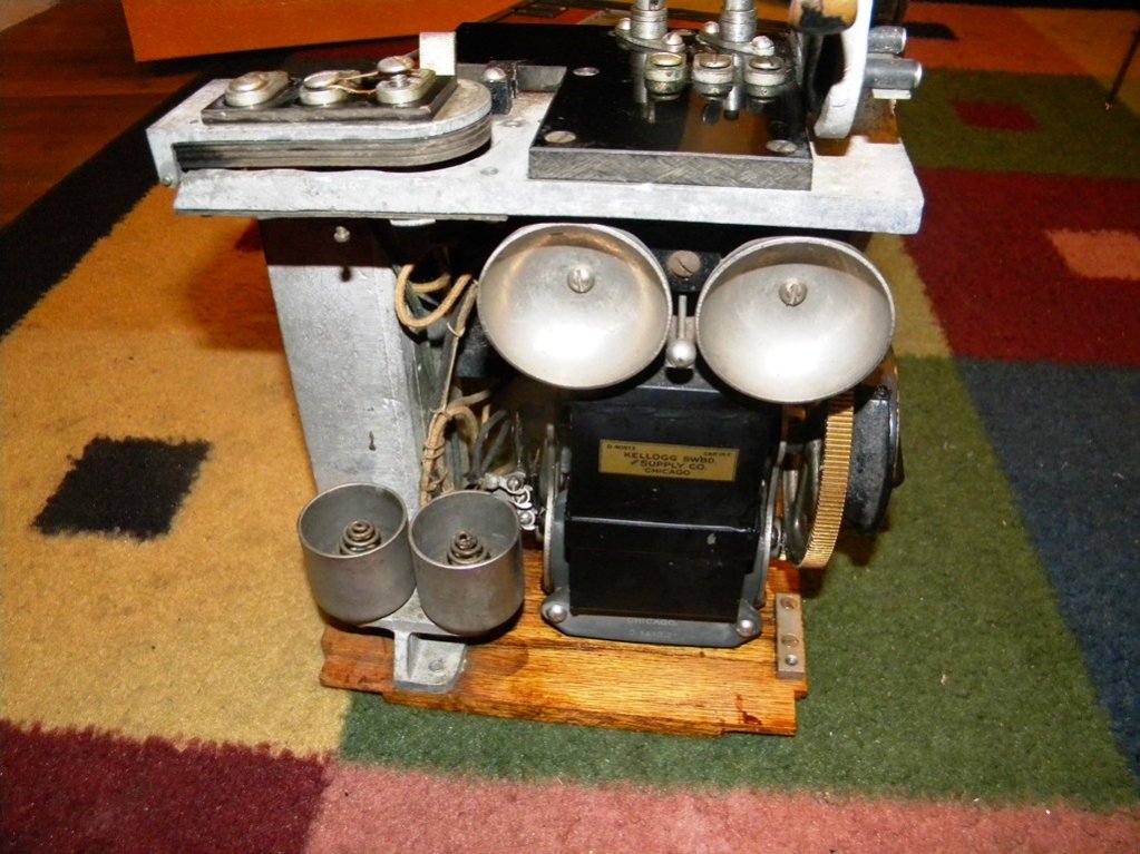

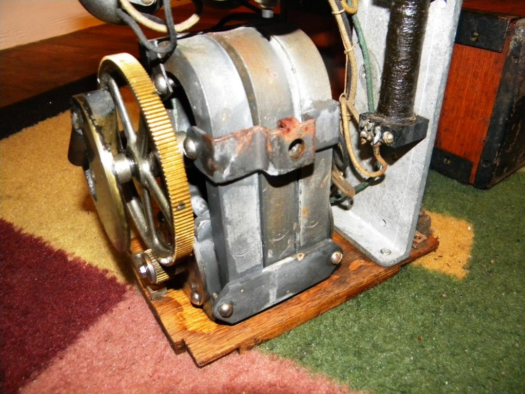

I'm curious, what are the magnetos? Are they the (3) horseshoe shaped, I'm guessing magnets on the inside? Would they only be energized if the batteries are in?
mrerick 11-01-2015 08:51 PM
The magneto in these phones is basically an AC generator. You crank a mechanism, it spins a coil within permanent magnets and generates voltage at a moderately high current. You don't want your body in contact with what these generate.
These were actually used as torture devices by some parties during the war.
The magneto only creates power when cranked.

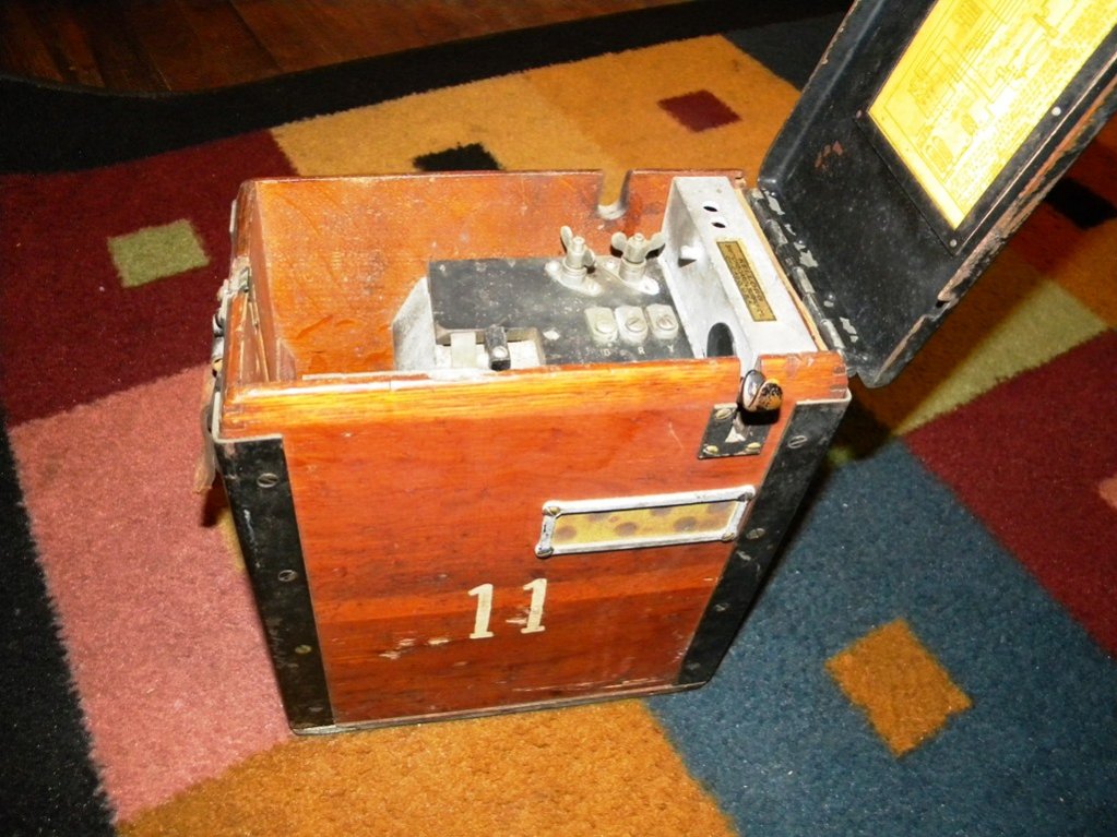

skeeter4206 11-01-2015 09:13 PM

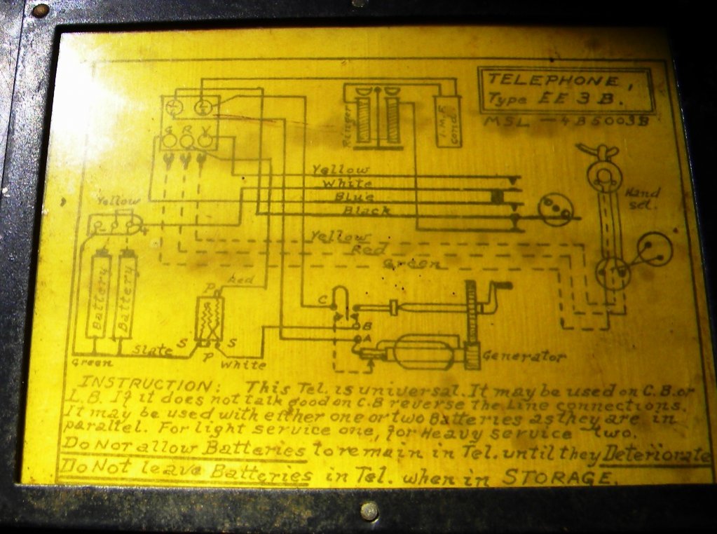

I put a voltage meter on the L1 and L2 terminals and yes it does have some DC voltage when cranked. Curious about the batteries. When cranking, do the batteries store the voltage so you don't have to keep on cranking to talk on the phone? I'm just trying to grasp the whole concept of how this thing actually works.
The (3) terminal poles with Green, yellow and Red labeled beneath them is where the actual hand held phone receiver connects. But what actually connects to the L1 and L2 terminals when in operation? They have wing nuts on them for easy connection and disconnection. So is there something that I'm missing that makes the whole thing work the way its meant to work?
Another dumb question, when I was a kid a remember my pops talking about fishing with old crank style phones where the fish would get shocked and you just scoop them up. Is this the type of contraption that would be used to do that? Not that I would do that by all means. Just old memories of my pops from way back. [I] never really knew what the hell he was talking about. bake then I was thinking how does our kitchen phone be used to catch fish. bake then I thought my dad was just pulling my leg. Now seeing that it can produce a current... That's just wrong in fishing that way and I would guess highly illegal.
DonVoigt 11-01-2015 09:20 PM
The batteries are for talking; the crank is for ringing.

Definitely seems to be a good item to add to my collection of old things. Also glad I got (2) of them. Would love to somehow rig them up together and make them work. Wonder if they make any aftermarket batteries that could work with these. I wonder where I could be some receivers or the hand held part of the phone you talk into
mrerick 11-02-2015 10:28 AM
You can probably find details of hookup at the sites I referenced earlier.
Any battery of the correct voltage and current rating would work. You need to check the specifications of the battery in use. If it's a 1.5v battery or multiple you could use "D" cells. Battery holders are available on Ebay or at electronics goods retailers (used to be Radio Shack).
The handset was probably a carbon microphone and a dynamic earpiece. This will be a bit trickier to obtain.
skeeter4206 11-02-2015 11:07 AM
The batteries are the BA-1 dry 3 volt tungsten. the spots for the batteries are about the same diameter as D size. So using 2 1.5 v batteries in line does this give you the 3v?
DonVoigt 11-02-2015 11:30 AM
Yes, 2x 1.5 v in series = 3v

skeeter4206 11-02-2015 01:17 PM
That's too funny! I'm curious about measuring my voltage out put. and where to put my leads. I see the L1 and L2 terminals on top. Put my meter in DC mode and check between these 2 terminals just to see what is being sent?
mrerick 11-03-2015 10:53 AM
Here's detail of the ringing systems used for telephony:
https://en.wikipedia.org/wiki/Tip_and_ring
In the USA today it's about 50 volts. Field phones used up to 130V AC at about 20 hertz.
That is quite a handful!
