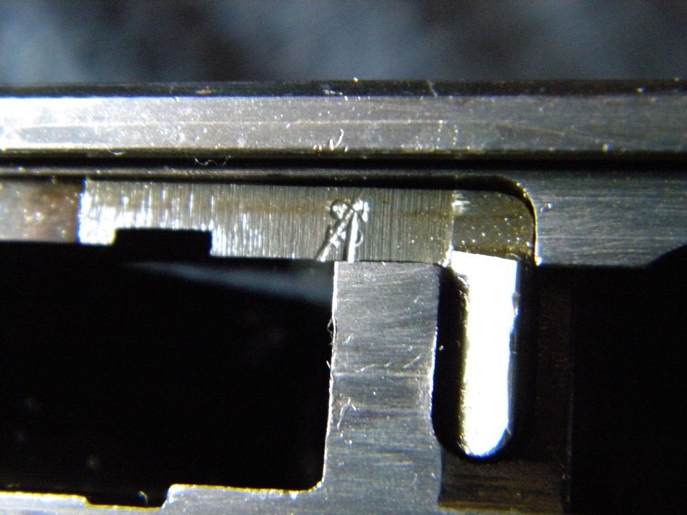

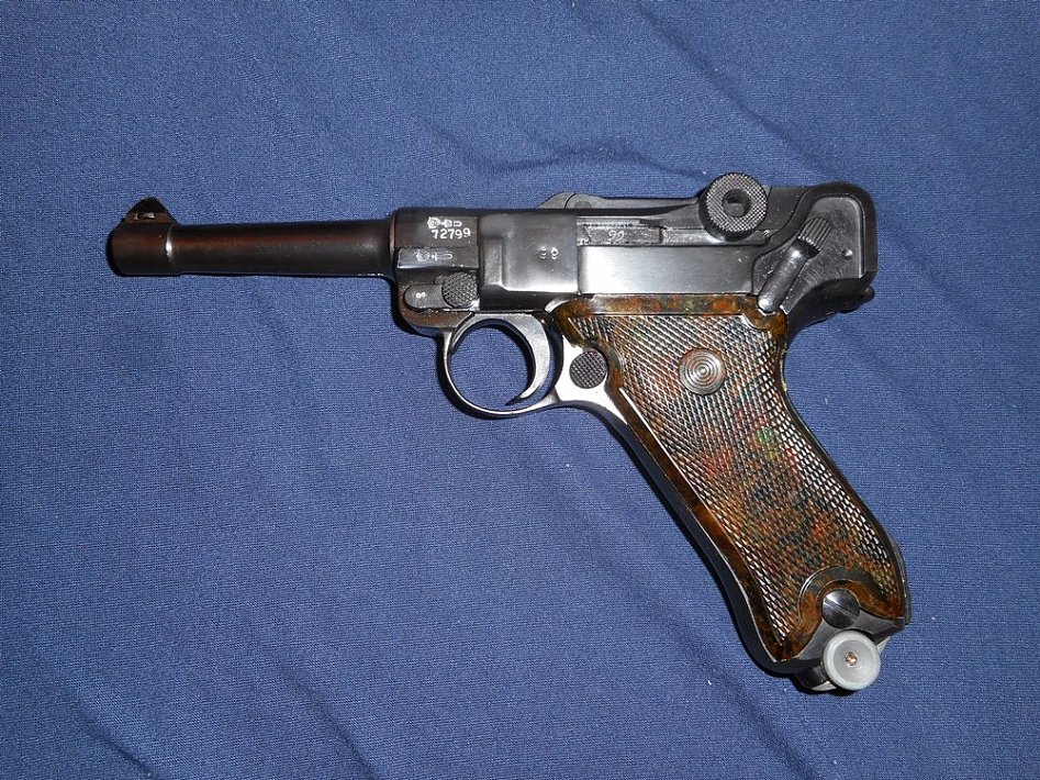

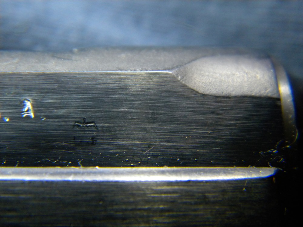

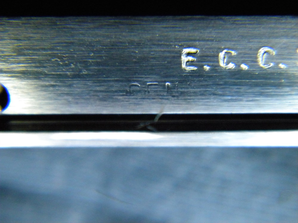

I recently got a D.V.P. luger with the East German eagle surmounting a crown/U on the left frame and receiver. The barrel appears to have been replaced with the crown over N power proof mark with 653 stamped underneath the crown/N which signifies the rebarreling in June of 1953.
After closer inspection of the luger revealed obvious buffing with some areas removing existing markings. On the right side of the receiver appears to be a de/63 stamp which is still half visible. There is something else stamped on the right side underneath the import stamp that I can quite make out.

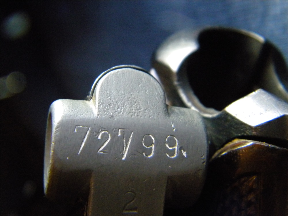

I'm curious about the buffing off of the original markings, if this was something that would have been done when the luger was rebuilt. The magazine that came with this luger is the 2/1001 style which is proper for the D.V.P. rebuilt luger. The aluminum base has obvious buffing that removed the original markings and then stamped with the SN on the frame and receiver.
I wouldn't mind some feed back from those that could help out with what I am seeing.

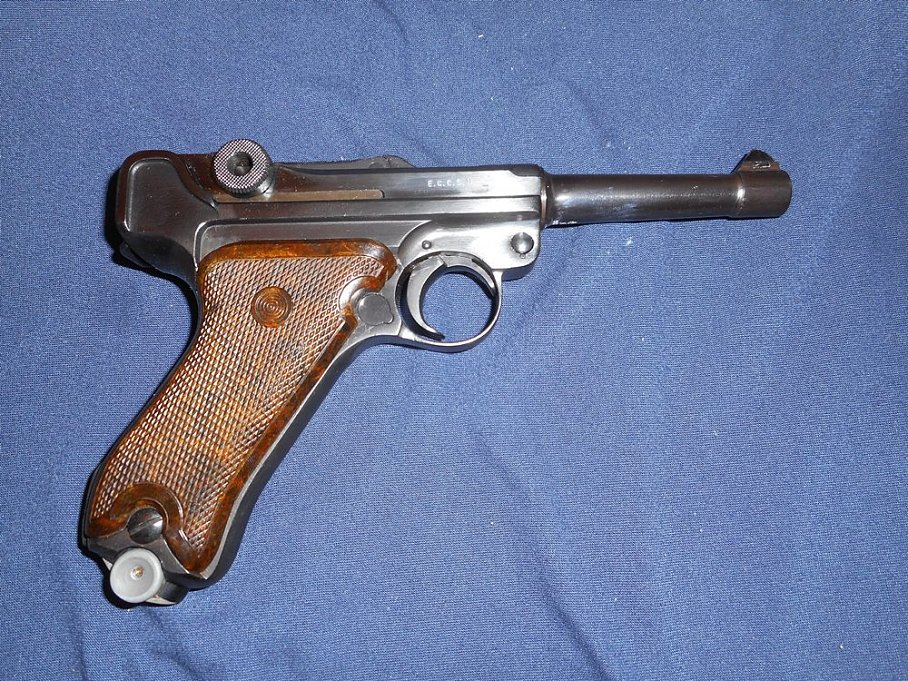

* Hope the attached link(s) help explain the E.C.C.S.A Importer's mark on your Luger.
http://forum.lugerforum.com/showthre...ighlight=ECCSA
* FWIW: I also have run across an AutoMag report indicating E.C.C.S.A. stands for "East Coast Combat Shooter's Assoc." which was owned by the same fellow who owned the Cross Roads Gun Shop in Pensauken.

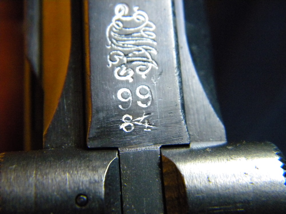

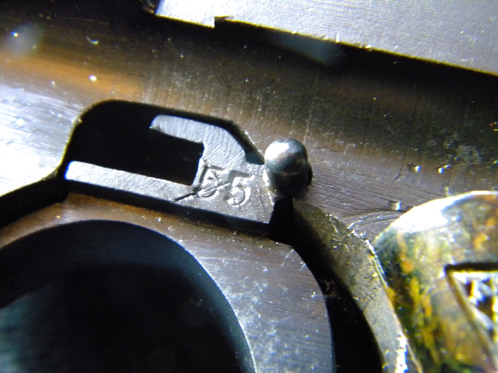

Schupo 10-21-2015 09:34 AM
Glenn,
Buffing out markings is not typical of Deutsche Volkspolizei (DVP) work done at their Suhl armory. Some generalized buffing to remove rust or pits may have occurred prior to a reblue but old marking were either left intact or struck through to cancel them just as had been done prior to 1945. You can see this practice on the struck out "84" & "55" marks in your photograph. It is possible that the exporter or importer may have done a polish and re-blue prior to resale.
The magazine has a new "2/1001" marked new body and an old aluminum base it seems. I would expect the whole magazine to be newly made at the Thalmann works. If the base is old I would find it odd. If it is new it has been re-numbered to this pistol, probably by the importer.
I hope this is helpful.
skeeter4206 10-21-2015 02:41 PM
That is helpful. Looking through the web pictures and other pics I have seen of VOPO lugers, this was a first having the markings removed like this. I figured it would be an interesting topic. I wonder if there was another style import stamp along the whole side of the receiver that was removed as well before they stamped the E.C.C.S.A. on it.

RockinWR 10-25-2015 02:01 AM
Hi Richard,
* The Auto-Mag article appeared in Vol. XX, Issue #5 (8/87), Pg. 94 . It provides little more on the E,C.C.S.A. meaning than what I have posted above. Author did not cite his source(s) for the "East Coast Combat Shooting Assoc." meaning he reported. Hence my caution to take what was reported as "FWIW".
* This series of reports/questions (4/87-8/87) indicate the author personally reviewed hundreds of the P.08's. P.38's, and High Powers which were marked w/ the E.C.C.S.A. Importer's mark. Apparently these pistols were reviewed @ and were distributed by Davidson's (Greensboro, N.C.), Navy Arms, Delaware Shooter's Wholesale and possibly others.
* I have a byf'41, "all matching", excellent condition P.08 with this Importer's stamp on the R/H side flat. EG C/N rebarrel, DDR sunburst/numeral enrayed shield, bullseye VOPO plastic grips, and the sweetest single stage trigger I've ever experienced on a Luger. Qiute a shooter now bordering on a collectable.
