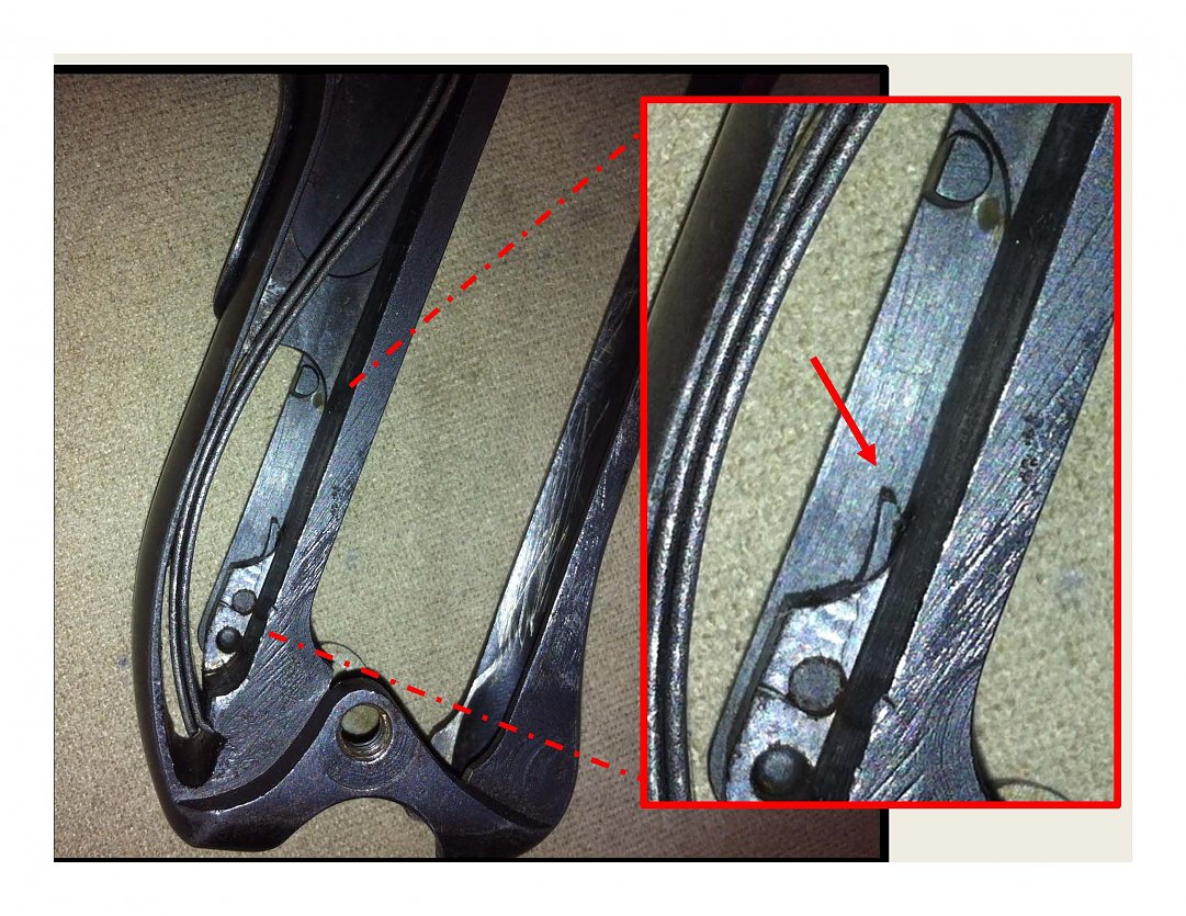

mrerick 06-07-2013 09:41 PM
Grip Safety Spring
1 Attachment(s)
There is a spring that fits at the base of the grip safety bar...

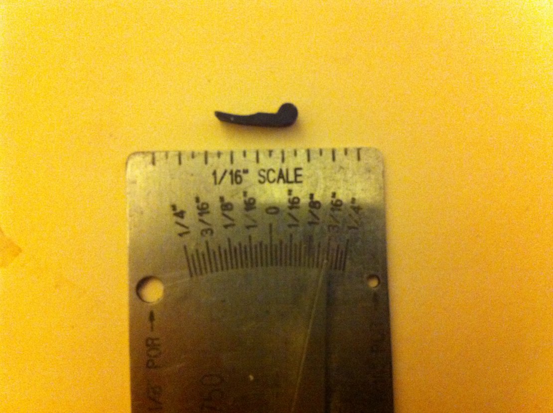

skeeter4206 06-07-2013 10:05 PM
1 Attachment(s)
That makes since now. I see my issue, its a broken spring. It never caught my eye before cause I have never actually taken the grip safety apart.
I do appreciate it mark.
Attachment 34359
skeeter4206 06-07-2013 11:06 PM
1 Attachment(s)
This is what the spring looked like after I did take it out of the frame. I never even knew there was a spring located there. I guess I still got a little to learn about these guns. Any ideas where I might get one of these from?
Attachment 34365
Ron Wood 06-07-2013 11:08 PM
They aren't terribly hard to replace and Tom Heller (Lugerdoc) has them.
