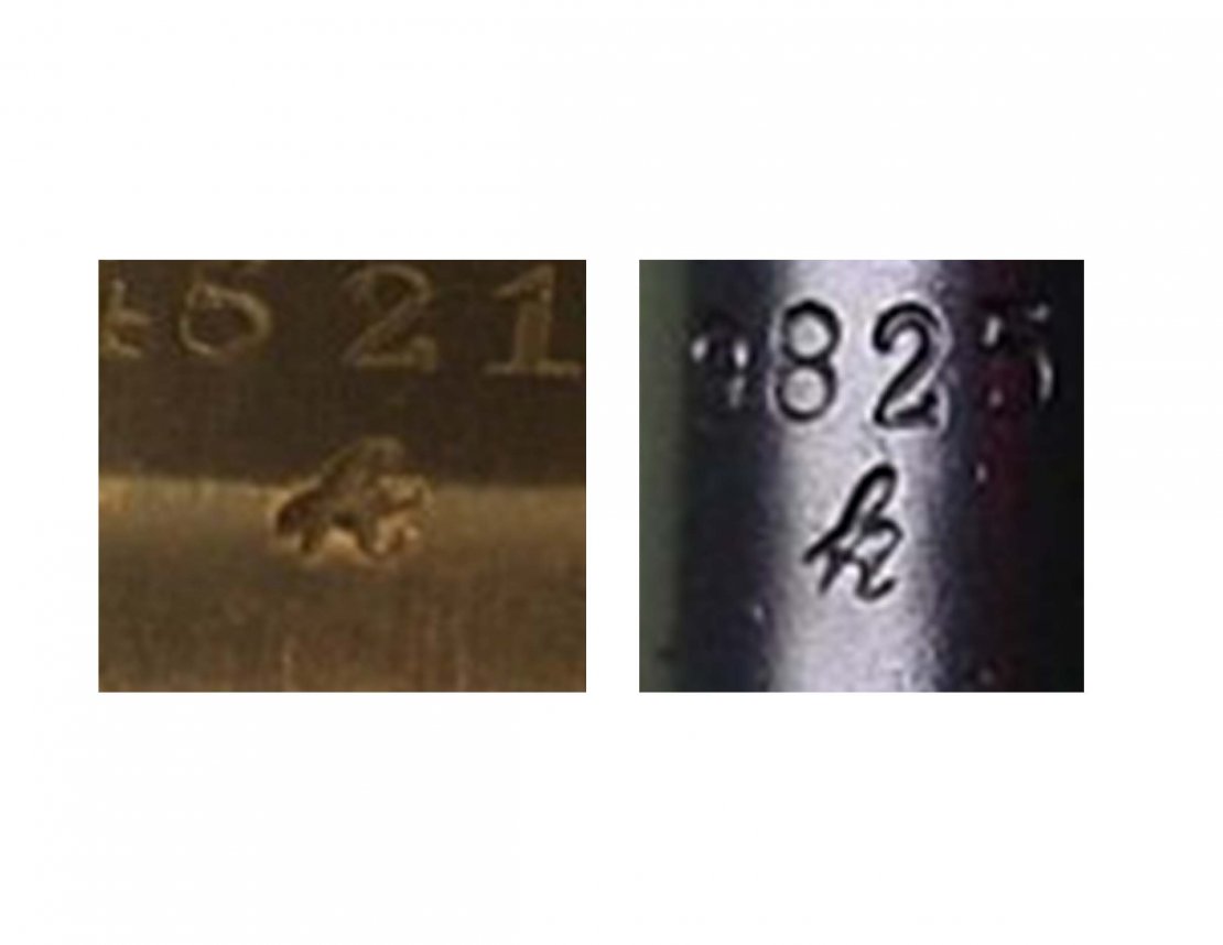

I just picked up, from a fellow forum member, a DWM 9mm, standard P08 configuration with the numbered hold-open and stock lug. What I find interesting is that it is numbered (matching) throughout in the military fashion, however there is no chamber date, no acceptance or proof markings on the left or right side, etc. There is one WW1 style breechblock proof. Serial number is 9825 h. Grip panels are un-numbered but one has an inspector's "S". Some markings I can't make out on the front of the front sight base. Safety and extracter both spelled in German fashion. And there may be a very small dot punched just behind the numbers rear of the barrel base on the left side.
Here are a few photos. Hope someone can explain just where this one fell on the food chain.
Thanks for looking.

Edward Tinker 01-07-2013 11:20 PM
David, is that a 'k'?
If a K then a new made for the military, but why it doesn't have any acceptance or proofs is odd.
If an H, then it is possible it was 'unmiliterized' and sold to the public or the USA after being reworked by a german firm, as lots of that happened during the 1920's...

mrerick 01-09-2013 04:30 PM
"k" Block
1 Attachment(s)
David, My 1917 lP08 is from the "k" block, and it has a die stamp that looks very similar to the one on your undated p.08
the loop on top of the letter, the upturned tail on the right...
But I can see that the center of the right hand loop on your suffix doesn't tough the vertical staff, and there is an additional 45 degree mark going the the right at the center of my letter....
Perhaps yours is something put together by DWM after WW-I from WW-I surplus (and partially proofed) parts. A true "sneak" in 9mm...

skeeter4206 01-10-2013 06:27 PM
1 Attachment(s)
I'm going with a "k"
Attachment 31189

Edward Tinker 01-26-2013 09:35 AM
I asked because an h would HAVE TO BE PRE ww1 while a 'k' could be during or after WW1

el_loco 01-27-2013 10:56 AM
i see a "k".
imho parts were replaced.
reason:
surely i cant compare my collection with yours, but i never saw different stamp-styles at one weapon.
now compare the "2" at the barrel and at the front of the frame, they are different.
also look at the pic, what mrerick postet: even in that angle you can see, that the numbers of the barrel and frame have the same style. and that is original.
