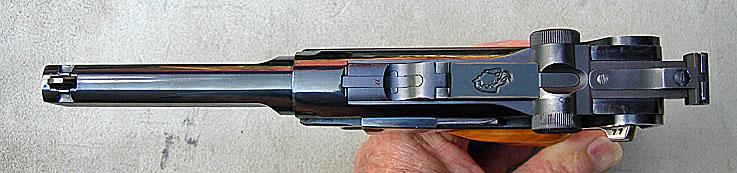

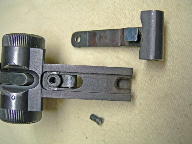

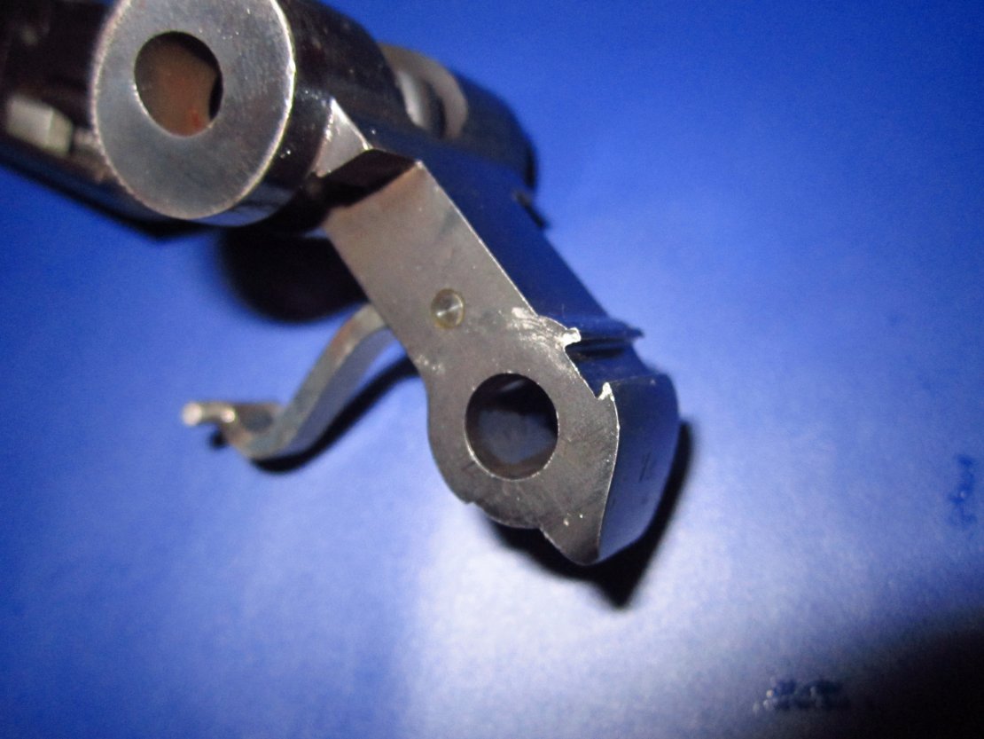

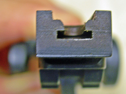

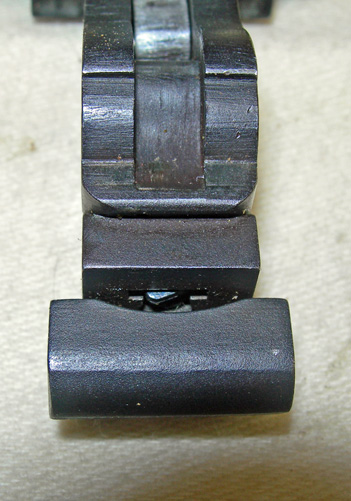

Hugh 09-10-2012 04:55 PM
8 Attachment(s)

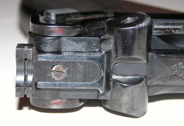

Here is one option:
Hugh 09-10-2012 05:03 PM
4 Attachment(s)
I have an old Gun mag article by Skeeter Skelton telling how to mount one of the old style MMC adjustable sights on a Luger. I also have some of the sights.
Here are some other examples also:

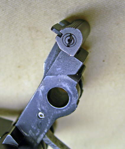

skeeter4206 09-10-2012 07:53 PM

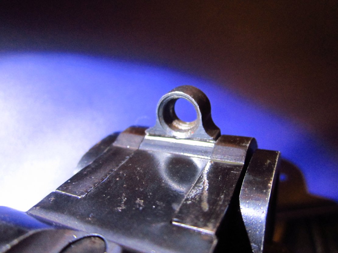

4 Attachment(s)
Well mine aint adjustable, but heres a rear sight that was on my 1900 AE when I acquired it
Attachment 28746
Attachment 28747
Attachment 28748
Attachment 28749
Ron Wood 09-10-2012 08:26 PM
Glenn,
Mounting the peep sight on the rear rounded section of the toggle is the only option for a replacement sight that is not attached to the gun. The rear portion of the receiver rails hold the sight in place. If the sight was placed on the flat portion of the toggle link, I doubt that it would survive more than a couple of rounds before it worked sideways and was destroyed.

Blastattack 09-10-2012 09:51 PM
http://forum.lugerforum.com/attachme...1&d=1347307239
This is spectacular! Exactly what i was looking for! you can even very faintly see the outline of the dovetail in the second picture.
If i were to do something similar, the sight would be certainly pinned in place. A solid 1/16 pin would absolutely prevent the sight from moving inadvertently.
Blastattack 09-10-2012 11:41 PM
So, managed to find some info on the Micro Sight. It appear the sight was originally made for Ruger Flat top revolvers. The base that is on the Luger appears the be a custom manufacture, which would be quite easy to replicate. Bowen Custom Arms appears to make a clone to fit that pistol, and could easily be re-purposed to fit a mount on a Luger. I must say, that is by fat the slickest sight mount i have yet seen on a Luger.
The Bowen model also appears to be an adjustable fixed sight. It uses opposing screws to lock the adjustments in place, as opposed to normal click and spring adjustments.
