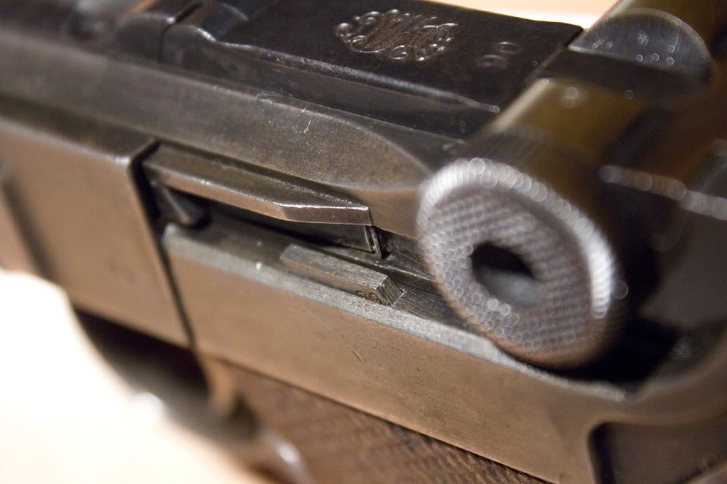

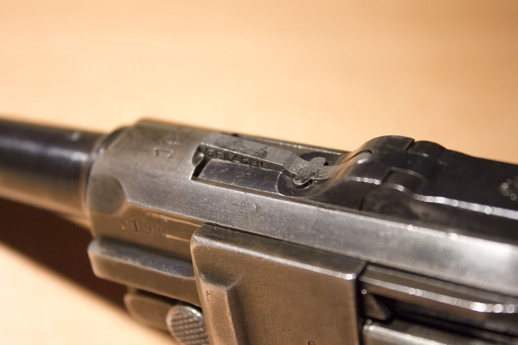

Hi, In the 5th of the photos, it looks like the extractor is not fully seated. Could this be due to damage, or an assembly problem, or the wrong extractor (too long?).
http://forum.lugerforum.com/attachme...1&d=1291581070
Frater 09-20-2011 08:11 PM
Ok, back again, now with fresh photos.
Postino: Yup I live in sweden.
Extractor with loaded chamber.
http://i1207.photobucket.com/albums/...tor_loaded.jpg
Extractor with empty chamber, note slight deformation in breech behind extractor, not sure if this is usual.
The extractor will not move back and forth in the space so probably it has been replaced at some time.
http://i1207.photobucket.com/albums/...ctor_empty.jpg

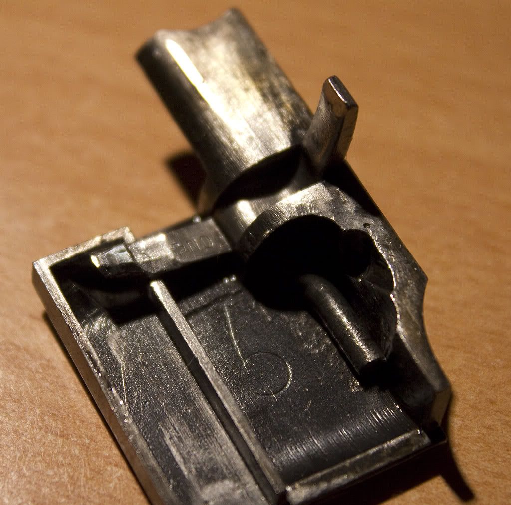

Sideplate inside. What is the swiss cross about?
http://i1207.photobucket.com/albums/.../sideplate.jpg
Sear bar detail, Safety has been slightly engaged to show available space for movement of the sear bar when trigger is depressed while on safe.
http://i1207.photobucket.com/albums/...rKork/sear.jpg

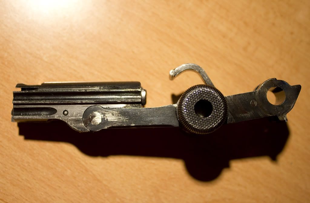

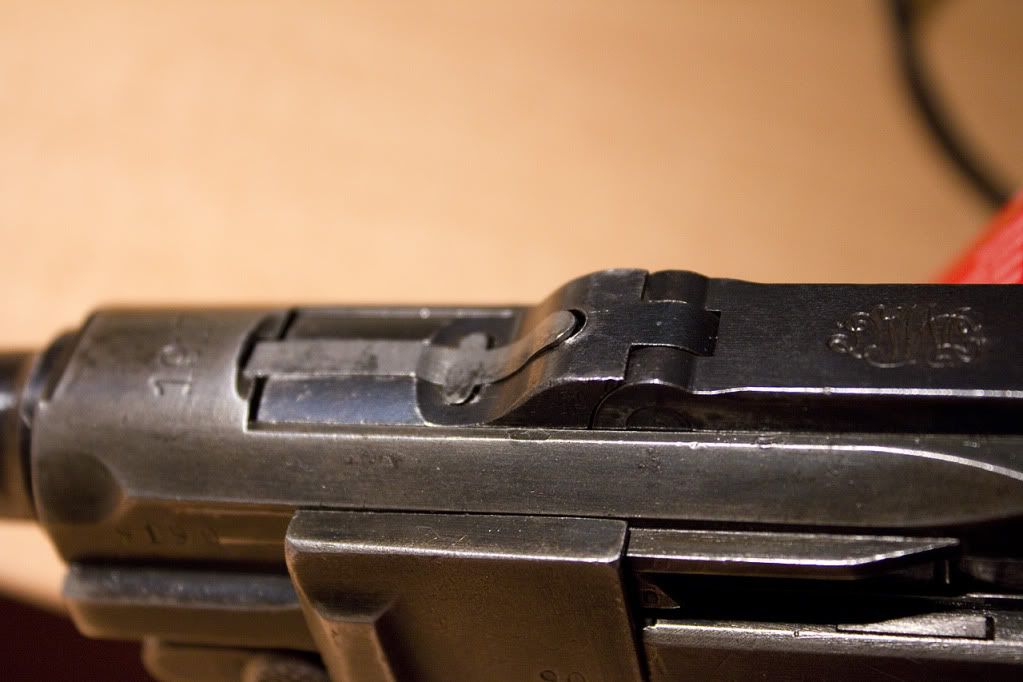

Breech left side. Sight on rear toggle appears to be modified with a higher square cut plate. Good for target shooting, the current front sight is square too.
http://i1207.photobucket.com/albums/...rk/breech1.jpg
Breech right side
http://i1207.photobucket.com/albums/...rk/breech2.jpg

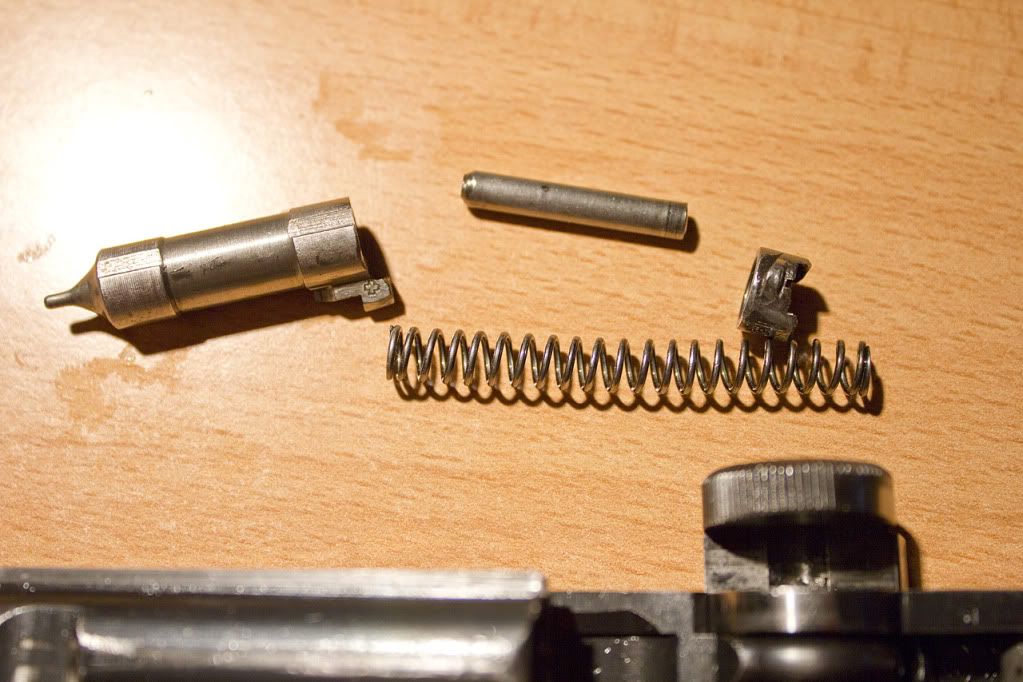

Firing pin with broken spring guide rod, locking lug looks ok though. More swiss pluses...
http://i1207.photobucket.com/albums/.../firingpin.jpg

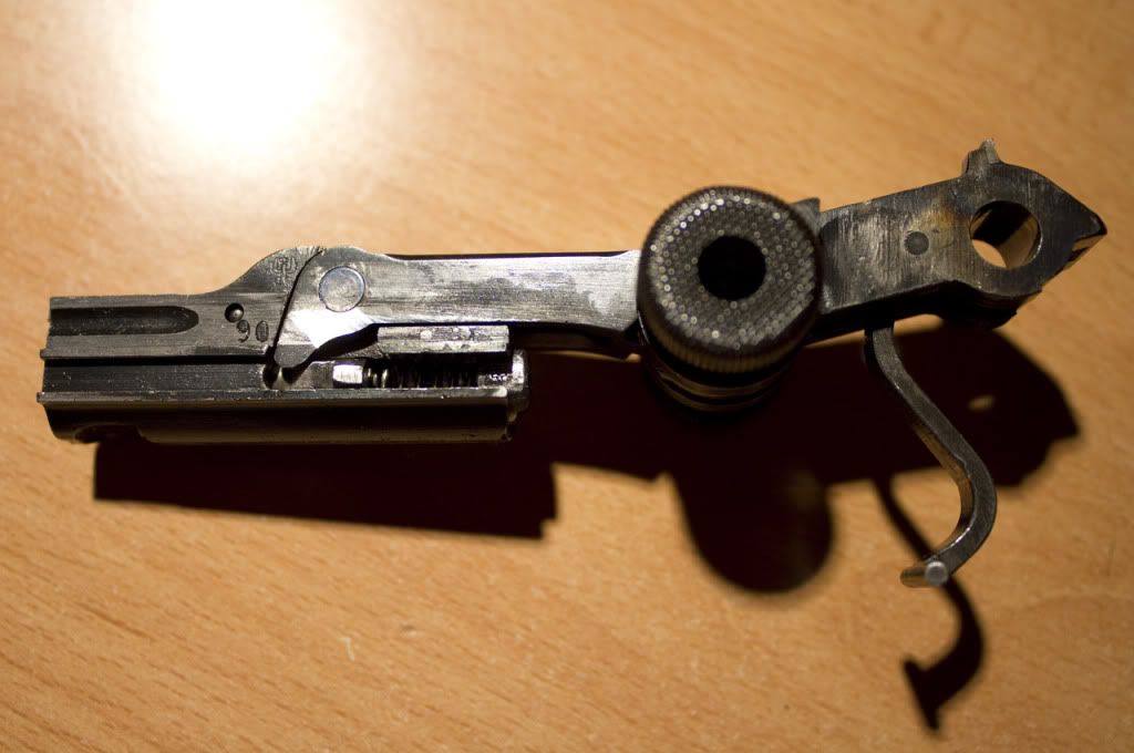

Trigger assembly
http://i1207.photobucket.com/albums/...rk/trigger.jpg

Your trigger looks...modified...The notch for the trigger lever is angled, where mine are all level/horizontal...and the front of the trigger looks to be bent more than mine...The spring looks odd, too...almost like a coil is broken...
The extractor cutout is peened back in two places that I can see...You might be right about the extractor itself being too long...that could cause the peening...
