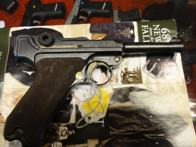

Hi Everyone,
I saw a 1916 DWM at a local gun store today and fell in love playing with it. If there is such a thing as Lugeritis, I've caught it :).
I haven't bought it yet, because I would like your expert opinion whether the asking price of $900 is reasonable.
I've attached a few pictures below.
- All serial number (externally visible) appear to match.
- I did not catch the number (if any) on the magazine.
- It is chambered in 9mm.
- The grip is checkered walnut without border or insignia.
- The marking under the safety lever is "Gesichert".
- I'm unsure on barrel length, but it appears to be around 4".
- The rear sight is a fixed V notch.
- The bore appears "dirty" inside - probably indicating some corrosion.
- There does not appear to be any internal corrosion.
Thank you for your help.
--Rootshot

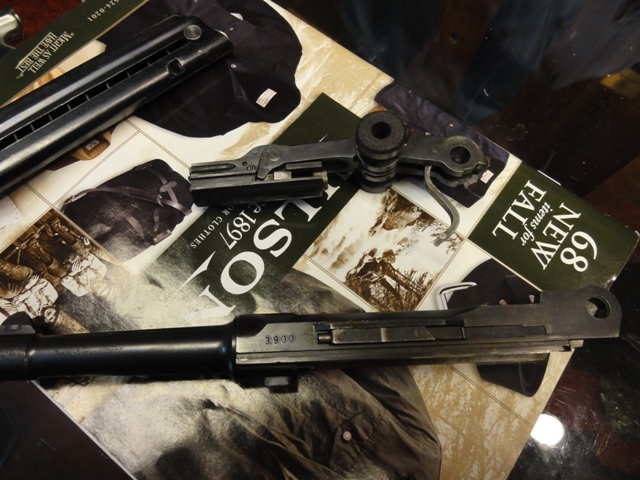

Edward Tinker 08-21-2011 02:40 AM
Your background makes it hard to judge.
A 1916 DWM is not rare, that said the price is reasonable, However, ensure that the interior parts, firing pin, hold-open, grips, etc should have the last two of the serial number to be truly matching.
The magazine appears to be a modern replacement.

MFC 08-21-2011 03:18 AM
The ejector is broken. It isn't a numbered part and is easily replaced.

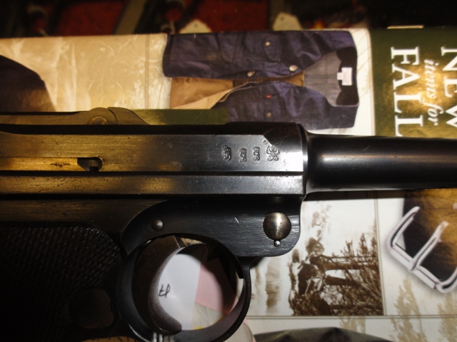

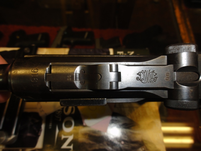

mrerick 08-21-2011 11:53 AM
I can't tell due to soft details in your photos, but the left side of the barrel near the front sight may have either an import marking or corrosion.
In either case, the barrel appears to have a different finish shine and consistency than the rest of the Luger. If corrosion pits are blued, it's been refinished. Check to see that the front of the barrel is still "in the white" (never blued) and that the interior rails are also in the white. If they are blued it's been refinished.
If it's import marked, it's likely a recent Russian Capture import. If the barrel is refinished it is less attractive as a collectible Luger. In either case, the value drops to that of a "shooter" Luger. Perhaps 25% less than a collectible.

sheepherder 08-21-2011 05:42 PM
I've wondered about this...Is the muzzle lacking blue because there was some kind of dowel that was used so that no oily hands touched these parts???
Norme 08-21-2011 05:59 PM
Hi Rich, I believe rubber plugs were inserted in the muzzle and chamber to keep the bluing solution out of the bore. Regards, Norm
sheepherder 08-21-2011 06:23 PM
Norm - Then how was the bluing applied??? If it was swabbed on, it had to be held or supported...If it was dipped, it still had to be held or supported...
BTW: I've used rubber plugs for Parkerizing, and they have a habit of blowing out of a hot barrel (solution is just under 200ºF)...Wood dowels tapered & tapped in work much better... ;)
And I support the parts with thin wire in inconspicuous places...
Norme 08-21-2011 07:09 PM
I don't know Rich, but I've seen muzzle crowns that were blued around the edge, suggesting that the stopper didn't fit too tightly. Regards, Norm

MFC 08-23-2011 03:30 AM
Patrick,
Good idea about the parts change if you plan on shooting it! Many collectors wouldn't shoot an all matching Luger. If a numbered part breaks, it probably becomes a shooter.
The best and easiest thing to do is to buy a complete toggle train for shooting. Short of that, I would put in a spare extractor and firing pin which are both numbered to the gun. Get a later produced Mauser or repro firing pin which is fluted to allow gases to escape. Don't use +P or any hot ammo. The best factory ammo is Winchester 115 gr. white box. available at Wal- Mart.
You should contact 'Lugerdoc' Tom Heller on this forum for the parts you need.
alanint 08-23-2011 09:32 AM
You don't show any photos looking down into the frame.
That "magazine which won't activate the hold-open" may actually be a damaged hold open, which will add cost to the pistol to fix or replace. Are you sure the hold open is actually present? Just curious since there are no images to verify.
Also useful would be a photo of the underside of the barrel where it meets the upper frame. It was mentioned that the barrel looked to be a different finish than the balance of the gun, (which it does in the photos) This is one of the areas where it is easiest to tell a reblue from a photo, as the halos on the stampings are most obvious here.
