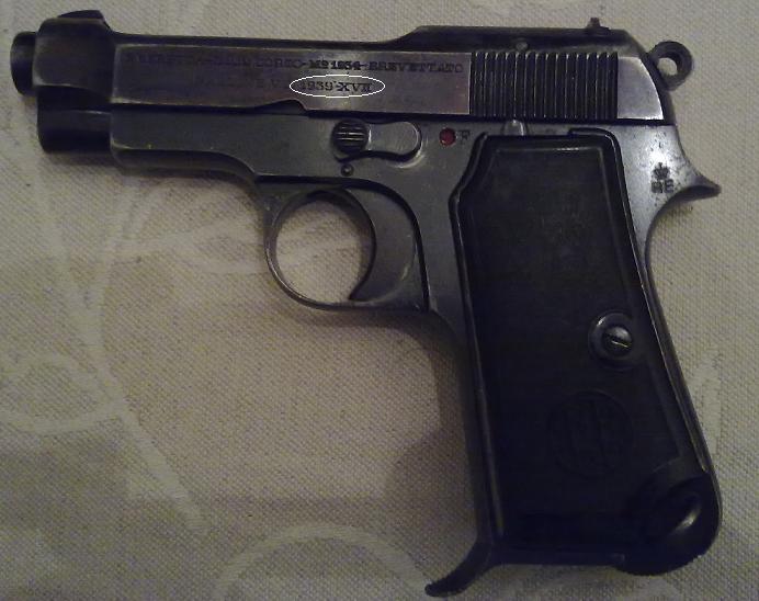

Steinar 10-28-2010 10:46 AM
1 Attachment(s)
Attachment 15442
An interesting thing to notice, is that yours Mr Cartwright (I'm a big fan of Bonanza btw :) ) does not have a Roman numeral behind the production year 1944. This is because this figure indicates the year of Fascism. Above you see a 1939 XVII(17) while Antonios is 1941 XIX(19). If you count back, you seee that it started in 1922.

antonio_liviero 10-28-2010 07:51 PM
The use of roman numerals is referred to the year of the Fascist Era.
It started on 29 october 1922 (the date that Mussolini entered Roma) and stopped on september 1943 (the date that the fascist government ended).
As the fascist year started on october, it is possible to find pistols with different fascist dates, even if with the same civil date. For example, a pistol dated 1941 can have the fascist year IX if manufactured before october and the fascist year XX if manufactured after october.
Regards
Antonio
