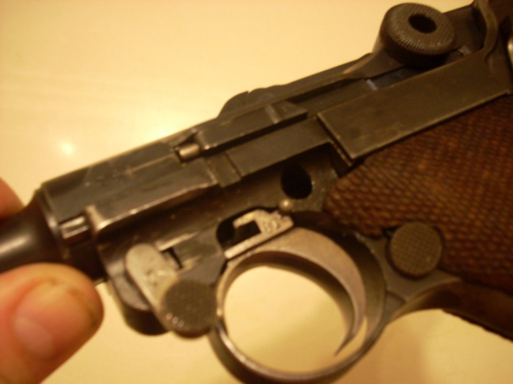

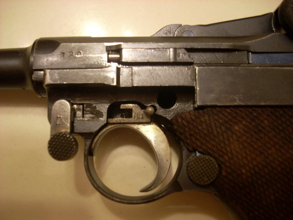

Hi yall. I am just getting in to lugers at 51 years of age.

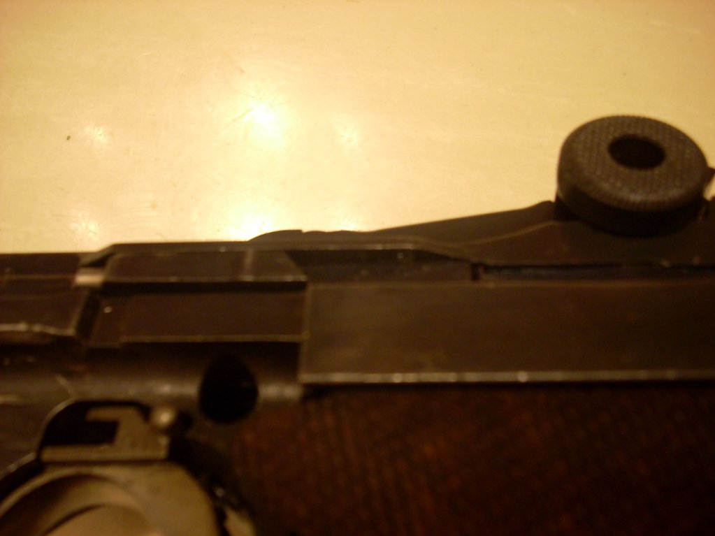

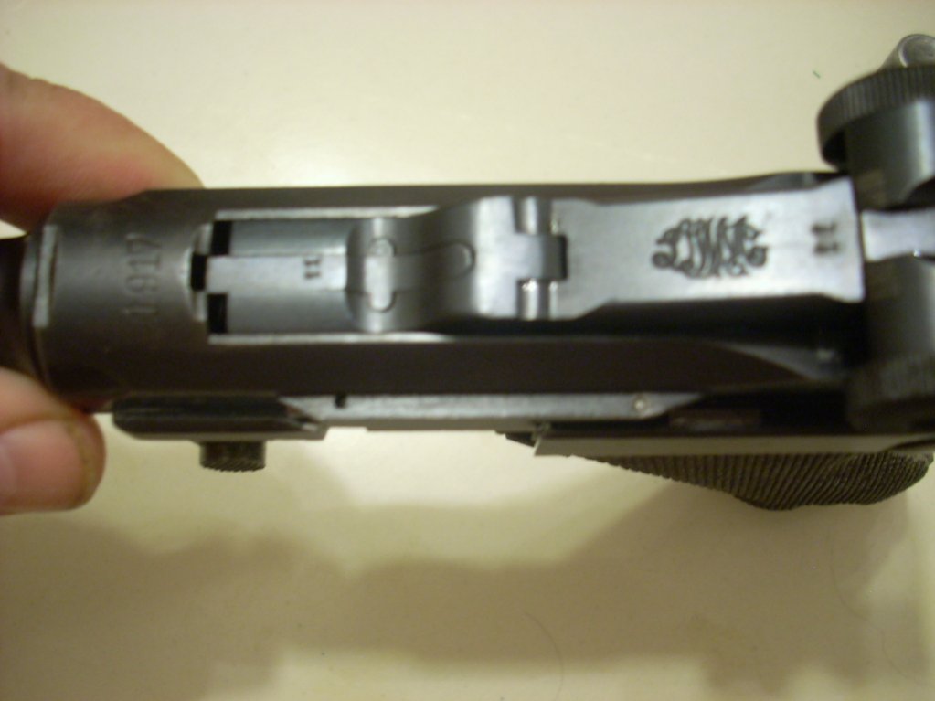

I wanted to see if I got a good deal on my recent purchase at the gun show. I bought a 1917 DWM Simpson rework,
The gun is about 80% bluing little straw left. The gun is made from two guns. The take down lever, side plate, bolt and toggle are from another gun. The rest of the gun is matching #s
The barrel shows early simpson stamps, #4 and eagle over 33 with eagle PTV mark. The frame is drilled with a 6mm hole for the safety but the frame was not cut so the safety was never installed. There is a pin in the hole where the sear safety was.
It has all the imperial etc. proofs on right side

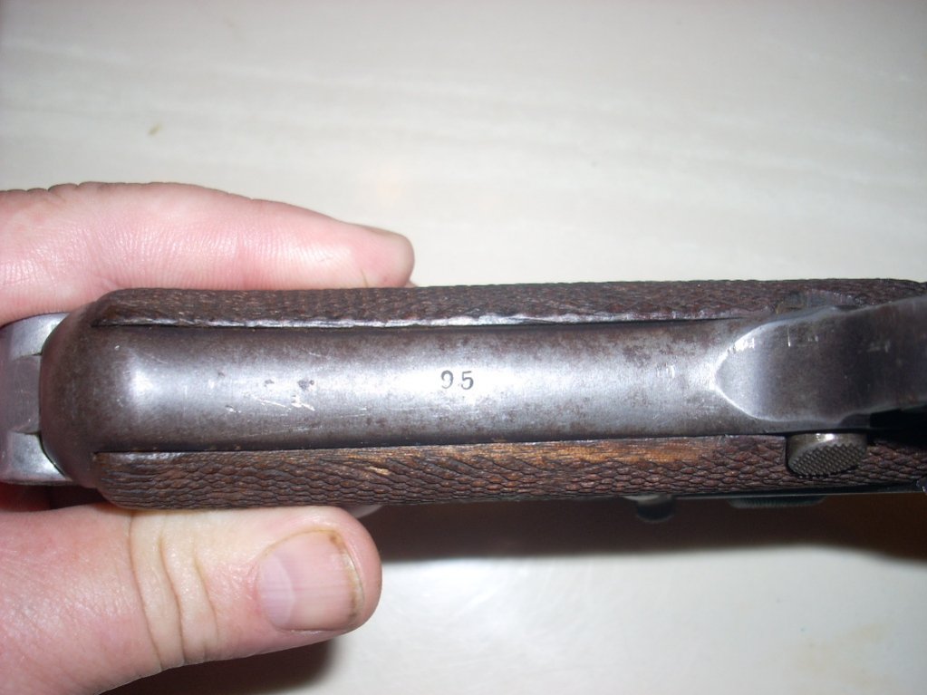

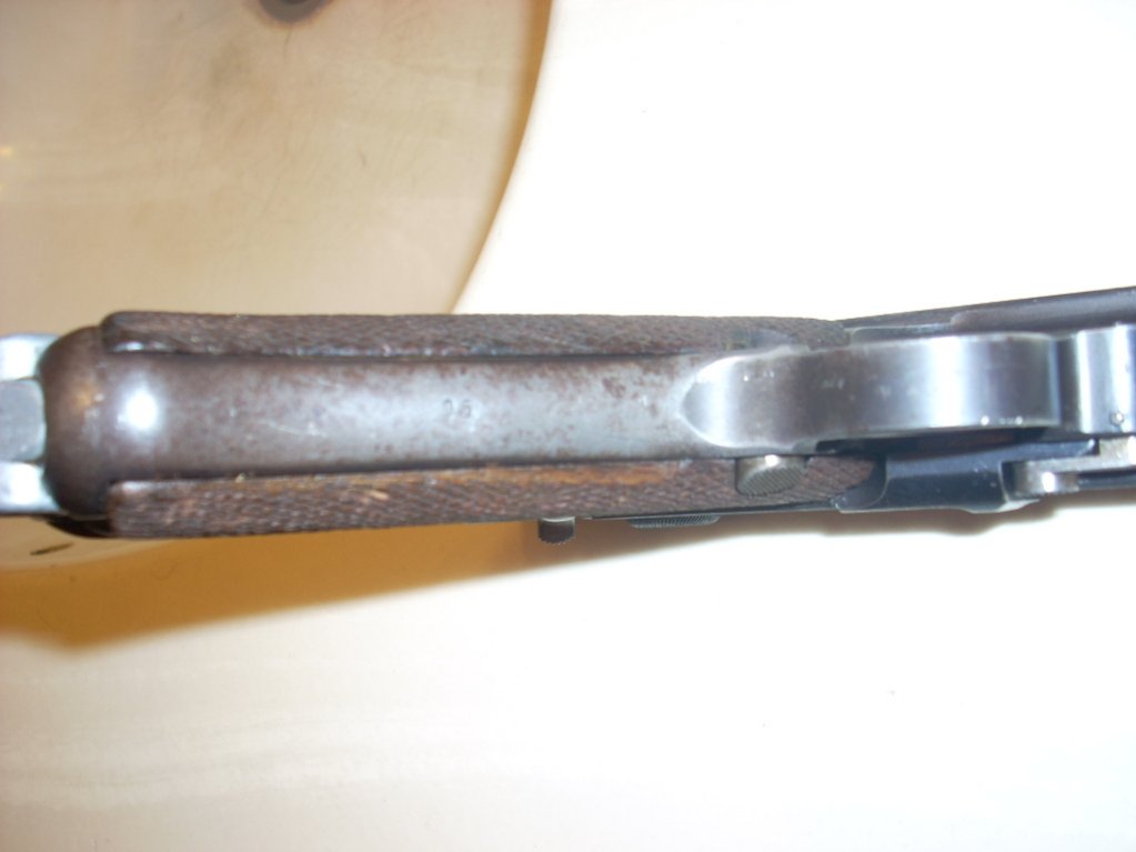

bore is excellent. I bought it from a guy with a 1938 P08 holster for 650 with holster. here are some pics. The only mark I can not identify is a lone 95 on the front grip strap. I need mags for this serial 780 if anyone has any. I have a 6530 mag I can sell or trade.

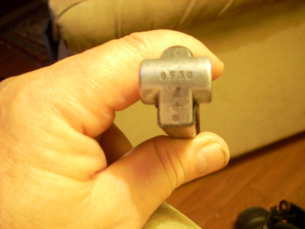

MFC 07-25-2010 07:13 PM
Patrick,

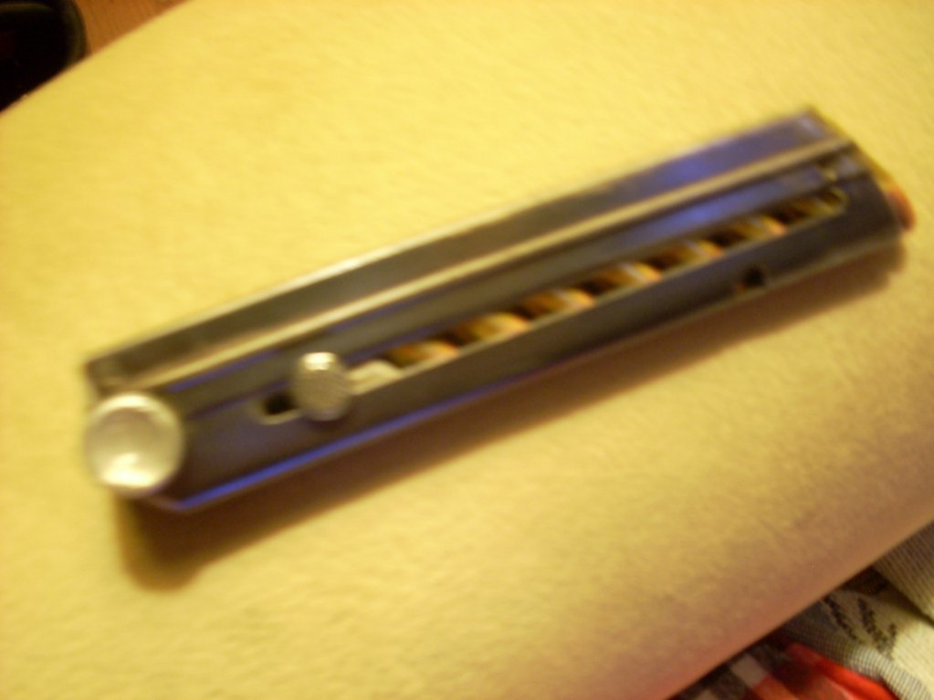

Can you show us a picture of the bottom of the mag? It could be worth $100 - $400+ alone depending on proofs and condition.

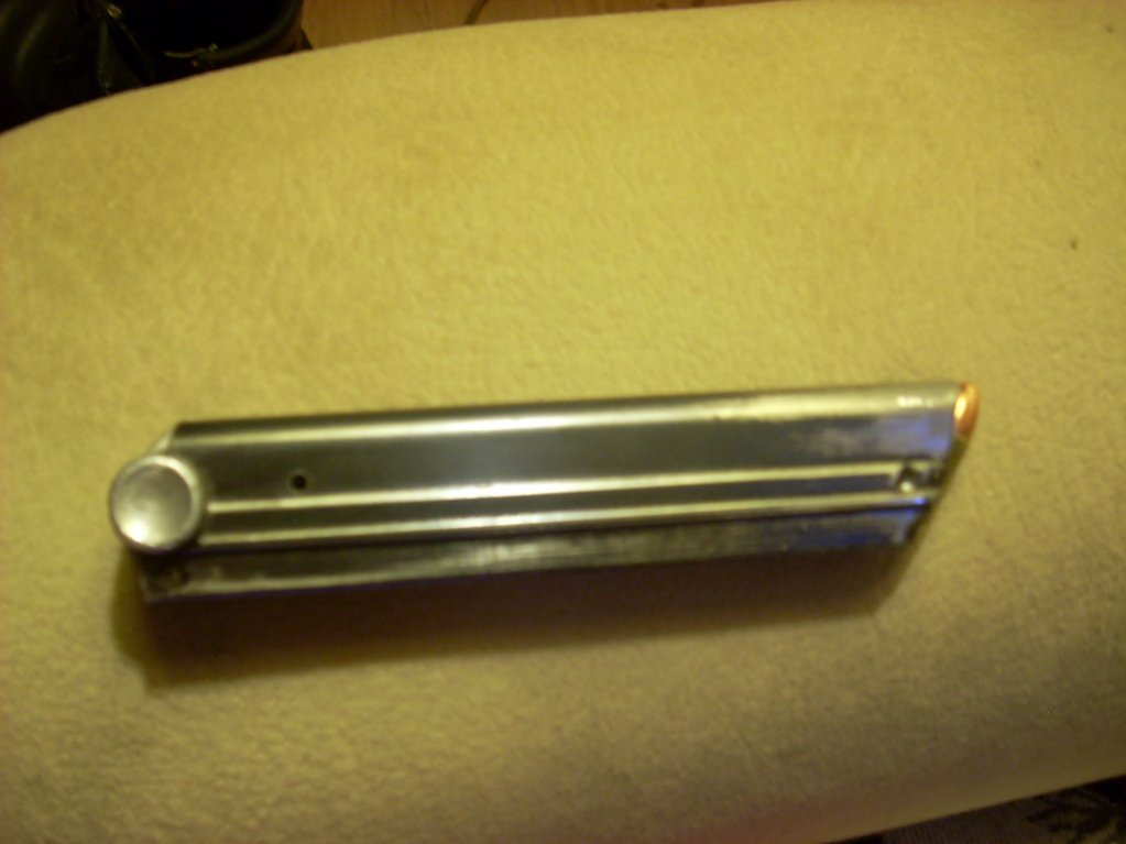

pjm30144airborne 07-25-2010 08:33 PM
3 Attachment(s)
Thanks guys The mag has 6530 L + and small eagle with a 03 or 63 number under but too small to Tell. It is ribbed and aluminum based.
have emailed MCNJ as he has advertised a wood based mag serial number 780 but he is not sure he wants to sell yet he has to find another period mag to replace it with.

MFC 07-25-2010 09:49 PM
Patrick,
Your mag is one of the more common military mags, but still worth around $125.
pjm30144airborne 07-25-2010 09:54 PM
I thought so. I hope MCNJ will sell me the one with my serial number. What can I expect to pay for a wood base mag with a couple of chips ?

The barrel markings indicate this pistol was rebarrelled by the Polizeischule für Technik und Verkehr (PTV) in Berlin using a barrel purchased from Simson. This was probably done in about 1929-30 using an LP08 that previously had been used by the Prussian Landjägerei since 1920. If it has a small */D stamped on the top of the rear toggle link, it is definitely a reworked LP08. The fact that the pistol has no sear safety indicates it probably went from the PTV to a barracked Bereitschaftspolizei unit that was subsequently transferred to the military in 1934-35. I don't know what the 95 on the front grip strap means. Perhaps a good photo of it will help.
pjm30144airborne 07-25-2010 10:54 PM
Thanks.
No doubt it was a LP08 and has the sight relief on top front of the receiver. A picture of the front strap won't help it is just a deep stamped 95 in the middle of the strap nothing else.
Edward Tinker 07-25-2010 11:14 PM
I would need much better pictures to tell if it was a Sipson rework. Especially if it is mismatched; it might have some "parts" that have been made or accepted by Simson, but NOT a rework by them. That term is used anytime a dealer is unsure what they have.
I have never seen a frame drilled on a pre-ww2 luge that was not finished. In fact, a magazine safety would have the frame cut, but the frame would not be? The sideplate would be, but I can't think why the frame would be, but it is 5:15 in the morning here, so...

pjm30144airborne 07-26-2010 08:22 AM
I have actually bought this from a private individual not a dealer.
I have read in my reasearch on the web of several examples of police reworks that had the frame drilled but never had the safety install completed because they were in the process of removing ones all ready installed. I also read in a few pages from a book stating that simson were the only ones approved to rework the pistols after the war. Regardless it has been re barreled with 2 simson eagle over 33stamps and Police tech stamp (PTV) on the barrel with a #4 and 8,81 below that. There is no import stamp. The forward toggle link and rear toggle ling have been replaced as well as the side plate and take down lever all marked with 11 the frame receiver and all other parts are marked 80 for the serial number 780 with kirsif K below serial number. the rear toggle pivot or receiver axle pin is also stamped 80
Don M 07-26-2010 01:55 PM
My apologies. I realize you mentioned at the outset that it once had a sear safety. That suggests that it originally was issued to the Revierpolizei (precinct police). However, it probably subsequently got transferred to the military where the sear safety was removed. While they are not common, I have observed other instances of this and own a Luger that experienced the same thing.

Don M 07-26-2010 04:22 PM
Originally Posted by Edward Tinker (Post 181159)
Don, I am not trying to be difficult, but it is from TWO DIFFERENT GUNS ...
Ed, of course you are! :evilgrin:
The police did not remove sear safeties but I have seen several examples (and own one) of sear safeties that were removed from police Lugers that almost certainly saw later military service. And I'm not talking about VoPo reworks. The fact that the sideplate was replaced along with a few other parts suggests this was done when the sear safety was removed.
That being said, there is very little about this hobby that can be stated with absolute certainty and it is certainly possible that Joe Sixpack could have removed the sear safety and replaced the sideplate, takedown lever, etc. late last year. :rolleyes:

Edward Tinker 07-26-2010 04:50 PM
If there is a mag safety hole, then the rest was probably re-welded and reblued. Many times you can tell, but sometimes you can't.
I'd like to see close up, clear pictures with the sideplate removed.
pjm30144airborne 07-26-2010 09:03 PM
When would this have happened? I have just looked under bright lights from the inside through the back side with the grips off and you can see it was welded up. So it did have a functional mag safety the finish looks original and has patina and you can not tell the weld is there from the outside!! I was wrong and am sorry. Can anyone shed light on the weld and reblue? It must have been done back in the 30's maybe when it went in to WWII?
Could they have taken off the sear safety too at that time? I have read on another forum that VOPO off both safeties off when they reworked a Luger. The grips are period but are stamped 21 (wrong serial number) and they are not broken under the safety (MILLION dollar break)
