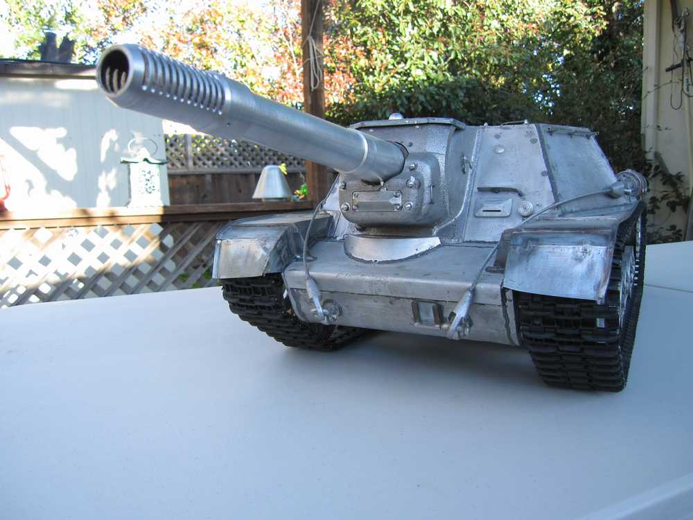

Here's one of many reasons why I don't buy many Broomhandles or Lugers these days:
Attachment 11057
1/10 scale Russian SU-152
Attachment 11058

I must add that I did not build the SU-152; it was built by a fellow in the Ukraine. There were 2 made. There's a video of a local event there and they had fit a .410 blank gun the the example they ran. See it here:
http://www.youtube.com/watch?v=O9L3I...8%3Btopicseen&
(They didn't have the main fighting compartment fastened down and watch it jump!!)
