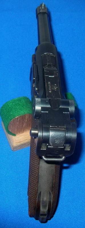

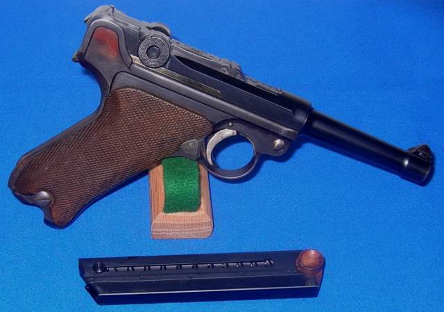

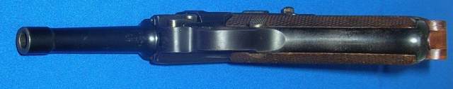

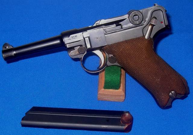

What can you tell me about this Erfurt German Police Rework P08 Luger Pistol,?
Any help or info will be greatly appreciated.

LugerVern 12-27-2009 09:00 PM
No date on chamber?
The left toggle is riding heavy on the ear during recoil, it shouldn't be that shinny. So maybe worn pins.
It is possible you have a mixed parts gun.
What is it your after? Your pictures are not all that close or clear.
Vern
louielouie 12-28-2009 11:34 AM
Vern,
This is a pistol that was for sale and I needed someone (like your self) to take a look for any obvious problems or potential ones.
Thank you very much for your help,
louielouie
Thor 12-28-2009 03:08 PM
What is the red color in the right side frame ear? Lighting or actual bluing color? if the color is on the bluing, it is not right, also the red spot on the left side in the safety detents is not right either. Is the safety marking painted in or blued. If the inside of the mag well in the white steel or blued steel, inside the receiver forks should be in the white if pre 1937 work. Is the sear pin on the sear safety bar, the little rivet that holds the sear safety on, in the white or blued.
George Anderson 12-28-2009 05:46 PM
Looks like an early '08 commercial receiver with BU proofs.
louielouie 12-28-2009 07:12 PM
Thanks for your input.
I ended up passing on the purchase.
louielouie
