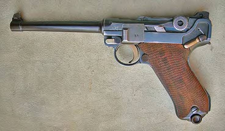

I have a very nice 'built' navy made for me by one of the fine members of this forum a year or so back.Attachment 8757. It looks nice as it is, but seeing it is just a shooter I am thinking on having it reblued. Any ideas? Is it worth sending it off to a 'proper' Luger blue or having a local shop do it? I would prefer the proper meathod, but how much would such a job cost and any recommended restorers to do it?
Many thanks, Bill
lugerholsterrepair 10-03-2009 10:42 PM
Bill, A rust blue for this pistol would likely start at over $6-700 and take 6 months at best and a year or two at worst. If it were mine... I would hesitate to put that kind of money in a shooter that looks as good as this one.
A local shop would not do this pistol any good and might ruin it. My advice is to leave sleeping dogs lie, shoot it as often as you can, buy a nice stock & holster to complete it and get envious eyes cast at you when you take it to the range.
Not many collectors have a shooter Navy!
Jasta2 10-03-2009 10:55 PM
Thanks for the advice. I take I can find a repo stock/ holster on Ebay. Boy, I did not know rust bluing was that much $$$
lugerholsterrepair 10-03-2009 11:17 PM
Bill, $6-700 is on the low end.
You should be able to come accross a Navy stock sooner or later on Ebay. I recommend an Odin. This is more likely to fit onto your pistol without modefying the stock iron. Any of the CMR or Numrich etc. stocks are just to horrible to contemplate.
repro Navy holsters appear often in the $39.00 range.
Take your time..Will be a nice range pistol with it all put together.
