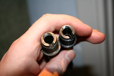

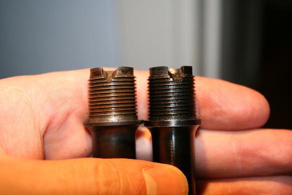

Steinar 02-22-2009 10:38 AM
2 Attachment(s)
Originally Posted by postino (Post 155523)
I have an M40 Lahti and P08 Luger barrel laying here...The thread is indeed 18mm x 20tpi on each... :thumbup:
I'll let you draw your own conclusions on the rest... ;)
That the conclution must be.. it is no Lahti barrel I have been fooling around with :D Thanks for your input!
Here are the pictures I took to compare, what it thought was a lahti barrel is to the right on both picture.
Attachment 4847
Attachment 4848

sheepherder 02-22-2009 10:52 AM
1 Attachment(s)
Hi Steinar! I probably have the Lahti that you carried for two years in military service! :D
The Lahti barrel tenon is ~.160" longer; has a cut on the left for the "accelerator" cam; a notch on the right for the extractor; and the notch on the top is thinner and squarer than the Luger (you can just make this out in the 2nd pic above).
The thread is the same, and I still find this odd...

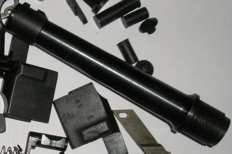

sheepherder 02-22-2009 10:57 AM
1 Attachment(s)
Originally Posted by Morgan Kane (Post 155526)
..not the best picture. The length and muzzle area is what fooled me into believeing it was from a Lahti. :rolleyes:
I have seen several Finnish Lugers on GB lately (almost bought one!) with what were described as "Tikka" barrels on them...(pic attached)...
It would be very easy to shorten a "Tikka" barrel and deepen the chamber and mount it on a Luger receiver... ;)
It's my understanding that "Tikka" made both 4" and 5" Finnish pattern barrels for the Luger...The front sight is distinctive; different dovetail, too...
sheepherder 02-22-2009 11:55 AM
1 Attachment(s)
Here's the cartouche on a Finnish "Tikka" barrel...(This is on a Luger, IIRC)...
Steinar - Is your pic of a "Tikka" 5" barrel???...That would be cool on a Luger!!! :thumbup:

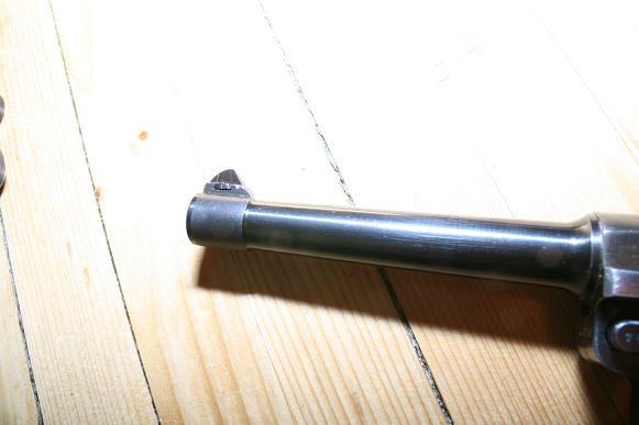

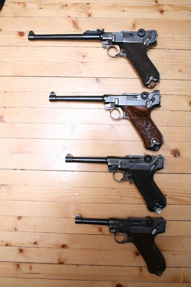

Steinar 02-22-2009 04:22 PM
2 Attachment(s)
Postino, I'm fumbling in the dark about this barrel.. Glad you pointed out that it's not a Lahti.
I'm no expert, but from pictures I don't think it looks like a Tikka eighter..
Here is a picture of the barrel attached to a Luger (second from the bottom). Please share your thoughts what it can be.
Attachment 4859
Attachment 4860
Btw. never had a lahti on my belt, but occasionally a Luger:)
Edit: it looks scratched/rough on that last picture due to the flash, it's actually smooth and is probably unused.
sheepherder 02-22-2009 04:42 PM
Originally Posted by Morgan Kane (Post 155555)
I'm no expert, but from pictures I don't think it looks like a Tikka eighter...
I'm certainly no expert either...But that looks like a Luger front sight, not a Lahti (like in that GB pic of a Luger with Luger/Lahti in post #9 above)...
How long is it???
Steinar 02-23-2009 05:00 AM
Originally Posted by postino (Post 155556)
How long is it???
I will measure it when I get back from work.. From eyesight, it looks approximately 5" long (same as a Tikka barrel).
