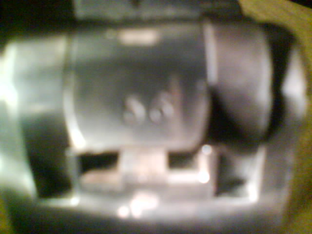

[QUOTE]Take a 10X magnifier and examine the last number of the serials in a bright light, preferably sunlight. You may find that the 5 is actually a 6 or the 6 is actually a 5./QUOTE]
i already did and i and two of my friend and all confirmed the diference in the serial number between the barrel and the frameAttachment 4469 Attachment 4470 you see on the end of the barrel is clearly a 56 and the serial number is 8756 i[ATTACH] [ATTACH]Attachment 4473[/ATTACH]4471[/ATTACH] AND HERE YOU CAN SEE THERE IS 55 AND 8755 i IN THE SERIAL NUMBER OF THE FRAME,AND IN THE TRIGGER TOO! IF I'M RIGHT IT WOULD BE GOOD OR BAD FOR THE VALUE OF THE GUN? |

The finish on your Luger looks pretty shallow in your photos. IF ANY of the parts are different serial numbers, then the gun is Non-matching and that places the gun in the shooter class, and not a collectible. I would estimate it's value between $450-600 in the condition shown. Buy the magazine that Tom is offering. It should serve you well. Enjoy shooting it... Winchester white-box bulk ammo 115 gr. sometimes sold at Walmart, it pretty reliable in these guns. Just make sure you lubricate the working parts. |
