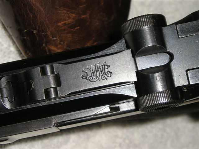

There is some scroll writing on top toggle that appears to be â??DWMâ?

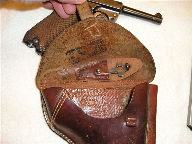

scott1868 11-06-2008 04:34 PM
Photos
1 Attachment(s)
I'm having trouble attaching photos, maybe this works
TooTech 11-07-2008 06:34 PM
Looks nice, but sounds like the rear toggle is non-matching, which would make the gun a "shooter".
Please add LOTS more pictures of the gun and the holster from all angles. Lighting from two angles will help picture quality, do NOT use the camera flash it will wash out necessary detail.

Ron Wood 11-07-2008 07:07 PM
Looks like it is indeed in very nice condition. Additional photos are of course necessary to give a better evaluation of what it is and perhaps a ball park figure on value. Also photos of the holster would be great. Since it is a Reichsrevolver conversion, good photos very likely would entice me to buy it!:)

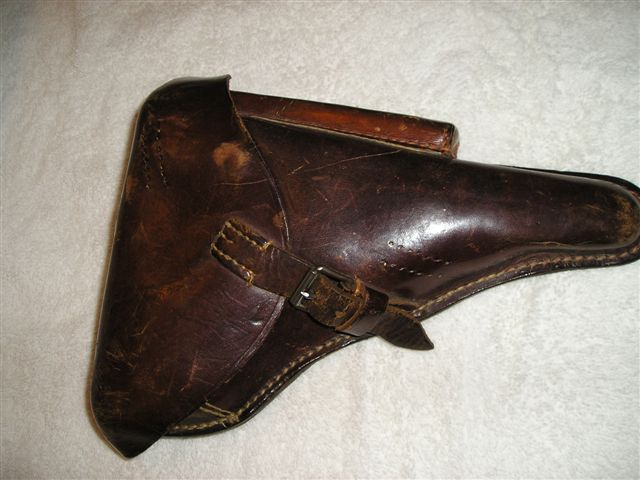

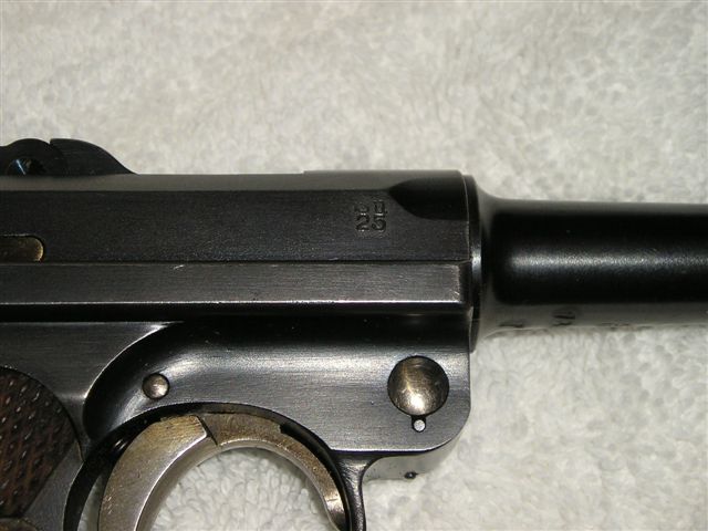

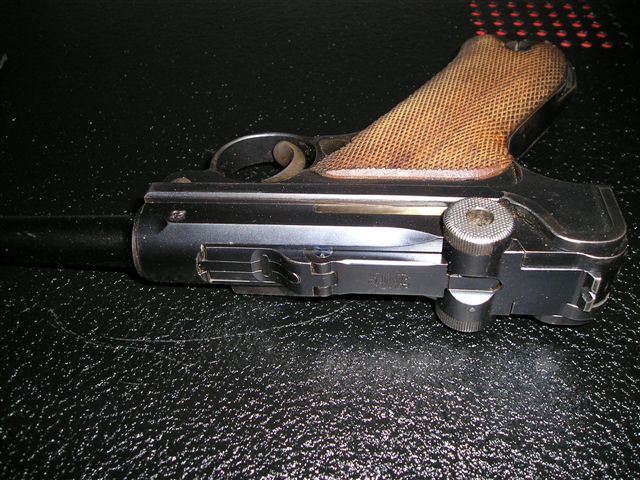

scott1868 11-11-2008 08:25 AM
1 Attachment(s)
Here are some more photos

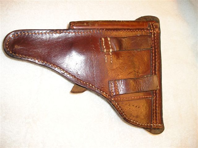

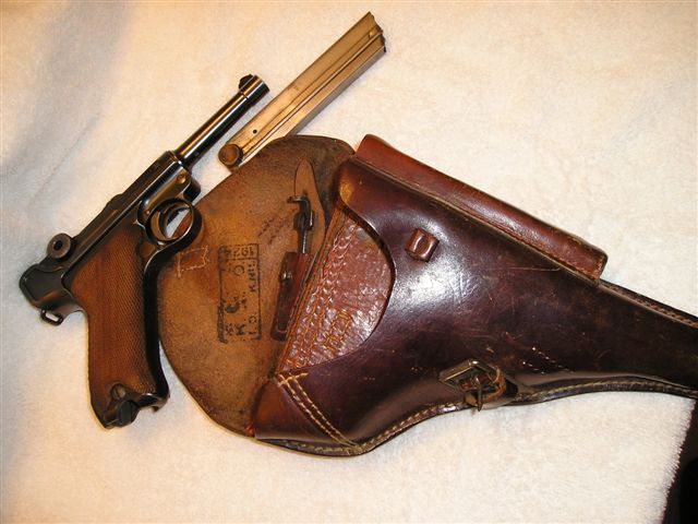

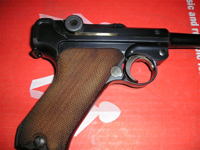

scott1868 11-11-2008 11:52 AM
Can someone tell me how I can attache mulitaple photos?
scott1868 11-11-2008 12:06 PM
I figured it out, here are more photos
http://forum.lugerforum.com/lfupload/p1010221.jpg
http://forum.lugerforum.com/lfupload/p1010218.jpg
http://forum.lugerforum.com/lfupload/p1010217.jpg
http://forum.lugerforum.com/lfupload/p1010216.jpg
http://forum.lugerforum.com/lfupload/p1010214.jpg
http://forum.lugerforum.com/lfupload/p1010213.jpg
http://forum.lugerforum.com/lfupload/p1010211.jpg
http://forum.lugerforum.com/lfupload/p1010199.jpg
http://forum.lugerforum.com/lfupload/p1010193.jpg
Jack Lawman 11-11-2008 05:53 PM
Looks like it was reworked by Heeres Zeugamt (weapons depot) at Spandau (SU25). I found that info here (courtesy Dwight Gruber):
http://forum.lugerforum.com/showthre...threadid=16570
Your luger has many similarities.
The "search" function on this forum will lead you to a goldmine of information.
Jack
