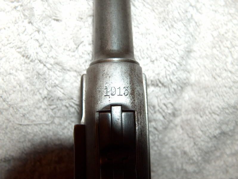

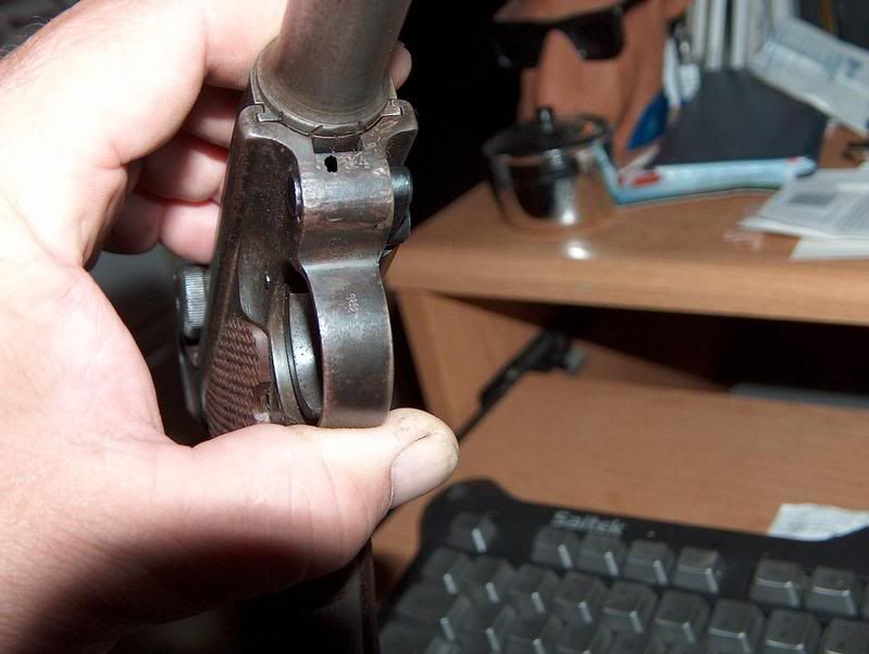

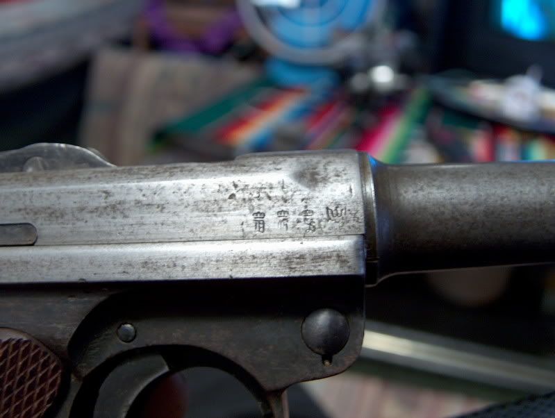

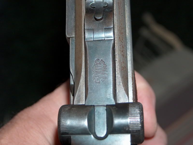

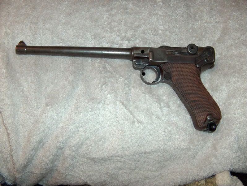

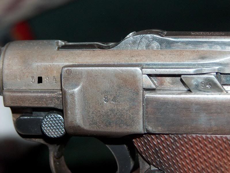

I bought this pistol in the mid 80's and gave it to a gunsmith who just gave it back yesterday!!. I forgot everything about it, can you please help me identify it?. I also need a barrel as the chamber is very worn out. any and all help would be great. Thanks. DK

daskraut
There are no known LP-08 pistols dated 1913. The barrel on your pistol should have the serial number on the bottom, near where it meet the frame. It should be a different number then the one on the frame. The top of the receiver is not cut to accomodate the tangent rear sight, because there is no tangent sight on this pistol.
The barrel appears to be a replacement.
Joe

Interesting barrel witness mark at about the 7 o'clock position.....

OK, not an LP08, I only know it as a luger!. The barrel/upper receiver has the same s/n on it as the rest of the pistol, no replacement , at least for the part that holds the barrel. I saw no serial number on the barrel itself. So what kind of luger/pistol is it?, at least it is a matching number gun.

This appears to be a heavily buffed and rusty 1913 DWM Luger with a long aftermarket barrel. Collector value is zero although it could become a good shooter with a little TLC. I do not understand your need for a new barrel because "the chamber is very worn out." Ordinarily the chamber should never wear out. However, new barrels of standard length or longer are available and easy to have replaced (see Lugerdoc on the forum). KFS

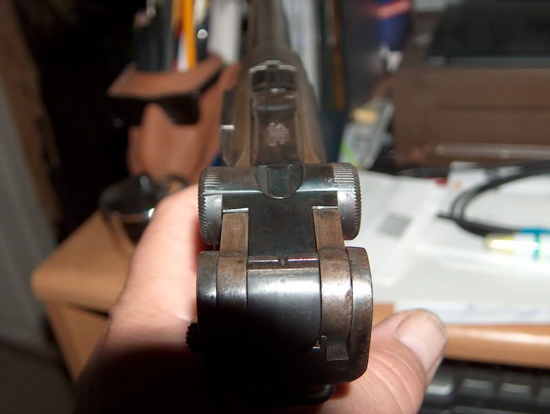

What cut-out do you speak of?, I can see down the sights perfectly.

This is the s/n barrel pic. What witness marks are at 7 oclock that look odd?

Eustace, welcome to the forum. An original artillery barrel would have an artillery sight, yours does not.
It should also have the serial number and a # such as 8,82 on the bottom of the barrel.
A "normal" witness marking would be in the middle, best way to see it is to do a search here on the forum for "witness markings".

This 1913 p08 is only fit for shooting as is or selling as parts. In my opinion no money should be spent on it at all.

Jeez George, a tad harsh!. Kinda like saying " that kid is ugly, forget about collage, just put it to sleep!!". Value be damned, I just like the pistol and will gladly spend a little cash on it. What I said about the chamber is exactly the case, where the brass of the round is when a round is chambered, it is oversize and the brass balloons when fired, so a new barrel is needed. I paid $200 for it some years ago so I think for a matching number gun (minus barrel), it is not too bad.

Sure looks like a barrel witness mark + alignment mark on that 5th picture, but on that last picture it looks more like the signature of bubba's pipe wrench. With a new P08 barrel, it would be a fairly nice Luger for making holes in paper. You may also want to look into replacing the take down lever if it hurt your eyes, personally I would not care.

I think this gun has some potential as a project gun. George is correct that the collector value disappeared many years ago. But for that price you can certainly afford to play with it a bit.
With a fresh barrel and a reblue job, this gun can have a lot of fun shooter years ahead of it.
