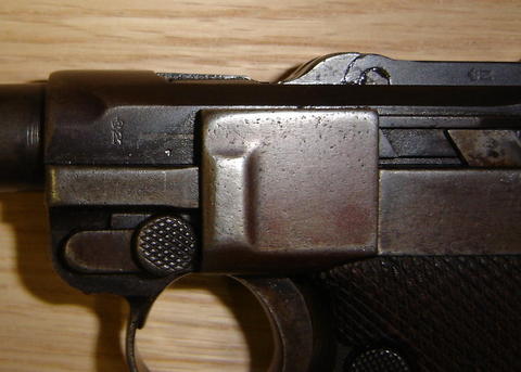

Hello all. I found this site trying to research this pistol, so I figured I'd just ask the experts! My uncle has had this Luger for many years and asked me to help him sell it. From what I can tell, it is an old model P08. The bore is too small for 9mm, so I assume .30 Luger . The only markings are the serial number 844xx (all numbers), and an "N" under crown proof on the side of the receiver and side of the forward toggle link. It has the last 2 digits of the serial number on several parts as well. Barrel measures 6.75". Wood grip and wood bottom on the magazine. Anyone know what the year of manufacture is? Value? Thanks for any input.

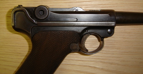

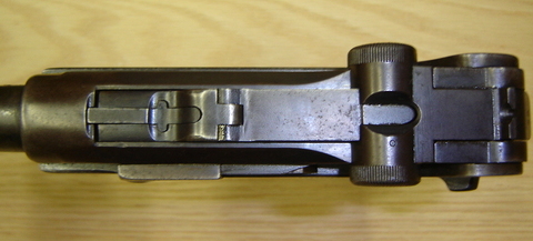

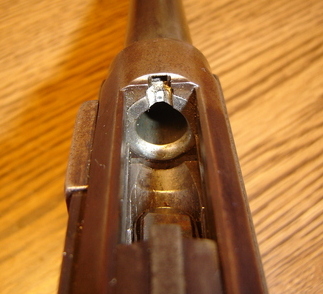

Thanks for all the replies. The safety lever says "GESICHERT". There is no "GERMANY" or any other markings on the top, sides, or barrel. The serial number is 84452. There is a 52 stamped on the trigger plate, rear toggle link, and locking bolt. I dont see any bluing or refinished parts. Heres a couple more pics.

proofs

Thanks very much for the additional information. It is very hard to tell from your photogrphs, are the trigger, takedown lever, magazine relesase, and thumb safety lever blued, or straw-colored?
It does appear that the DWM logo on the toggle has been ground off.
Dwight Gruber 10-28-2007 06:47 PM
Originally posted by tacfoley
The take-down latch shows traces of straw, but it is the side-plate that intrigues me most. I have never seen one quite so rounded on the contours, especially the top left corner, as this one appears to be.
Terry,
Thanks for the photo analysis.
I've actually run into the sideplate situation a number of times. I asked the question of Ted Green (Thor) long ago about sideplates, particularly about the fact that their blue seems to "age" and brown at a much different rate from the rest of the gun. He informed me that sideplates are made from a much milder steel than the rest of the gun, and they "take" blue much differently. From this I have deduced that the sideplate steel itself ages and wears faster and more heavily than the rest of the gun, as well.

Rebarreled commercail Luger.
Another give away on the ground rear toggle flat surface is the elimination of the graceful bevels on either side of the top edges which keep the part from being sharp... if these chamfers are thin or non-existant, the toggle has been ground flat to eliminate the manufacturer's mark.
The barrel looks to me like a portion of a surplus .30 caliber rifle barrel that has been fitted to the Luger and rechambered. The tapers are all wrong, and the front sight base arrangement is not factory... looks like it was slipped over the end of the .30 caliber barrel and soldered into place. A common practice for custom gunsmith Luger barrel replacement.
Your barrel dimension must be only the exposed part. You should measure the barrel by inserting a cleaning rod until it touches the breechface and then measure the cleaning rod that fit inside the barrel. Looks at least 7 inches from the photos and probably eight...
