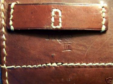

Pete Ebbink 08-29-2007 12:46 PM
What caught my eye is the odd shape of the stock block on the back of this holster...especially the stitching pattern in the middle.
The Imperial/Crown stamp does not seem right, either...IMHO.
http://forum.lugerforum.com/lfupload...ther_copy1.jpg

lugerholsterrepair 08-29-2007 03:16 PM
Pete, The stock block stitching is indeed unusual but I have seen it before on original holsters. This holster looks to be Bavarian stamped as I remember so it could be authentic. I would like to hold it in hand. I could tell for sure then.
The smell test is not conclusive and can be faked. I would say how but that would only lead to fakers to do it.

George Anderson 08-29-2007 04:29 PM
I was the first bidder at $500 later $701. The holster was bought by Scotty and is most likely a hell of a buy. These late war Bavarian holsters were often put into the export market after the war and stamped "GERMANY". I don't know if this one is so marked but it looks 100% to me.
LU1900 08-29-2007 08:24 PM
Dante Di Pietro Jr. 08-31-2007 11:02 AM
I thought I would win it at $1045 but Scott liked it too. What a nice late date Barvarian holster.
